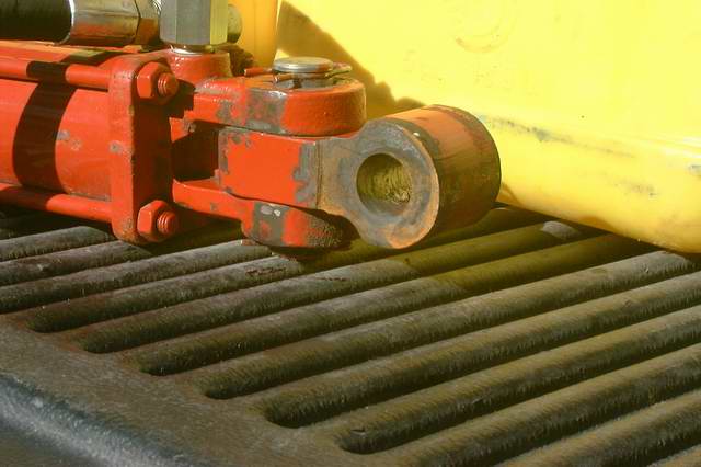

These guys make great top links but designed for larger tractors. I use them. The link come with an extension if needed for larger sizes. May give you and idea for an extension.
Gnuse Mfg. Inc.
   / hydraulic top link too short #12
Here is a photo of the one on my Cat.1 BaileyNet.com toplink. It is similar to the Knuse and could be made in various sizes for different applications.
