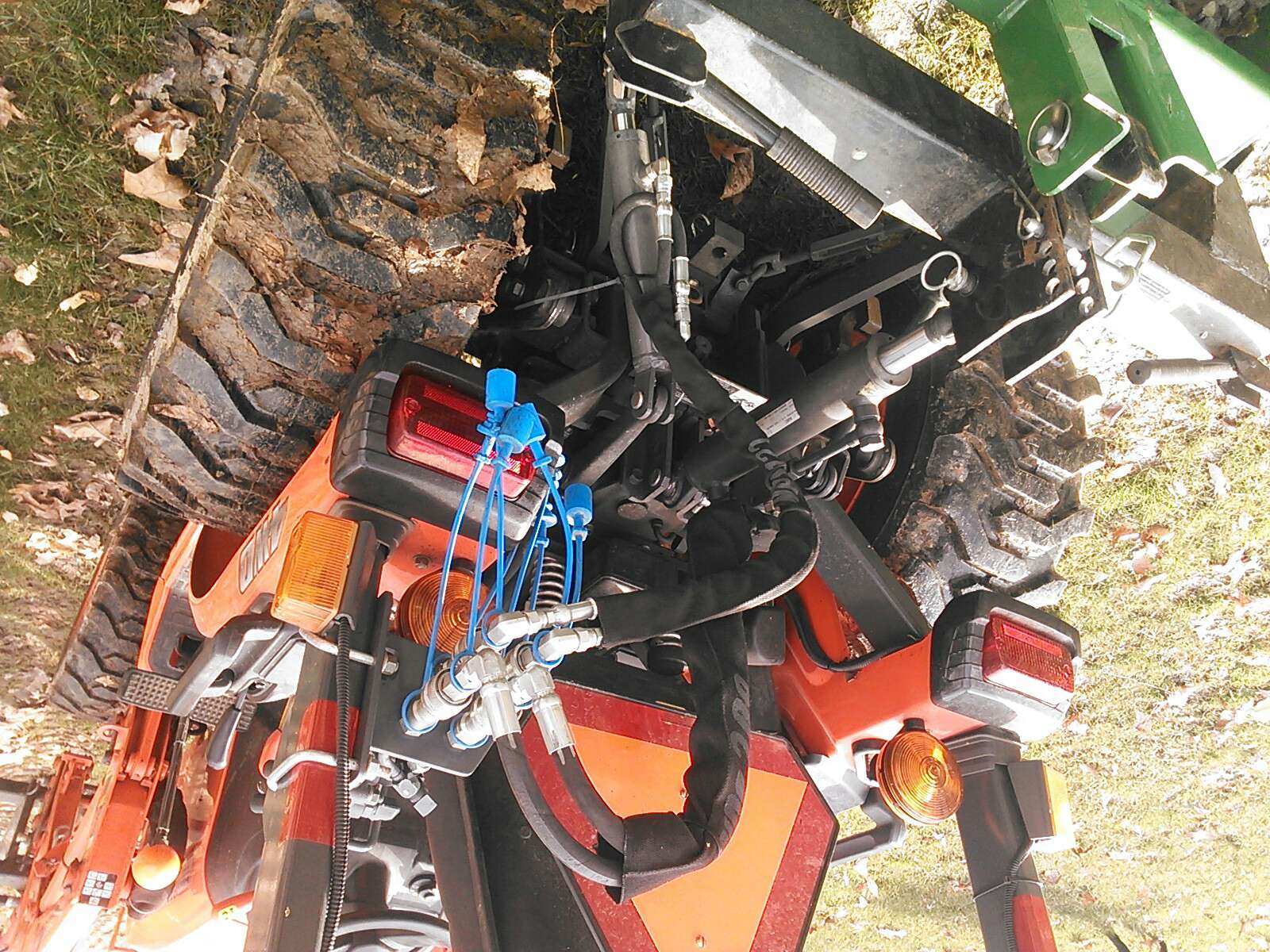

It will if you do a lot of blade work, I love mine and wouldn't be without hyd. side link again.
I do need to add a lock valve as mine does leak down a little quicker then I'd like with a heavy load.
Please explain a lock valve. Leak down is a problem with my HTL.
   / Hydraulic Top link #28
It's just a double pilot operated lock valve that goes between the cylinder and directional valve, it stays in the closed position until a certain pressure is applied to one of the ports on the valve (usually a couple hundred psi, that is the pilot pressure) which allows the valve to open and operate. It's very simple, 2 ports in and 2 ports out.
It's the little square looking block that's barely visible on my top link.
