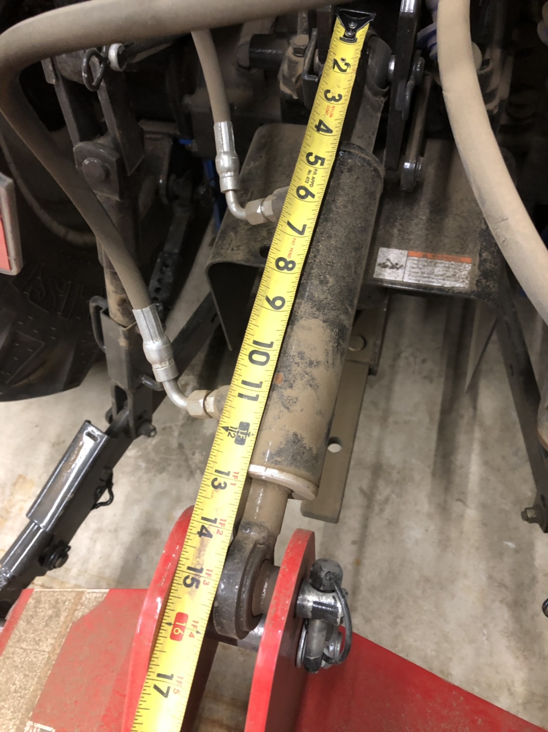

So you don't find that you ever need-want to be out further than 20"?
At this time no I don’t. But I’m only running a box blade right now. It goes far enough out I can really dig with the back cutting edge if I’m not careful.
   / Hydraulic top link #13
I find having a longer stroke is great for a quick tach, allowing you to reach out with the top hook and pull an attachment into position, BUT making it shorter is sometimes also good to get more height when carrying some implements that are practically dragging on the ground otherwise.
#15
After looking and a quick measurement.. I forgot/didn’t think about my quick attachment I’m sure that will add at least 4” for that..
   / Hydraulic top link #16
Smitty i find with Pats quick attach also available at AGRI Supply at $170 the 20 inch to 28 inch cylinder works for me. You might want to go with the 1/4 or no more than 3/8 hoses for the hook up.
Walt
   / Hydraulic top link #17
I am curious as to what each top links working lengths are?
Sorry it has taken me so long to reply; it's just been busy and, therefore, tough to get to switching out the cylinders. But, I had to take the mower off and hook up the disk today so I measured. My longest cylinder looks to be 18 3/4" closed and then about 27" open. The short one for my disk is 14" closed and about 18 1/2" fully extended. My disk is obviously a 3 pt. disk. I use my dump trailer to haul the combo (tractor and disk). The short cylinder was a necessity to get the back end of the disk up high enough to accommodate the ramp angle and load it onto my trailer. Without the short cylinder, the back gang drags.
