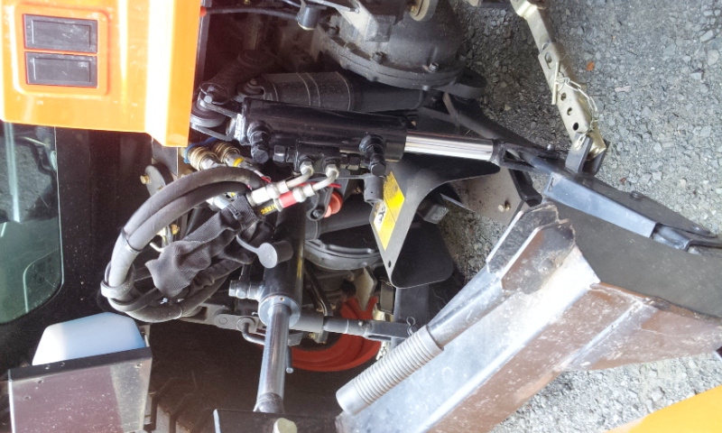

While a hydraulic top-link is totally awesome, experience informs me to avoid a tilting side link. My tilting side link that I purchased from Michigan Iron, a Kioti dealer, broke the yoke right off of the cylinder. At some point, I need to take 7018 rod, grind the old weld off of the cylinder and yoke, V-grove it and weld in several layers to fix it.
The top-n-tilt usefulness was limited due to the three-point wanting to float and because there is no provision in the bottom yoke to pivot as the ram is extended and retracted, this led to a fatigue break at the weld between the ram and the lower yoke. The OEM weld itself at the yoke and cylinder did not penetrate well (maybe only an 1/8 inch) and was a single pass.
Eric, ouch, that's surprising about your MIE side link. I've had a hydraulic side link from MIE for almost 6 years on my NX4510HST cab, and so far so good. My cat 1 3pt setup is slightly different than the dual cat 1/cat 2 on your NX6010HST cab, so there may be something about that difference that affects the distribution of forces. :confused: Below is a pic of my MIE side link, extended for full right tilt. On mine, perhaps there is enough play in the fit of the clevis/yoke ends on the upper lift and lower link arms to deal with changing stress as the 3pt floats.

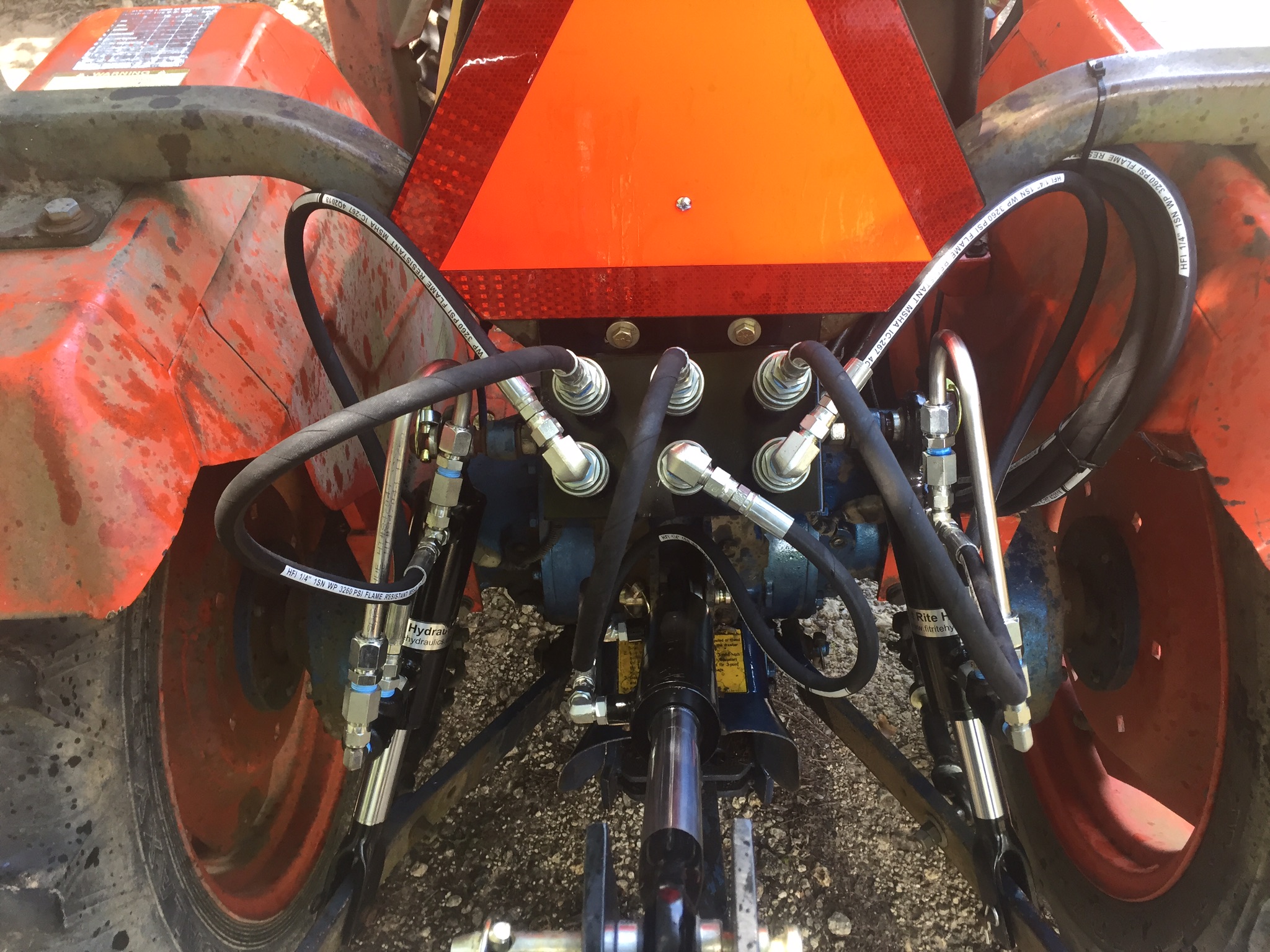

I'm currently at about a 20 week lead time. I typically provide a 2 1/2" dia cylinder with a 1 1/2" dia rod with a working length of 23 1/4"- 35 1/4" similar to the top link of the T&T set pictured.
If you can find something close to that, you should be good to go. If not, contact me to get in line.
Good luck. ;)
Thanks for the great advice you give freely on TBN. I have done fair bit of searching and have only been able to find 10 inch stroke cylinders.
