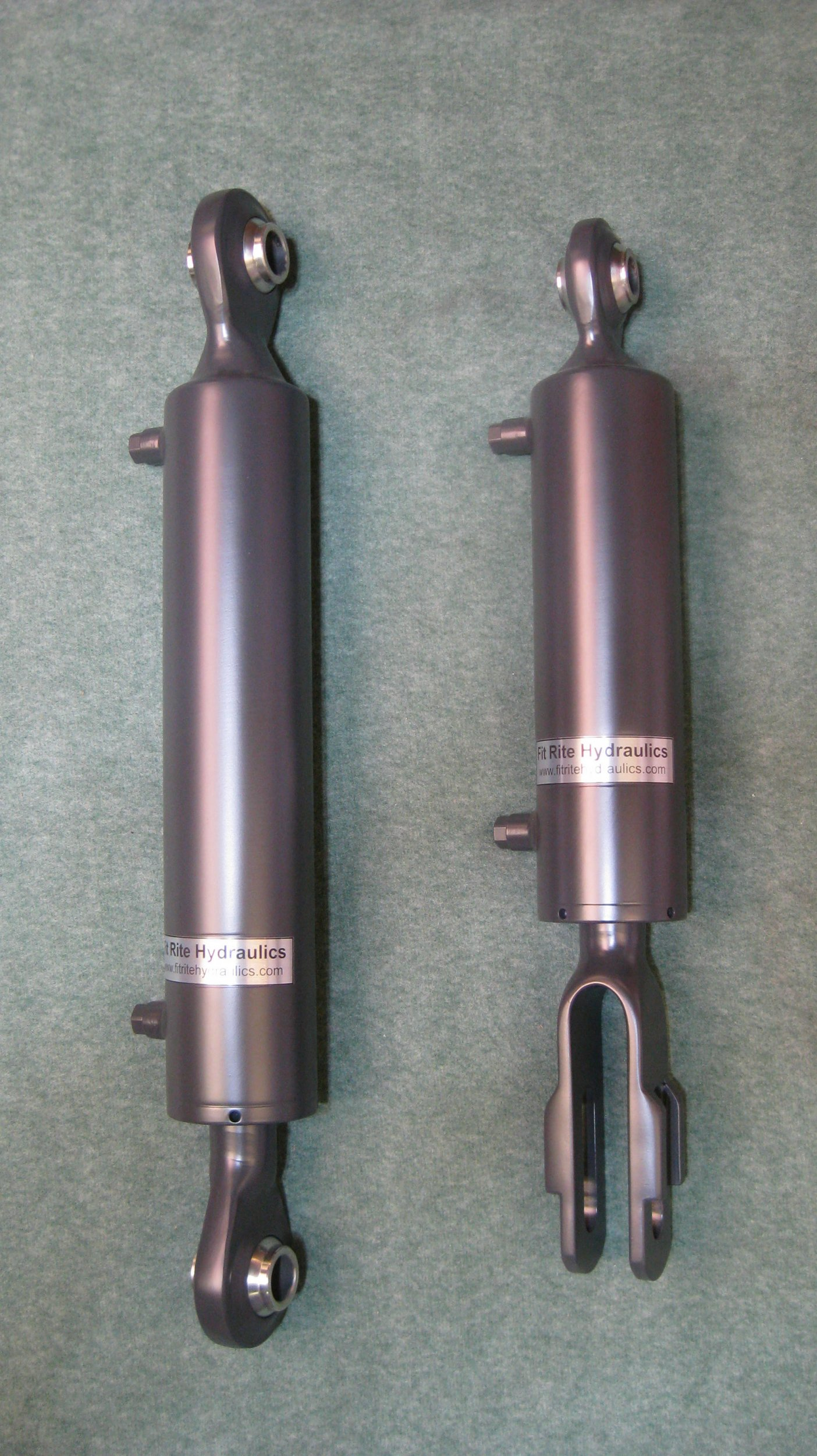

Thanks everyone for chiming in, this is just yet another thing I have zero experience in and I'm trying to cram likely years of knowledge and understanding into a short period of time. Pardon me if I am asking newbie questions, I feel like the manufacturer doesn't provide easily accessible information regarding the 3pt and attachments.
I guess I'm not sure if I want to float or not. I am thinking I dont. I plan on using a snowblower, box blade, and I recently ordered a CP572 brush cutter. I think all of these I want to be able to hold it so it doesn't ride up when they meet resistance. But if I remove the ability to float on the 3 point, what am I giving up? maybe using a bush hog would be a little more rough as it wouldn't follow the ground as well?
How did you determine that this was the appropriate one? I am new so maybe I'm missing something but when searching for information on my tractors top link I couldn't find specifics for length etc. The most I found was in the MF4700 product book it stated the tractor was cat 2 with fixed ball ends. I feel like I must not be using the right search terms because this seems like it should be easier to find measurements for the top link. Either way I appreciate the help, depending on if I need float or not I'll likely order this just to have something ready to rock when the tractor comes in.
Is anyone able to comment on the difference between the one mtnview suggested, Fitrite, and Haytools? It seems like fitrite is just one guy? Is he the equivalent to someone custom building violins vs just buying one at guitar center?
I am Fit Rite. I custom build every order that is placed. I have supplied several top links for the 4700 series tractors. I supply a 3" dia cylinder with a 1 1/2" dia rod typically without the check valve for this series of tractors. It has a working length of
23 1/4"- 35 1/4". You will not find this working length any where else. I assume that you do not want to wait the minimum of 36 weeks to get one of my units, thus I provided what I feel would be the best available off the shelf unit. If you decide that you want to be able to use the float feature of your tractor, simply do not use the check valve that comes with the recommended off the shelf top link.
Here is a link that describes how to determine what length to get for any 3pt hitch application.
You do not have your tractor, so pretty much useless for you to use to get a top link and have it ready to go.
You have the information available, use it as you see fit.

Yep, one guy named MtnViewRanch
Well I feel a bit sheepish.
I am Fit Rite.
It's nice to actually interact with someone that makes the equipment I am interested in. You're right, I don't want to wait so I'll probably end up getting the one you recommended, and submitting an order for one of yours. I feel like I ran into someone famous hah.
Any chance you can expand on when I would want float vs not? You say most people get your top link with float. Again I plan on primary snowblowing and brush cutting with my 3 point.
   / Hydraulic Top Link? #23
Probably the #1 use for float that I can think of with a top link is for a brush hog. Even though most rough cut mowers have some articulation built into the implement itself, depending on the circumstances that you have, that built in amount of articulation may not be enough. So having a top link adding additional capabilities is often nice to have.
My recommendation would be to get the off the shelf unit that I recommended as well as the hose kit that goes along with it.
Use it as is. Only remove the check valve if that becomes a hindrance.
Good luck

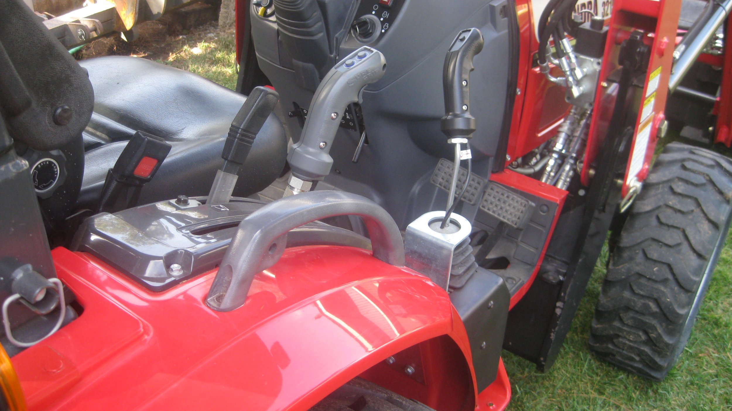

Here is a triple diverter. This tractor has a single factory rear remote. (Only 1 rear remote is available from the factory)
4 sets were needed to control all the different hydraulic functions,T&T and offset & angle on rear blade & rake.
If a person goes with a control grip with all the controls in a single point, it is actually more convenient than having 4 separate levers to operate. All 4 functions can be operated and never removing your hand from the main control lever. :cool:
There are some companies that only offer the separate rocker switches to control the different valves, but even that can be a good alternative. (y)
