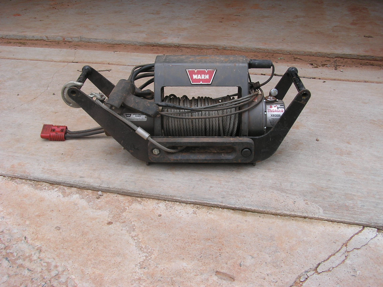

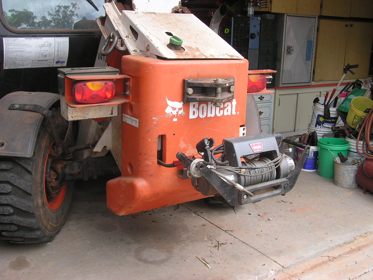

I found a great deal on a mil surplus Mile Marker hydraulic winch locally and have it mounted to a winch cradle. I had a receiver welded to some flat plate (can't recall thickness) and drilled out to match the bolt pattern for the weight bracket on the front of my tractor. When I need the winch up front, I just slip the cradle into the receiver and have a very solid platform for winching, even from an angle. The down side is I can't get the loader down all the way when the winch is on. I use the remotes on the back of the tractor with long hoses run to the winch. I also have a couple holes in my drawbar that match another receiver so the winch may be moved around back if needed.

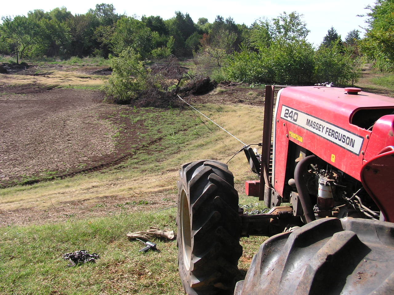

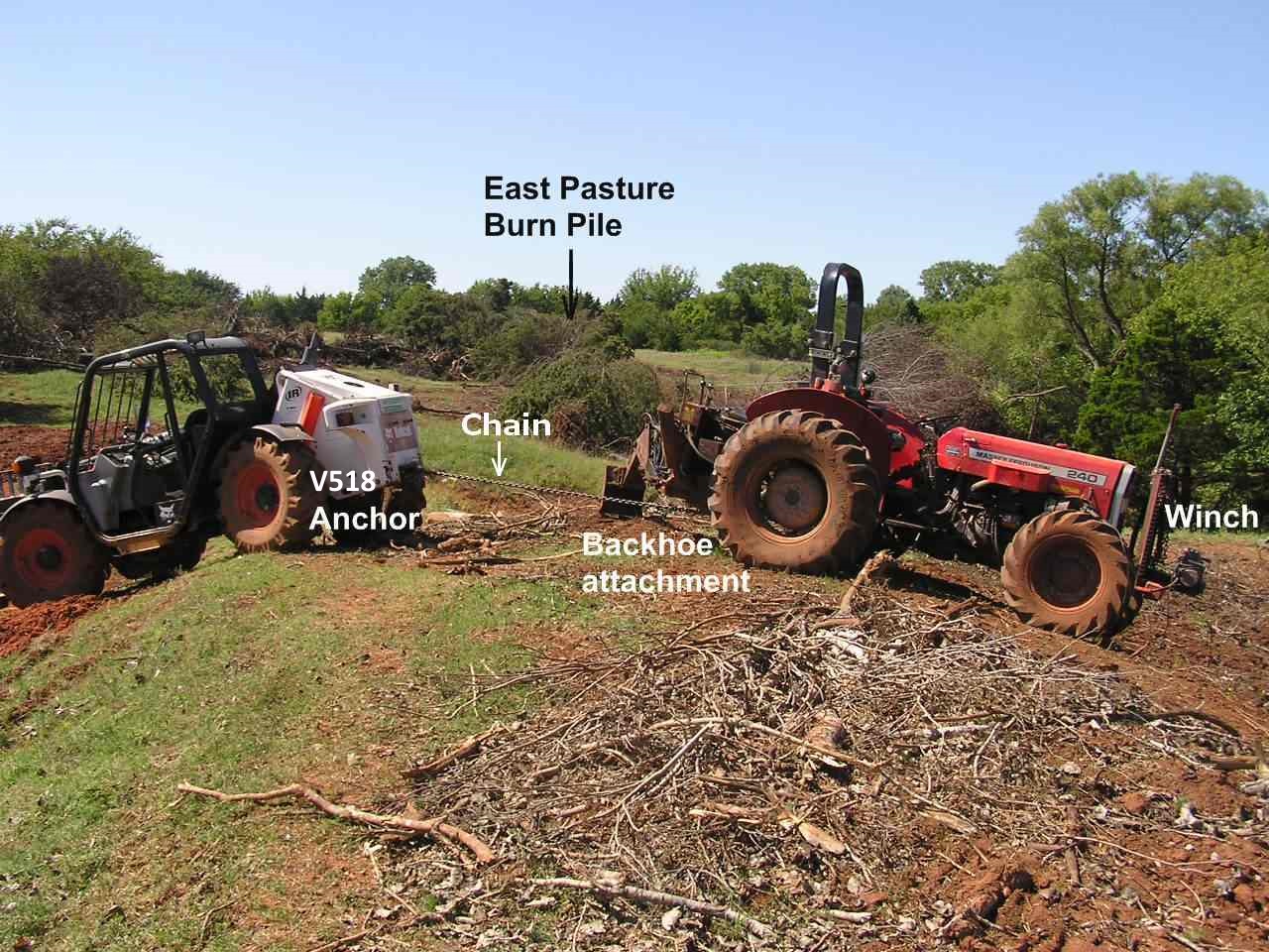

I have an L45 Kubota and one of its many uses include cleaning/thinning of the woods on our 20 acres. Most of the logs and brush I want to move I can get with the grapple and or backhoe with thumb. Occasionally I use a chain and skid the log where it needs to go. In several cases, the logs are on a slope that does not allow me to get the tractor close enough.
My idea to get these logs close enough is to mount a Warn 7500 lb. winch to a QA plate and use the optional hydraulic ports on the loader arms to power it. They provide 11.8 gpm. which per the winch specs will give me ample line speed and pulling power. The winch has 125 feet of 3/8" cable. This would give me the reach I need to skid the log to a point I could get it with the grapple or re attach it with a chain to the rear of the tractor. I think by pulling fairly straight on I would avoid any loader arm problems. Pulling hard from a side angle may over stress the loader arms.
The reason I want the winch on the front is because I want to keep the backhoe mounted. The weight of it gives me much better stability and traction, as well as maintaining the ability to use the hoe and thumb. A "farmi" style 3pt winch is not in my budget and it would force me to remove the backhoe.
By mounting the winch to a QA plate, I could swap swap between the winch and grapple or bucket in about a minute giving convenient flexibility.
By using a hydraulic winch, I could control it with the buttons on the loader joy stick. I spoke with a Warn tech who said the winch would work perfectly for the application I described.
