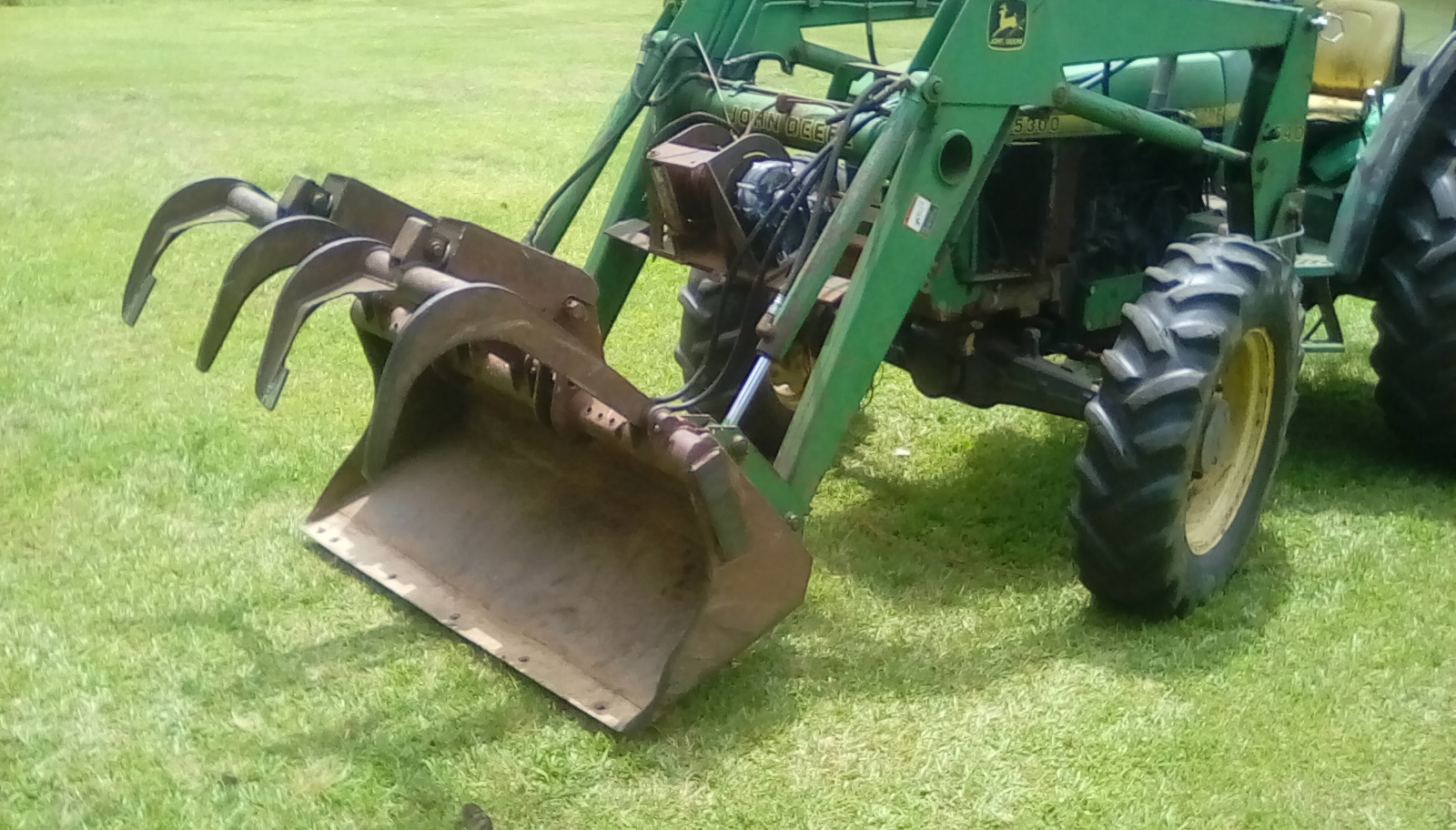

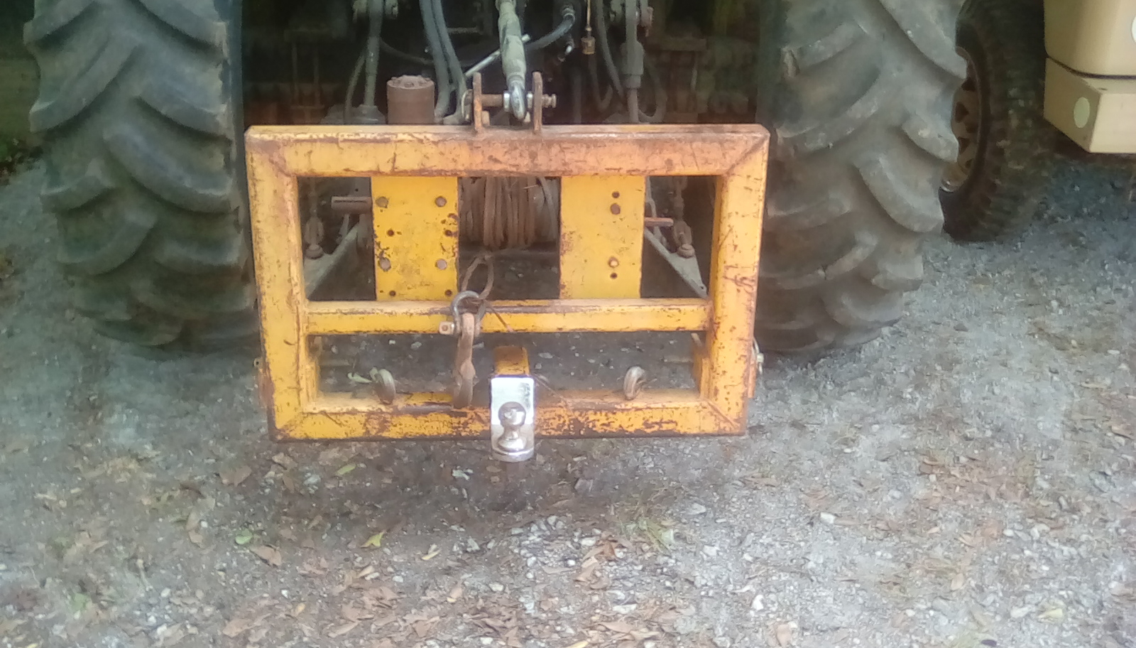

I built many pto tractor winches in the early 80s. Used Koenig 8000 and 12000 lb units. Had 9/1 gearing on the 8 and 18/1 on the 12s. Line speed was great and the work drive would give slack under load. I now have a hydraulic in my loader and 3pt. They are slow but strong on my 50 hp. Jd.
   / Hydraulic Winch #13
Rear and front
