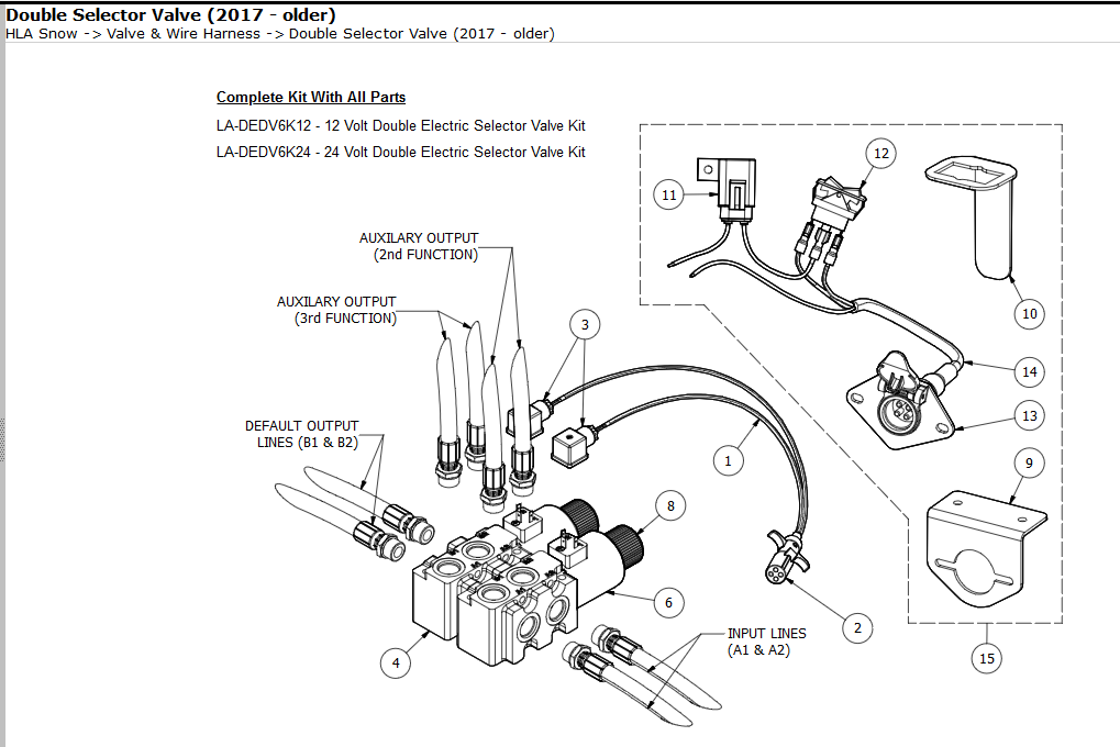

Hmmmm….. Hafta brainstorm that remote thing again.....
If he leaves his FEL on it takes 2.
If the blade has hydraulic angle and hydraulic wings it takes 3.
If he adds diverters to the two FEL circuits he still needs to add 1 remote
The HLA ones we have use 1 remote and a pair of selector valves, here is the page from the HLA parts diagram:
635833d1578363495-hydraulic-wing-snow-plow-pusher-hla-png
Both diverters off and flow passes through to the angle cylinders.
Diverter 1 on and flow passes to one side wing
Diverter 2 on and flow passes to the other wing

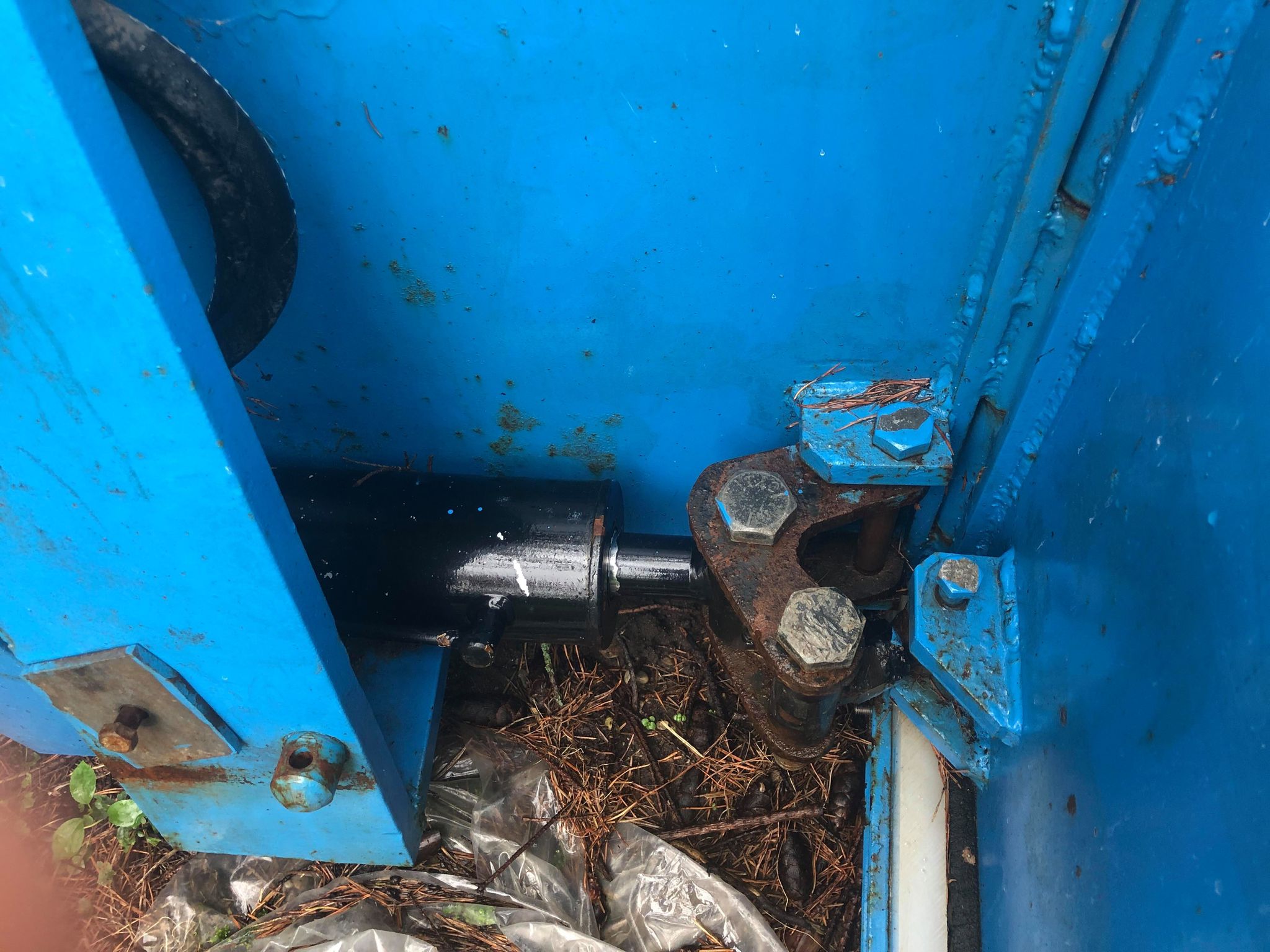

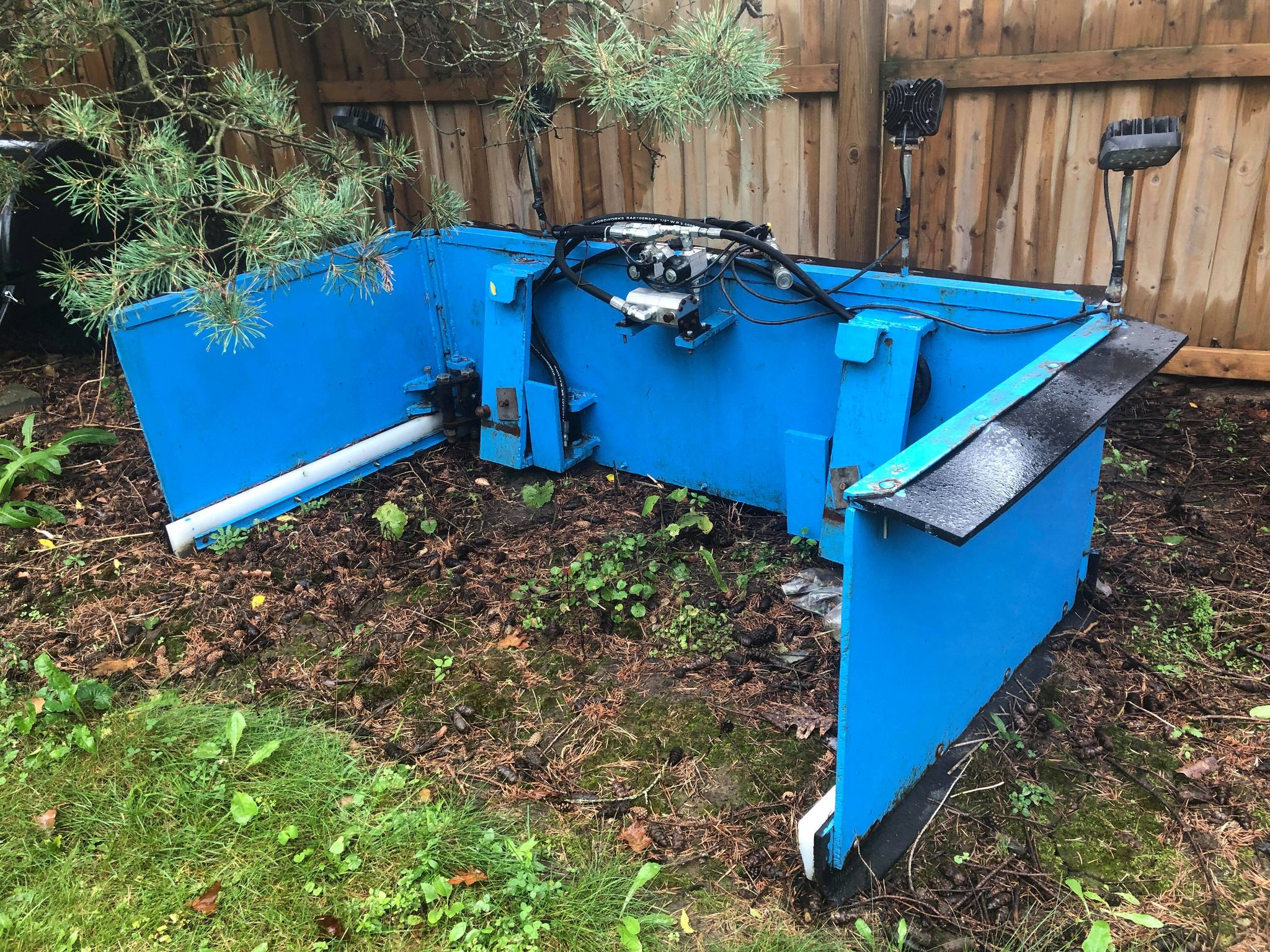

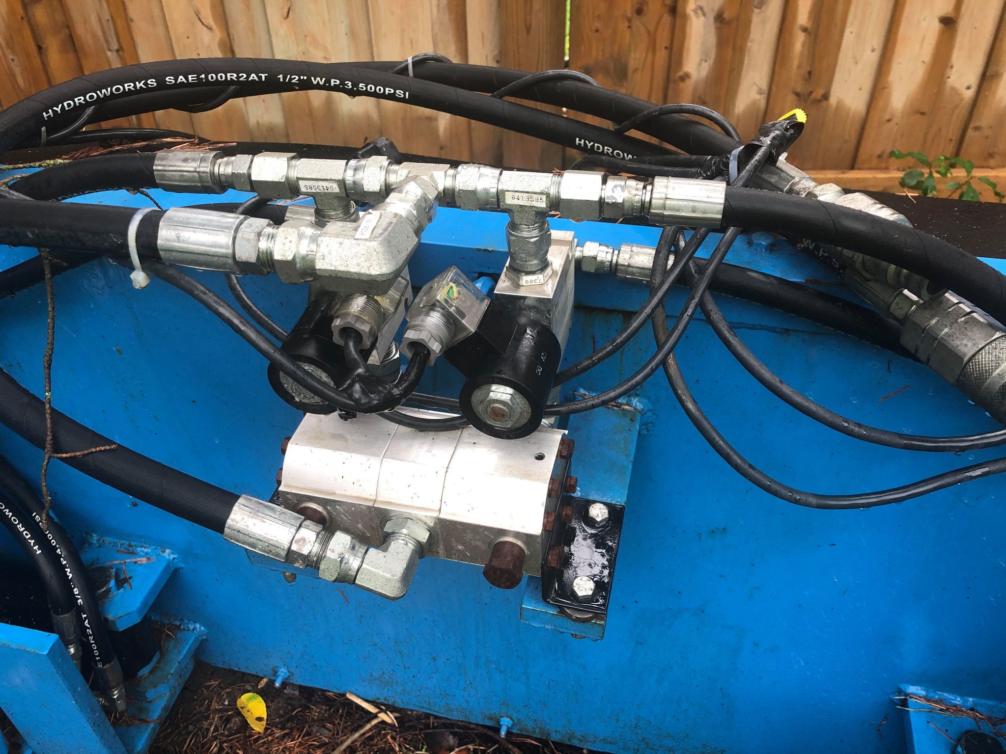

I made one a couple of years back, This one is bigger than you need but maybe good for ideas. It does not tilt, which allows it to stay very close to the tractor and not way out, but the wings go 180 degrees for either push or pull or anything in between. The wings can move independently as well as both at the same time so you can create a wing with one forward and one back . This one is 6 ft wide with 3 ft wings but you can make it smaller! Best thing is you do not need any extra hydraulics as I use the tilt cylinders valves to move the wings. I just set it level on the ground and then disconnect the tilt for the loader and plug in my plow .. it stays exactly where I need it all winter. I will try to attach some pics .. Here is a video link of it working John Deere 332 Moving 4 Inches of Snow with Blade and Snow Blower - YouTube
