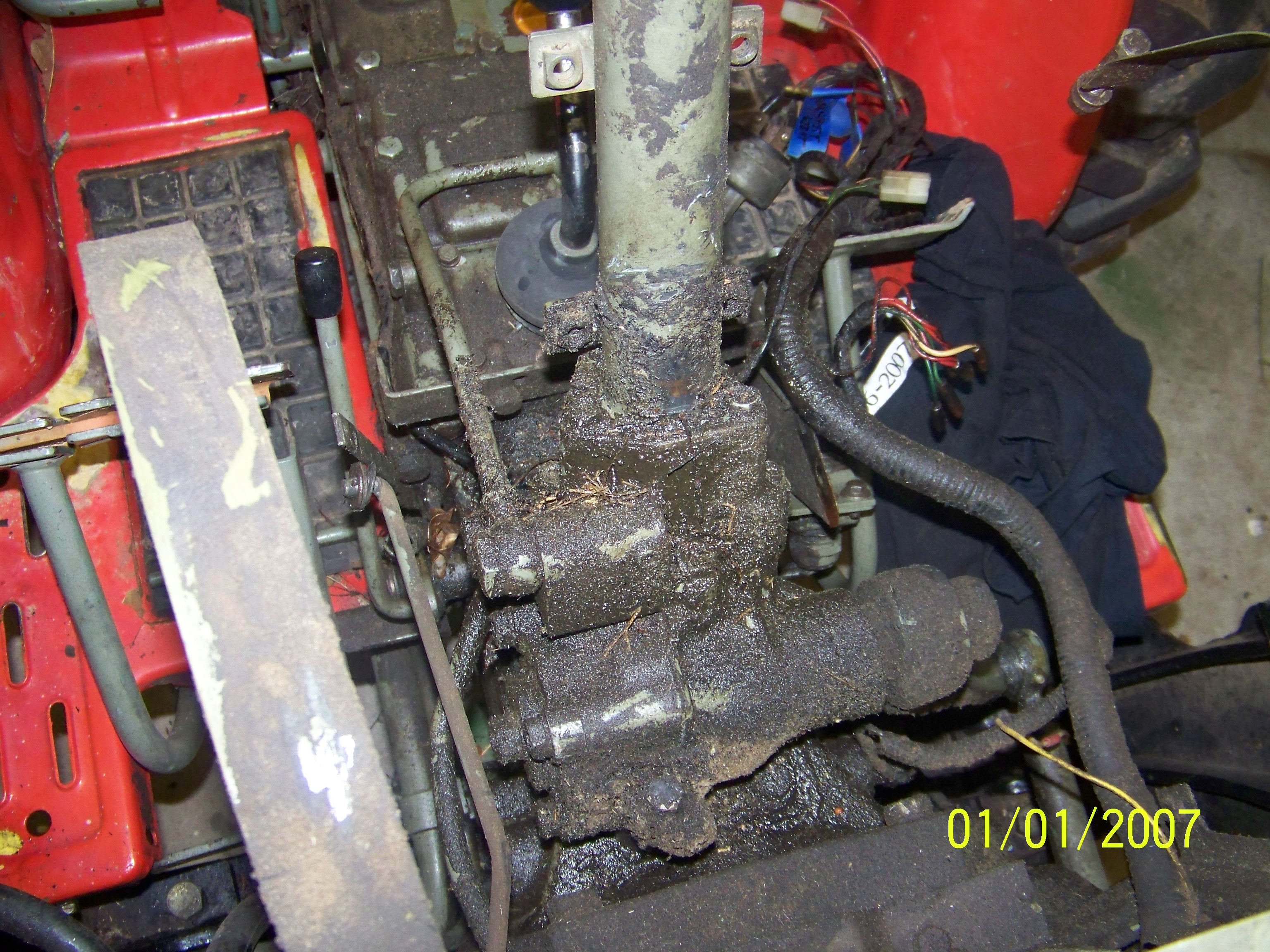

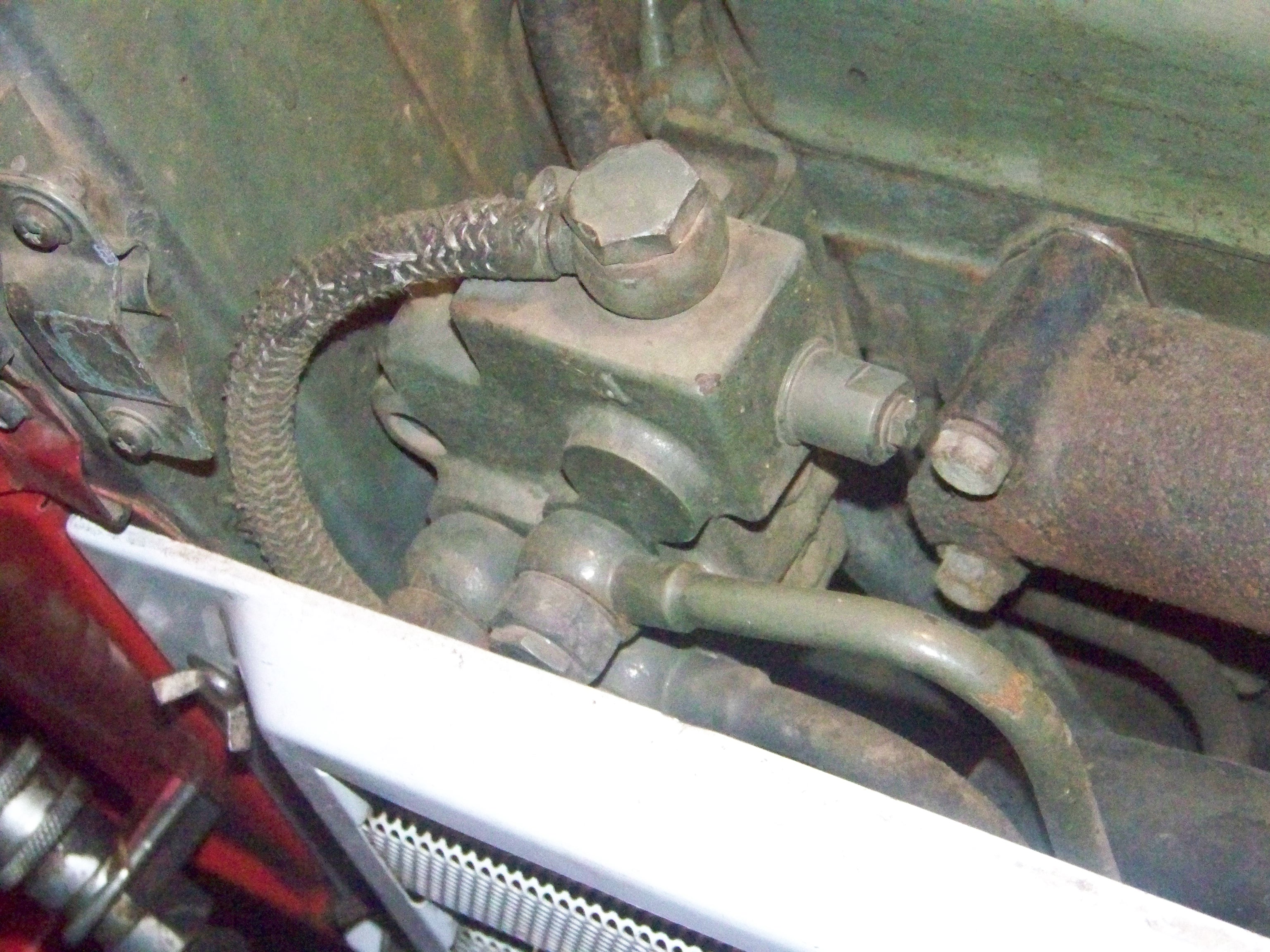

Butting in but pretty familiar with factory power steering. The factory power steering goes from pump through diverter valve. The diverter valve tees it to both power steering and 3 point. Second picture shows the power steering unit. Note the return line dumping in the top of the transmission. The line going to to His loader could be plumbed in several ways. Quite confident the 1720 and my old 2002D were very similiar hydraulic wise. When I bought mine The line was cut going from diverter valve to 3 point and loader tied in with out power beyond. I later added power beyond and it did improve quickness, but not much.
