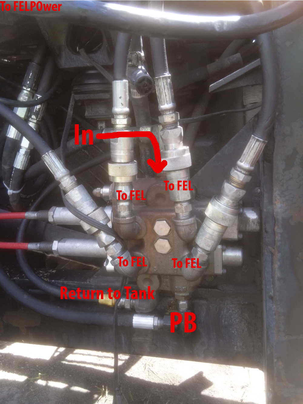

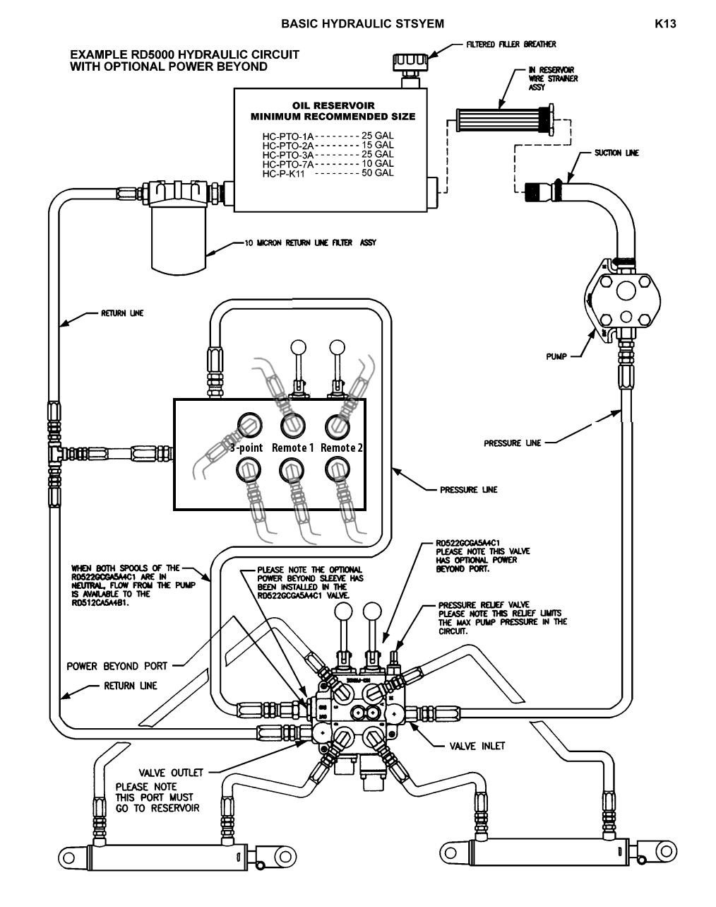

Thanks for the input. I've mapped out my hydraulics:
And the PB appears to be plumbed correctly:
But now (after a few days of dinking around) I still get good pressure in the FEL, but neither the 3-point of either of the remotes have strong pressure. Before I could deadhead a remote and get the 3-point to lift, no longer the case. What's the next step? Should I get a pressure gauge and see what kind of pressure I'm getting in the system? I checked the oil filter and it looks OK. The factory spec is 2700 psi.

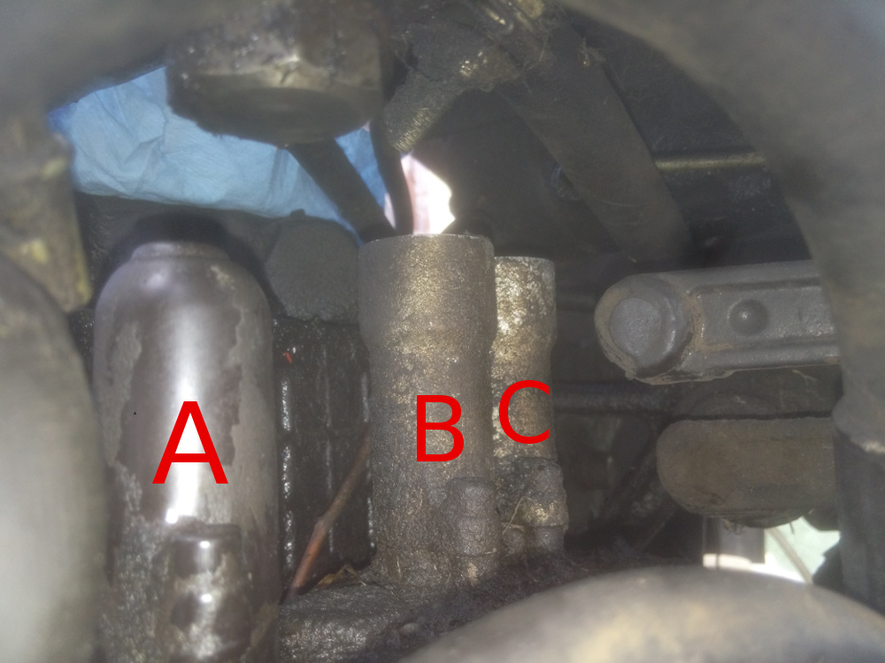

Also, here is a picture of the top of my 2nd valve (i.e. attached to PB port on FEL valve). What is the tall, dome-shaped thing (label A). It appears to have a rubber cap at the very top.
Is this a pressure relief valve of some kind?

yes you should have a psi gauge. The first thing I would do is to pull out that fitting for PB port and make sure it's a PB fitting and not just a reducer. The tank line should be the same size as or bigger then the in line, but that has nothing to do with the trouble you are having. That well only slow down the FEL and make heat.
You said you were dinking around, just what dinking around did you do? The A cover, I think you are right other wise I don't know for sure.

  1. What if the fitting is not PB (i.e. just reducer)? Is this a big problem?
  2. Is it worth swapping out the OUT hose with a larger size to match the IN? Would this materially improve the FEL performance?
  3. I want to check the fluid for aeration. But to see into the reservoir I must remove the filter. Is it OK to run my hydraulics for a few minutes with the filter removed?
I'll post back after I figure out the correct fix. I bought a PSI gauge today and I'll test pressures tomorrow. Thanks!
/ Hydraulics Mystery... #12
#1 you would not have high psi after that valve. #2 Wait on that, but yes it should speed it up and help hold down heat. #3 I would not do that if you are talking hyd filter.

"What Leejohn said." ^^ btw, 3 line/fitting sizes, or optical illusion? Tractor has 12 GPM pump flow, yes?.
I'll risk any backlash by suggesting 1/2" min lines/fittings for 12 GPM and 3/8" only for 6 GPM valves/use.
Also, I beg you to replace malleable iron street 90s (what they look like, .. 300 PSI or less max) or they will fail in time at >2k PSI.
Be sure "PB" and "return to tank" (pic #2) aren't reversed. (?) May help to plumb up some 'adapters' beforehand to ease gauge connection at various points in the system, including QDs to test FEL lines etc.
