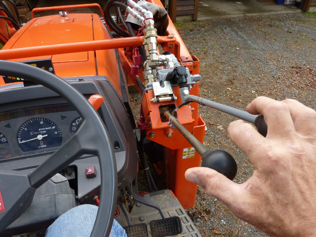

So far I really like the W R Long 3rd function kit and this is what I will probably get. I'm not sure yet if I want to try to install it myself or let a mechanic do it.

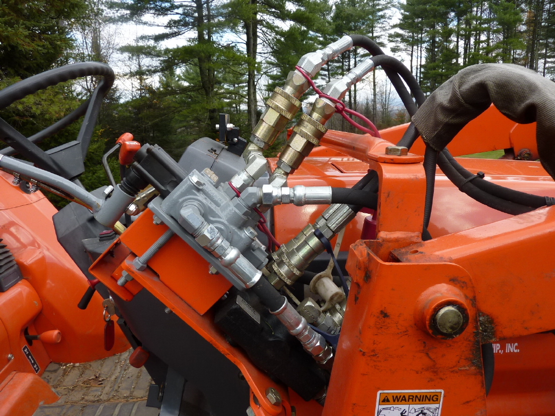

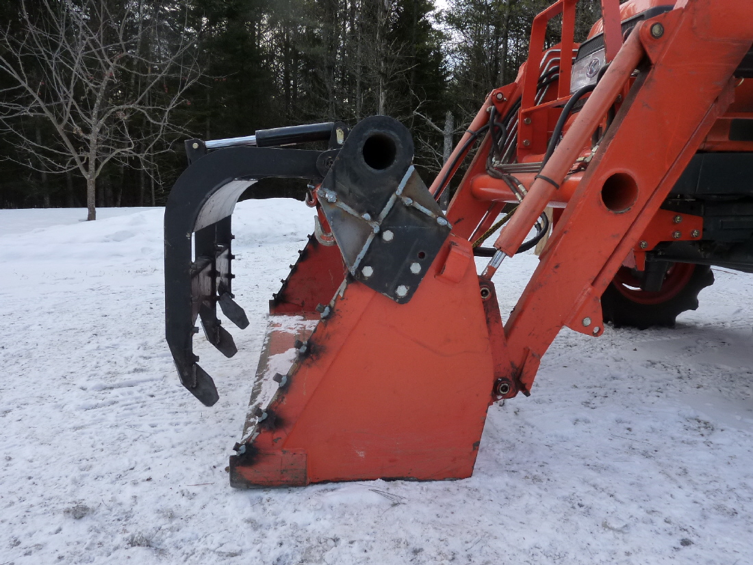

   / Hydraulics needed to put thumb on Kubota L4400? #13
Just get the selector/diverter valve from Surplus and use a thumb switch to activate the grapple.
Many on TBN have done the same thing.
You can use a momentary switch for momentary use or use an on/off switch to leave it on as long as you need it.
Off mode reverts to bucket tilt.
Surplus Center - 12 VDC 13.2 GPM SAE 8 DOUBLE SELECTOR VALVE
You need
valve
hoses
switch
bracket
