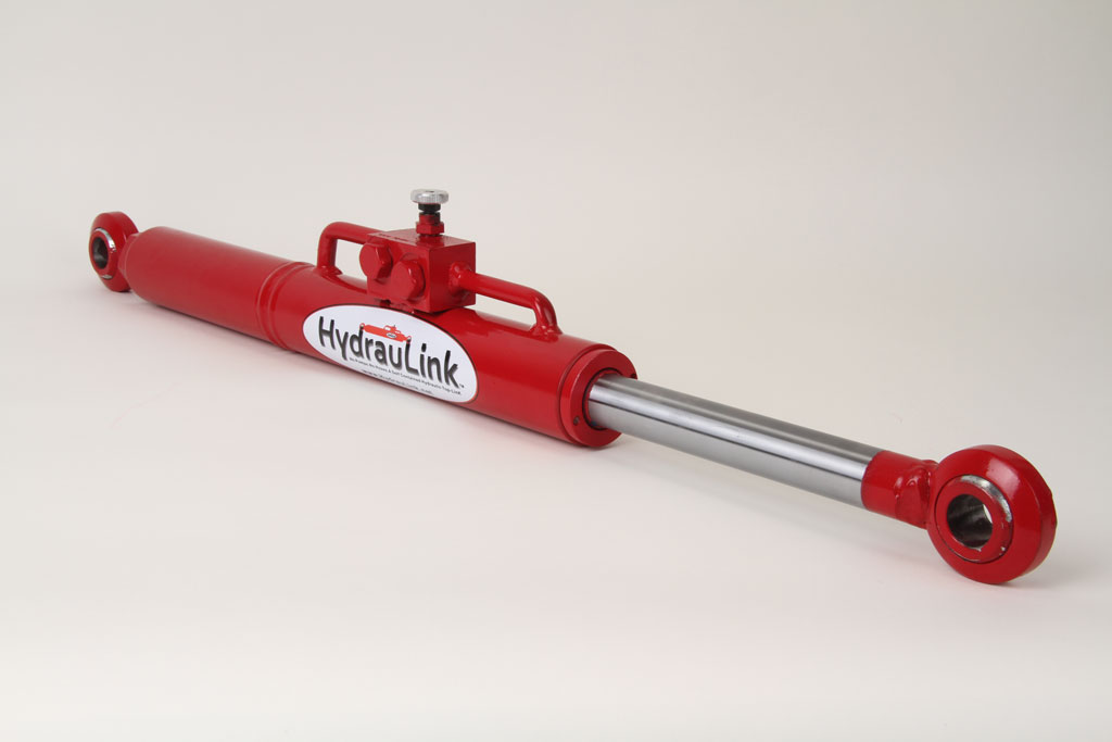

HydrauLink- a self-contained air over hydraulic top link

Okay... we've had a lot of big news recently.
1. Category II hydrauLinks are here and ready for sale!
2. Category I extended screws have arrived.
3. New vendors have joined with HydrauLink!
