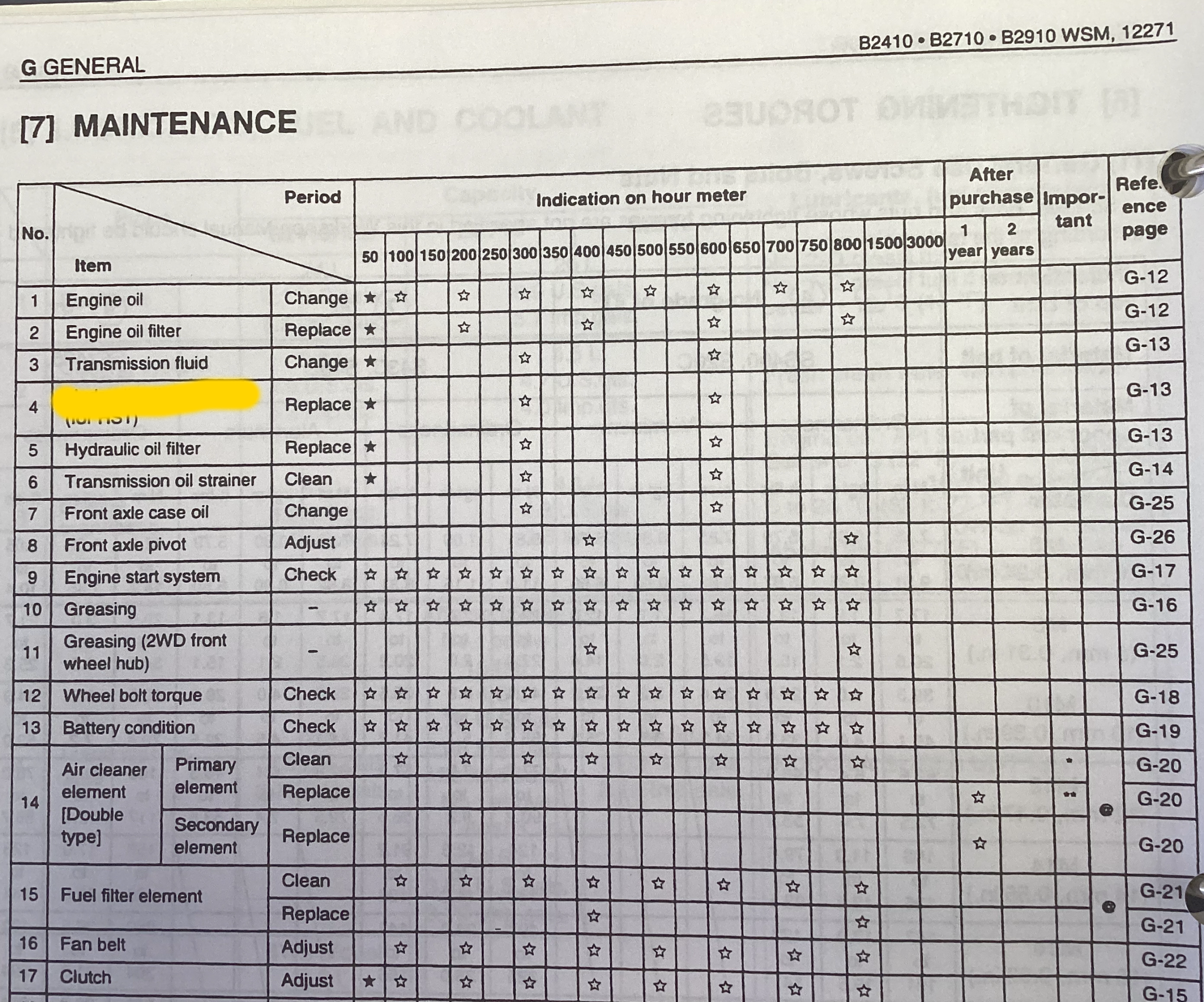

My B7800 is 19 years old. I noticed that the hours just passed 800 and I thought that I should check what maintenance items are due per the Kubota manual. All were current but I noticed that hydro oil was due at 300 and 600, BUT nothing beyond that. Doesn’t that seem unusual? I plan to change it every 300.
Looks like Kubota made a common mistake in their manual: If first hyd oil change is at 50hr, and the subsequent intervals they call for are 300h after that, it shoulda said 350h for second oil change, and 650h after that.
More common interval for most tractors is 400h after the first change (at 450h on the meter), as JJT does. I did not even change my fluid the last time, cuz I had a backhoe leak and had to add a gallon here and a gallon there for a long time. Just the 2 filters.
/ Hydro oil change #6
I think it's every 300hrs once you reach 300hrs.
So you change it at only 50 hrs to get rid of all the manufacturing and initial wear/seating contaminants.
Then again in 250 (@300 on the meter) for any residual.
From then on it's multiples of 300, keeps it simple, 300,600,900,1200,1500, etc

So you’re saying I should never change the hydro again?
We need to see the legend at the bottom of the page. What does the "empty" star mean?

It means DO IT!
Obviously but just at 300 and 600 hrs?? I think it might say "Every".
In the LS manual it has a Black star in the 50 hour column and below the chart it states "First Replacement", But the LS chart at the top states "Check Period (Every ---(hrs))"
Not the clearest verbiage but sufficient and a little clearer than your Kubota.

Beyond 800 hours, just repeat. Can't run the chart on forever.
