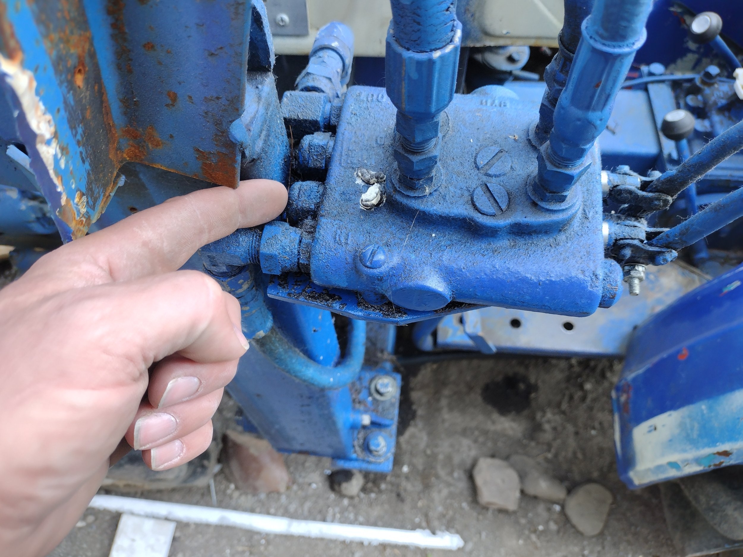

Hi I think I have a MY342D. I have a leak in a strange place it seems like it's just a cap.
