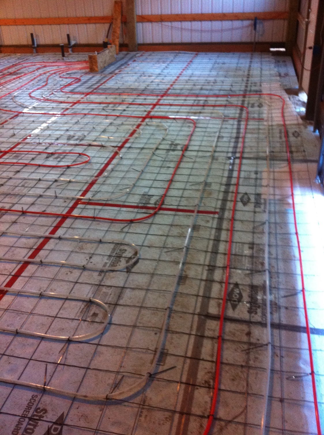

My 36 x 48 shop was done with radiant floor heat using a 30a Rheem on demand water heater on a closed loop system controlled with an in-slab thermostat set anywhere from 54° to 60°. I have a wood fired force air furnace I use when I work in the shop. This setup does very well for me and I don’t have to winterize anything as long as it’s in my shop. Most wheeled equipment gets stored in the loft, freeing up floor space.
What kind of tubes are those? Some look like PEX of some sort and the others look clear..
   / Hydronic Floors & Hot Water Heat #25
The PEX color is sometimes dependent on brand.

Had a buddy with extra leftover pex so I only had to buy what I need to fill the rest. Both do the same job and both are oxygen free pex.
I originally had a hot water heater when I quickly realized that it’s the wrong application for the job so converted to the electric on-demand unit and it has been flawless ever since. A lesson learned & I advise others.
