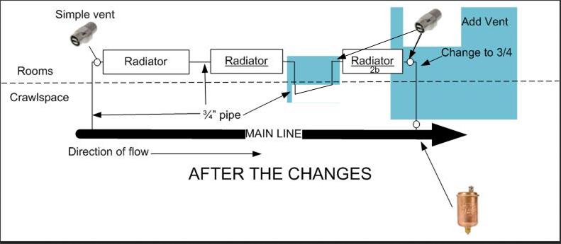

Yes it would be the right way but it would require disassembling that main loop of old 1 1/2"pipe cutting and threading it adding two flow tee's.
With luck adding an air vent to the new #3 or 2b possibly on both sides may get flow established again.
I agree on the relative ease of this plan, and am optimistic that the result will be satisfactory.
   / Hydronic heat, I broke it. #43
I split radiator 2 into radiator 2a and radiator 2b.
Just curious, how did you split one radiator into two? And if you did, how did you plumb them back together?
   / Hydronic heat, I broke it. #44
:laughing::laughing: Yeah, if I interpret your interpretation of my interpretation of the as-built system - you are correct in your head scratching. The system is a one-pipe main, so the circuit tee-s off to a radiator, through the radiator, and back down to the SAME main pipe.
Picture me when we first moved in - laying on my back in the dirt with a flashlight trying to figure it out - why is the radiator "in and out" going to the same pipe?
Also agree about the air valve - I don't know why it has an air valve UNDER the house. I replaced the original manual bleed with a an automatic thingy a couple of years ago.
Anyway, it all worked fine until I added that U shaped section.

Success!
I tried the easy fix, and it appears to have worked. All of the radiators are providing heat.
I added a vent on each end of radiator 2b.
I changed the output of 2b to 3/4
I added a slight rise to the u-trap.
During the bleeding, I noticed that the vent at the input to radiator 2b let out copious amounts of air when combined with the others.
What remains to be seen - will the system remain stable and not trap air, causing an airlock.

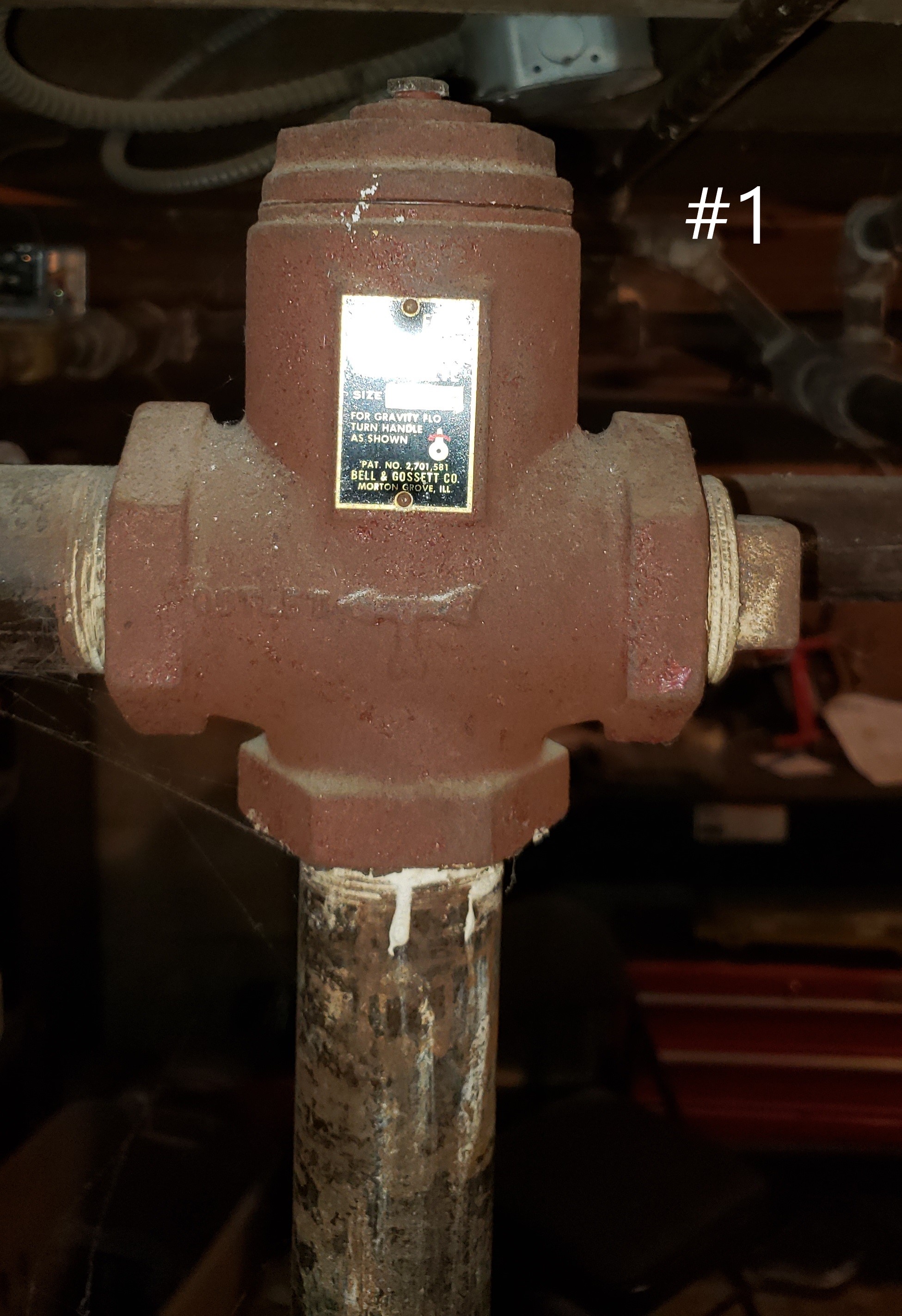

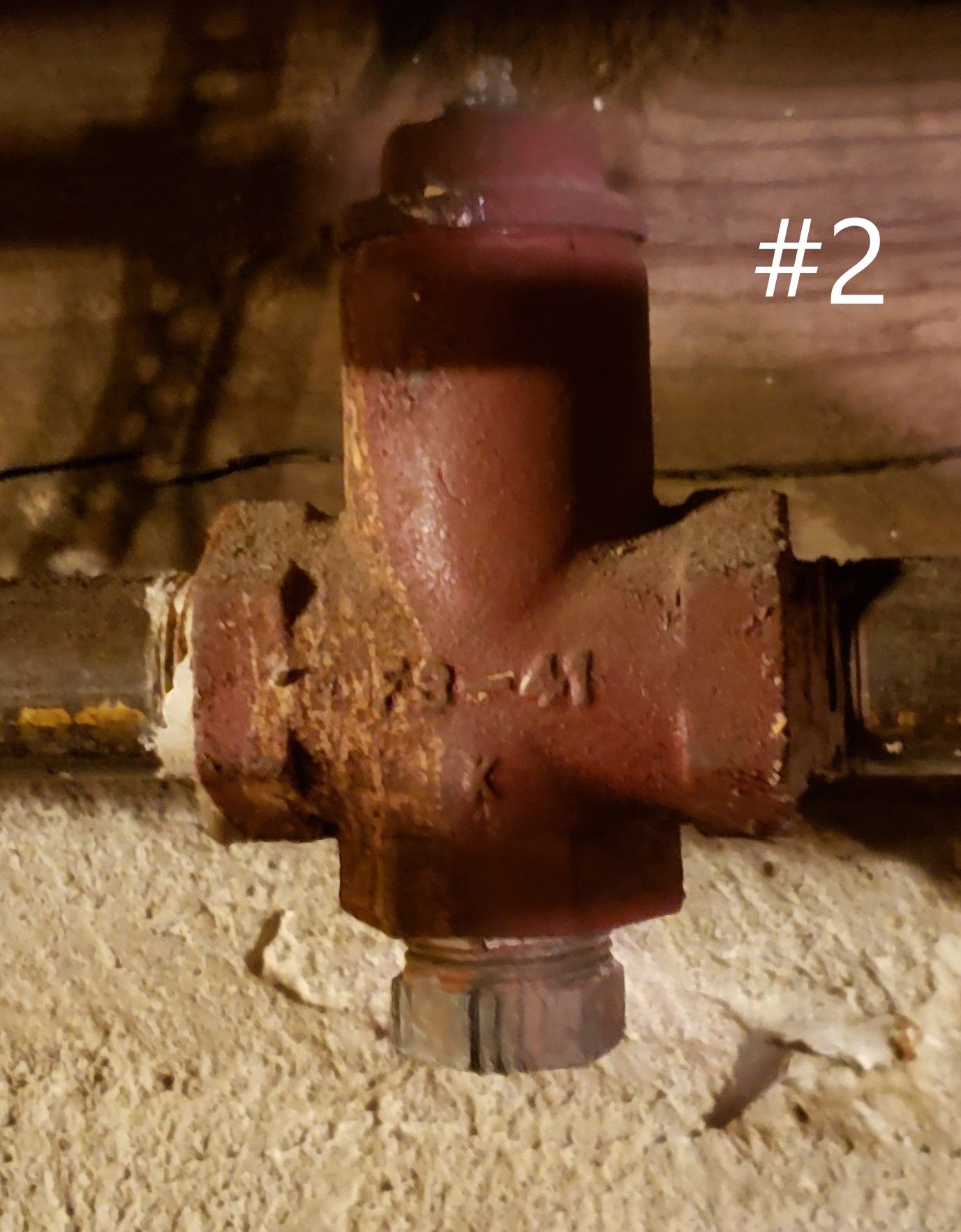

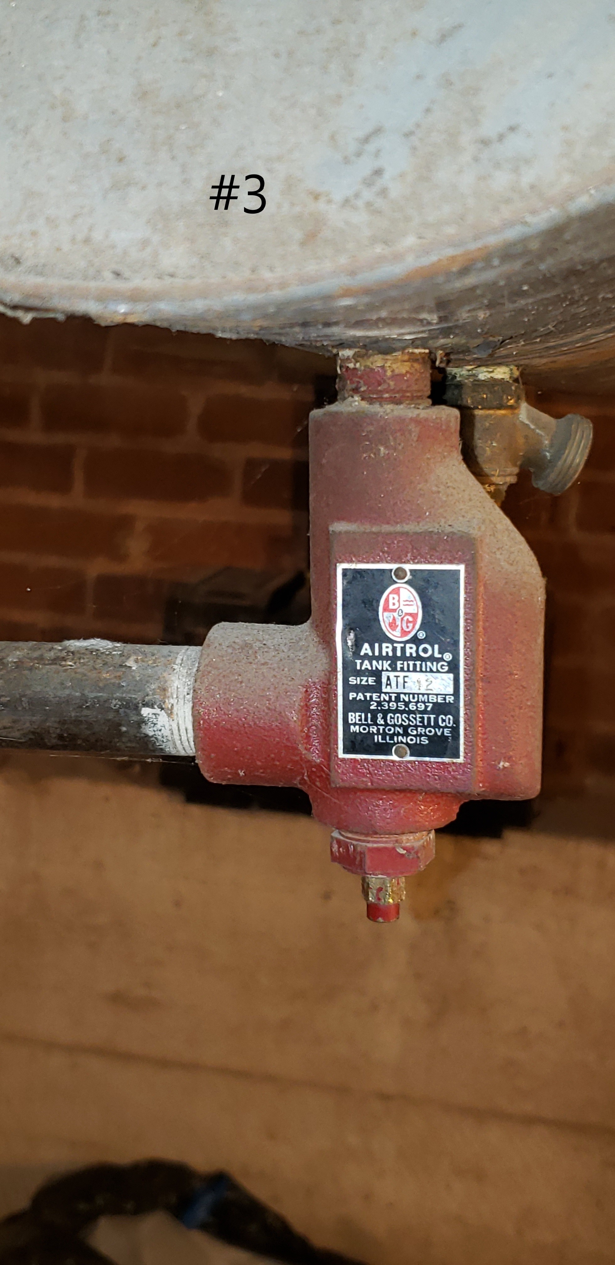

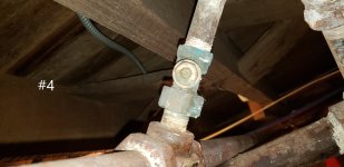

If you could, please identify the items in the attached pics.
What are they, and what do I do with them?
No problem if they need to be seen in context of where they are installed in the system, let me know.
