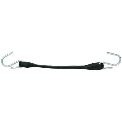

the spring is hooked to a long tensioner screw on my 4720H, maybe you can tighten it up some. could be as simple as that, since it creeps both directions it sounds to me like the spring isn't tight enough
I'm definitely going to look into that for mine, because mine does this as well (creep both ways). The spring is definitely not broken but it's not quite springy enough, so a tightening will be attempted. (Will report if I break it... is the replacement reasonably generic or is it a dealer-only thing?)
/ Hydrostat adjustment #12
I got a couple from the dealer, they aren't as cheap as they ought to be. I was able to find one at Ace hardware that worked, but it was not very strong. it worked fine until the OEM spring arrived.
/ Hydrostat adjustment #13
