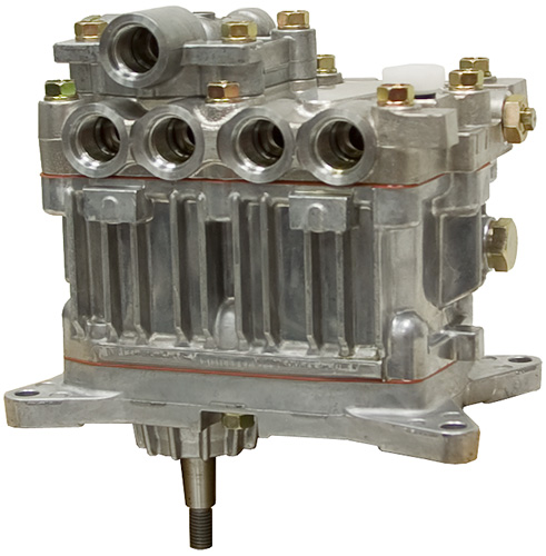

thanks JJ, yes there are 2 large lines and 1 small line on each motor. It is the smaller line I was curious about. Like I said hydrostatic pumps are new to me and I know there are some differences. I did not know what these lines did, but it sounds like it isn't anything that is necessarily specific to hydrostatic, I could see these being useful on any hydraulic motor. And yes these lines have dedicated penetrations into the tank, whether or not they have a drop pipe inside the tank or not I could not tell you but the fluid level i the tank is above them anyway.
On a side note, what kind of pumps are these usually. I doubt that it's a gear pump, I am thinking it's an axial piston pump but not sure why it would need such large return line if it were.
   / hydrostatic issue #17

like oldnslo said a partially plugged filter on the intake will cause surging or complete failure if it is run like that for long. Put a restriction gauge [vaccume hg] on the inlet line at the pump, that will tell you the story. CJ
