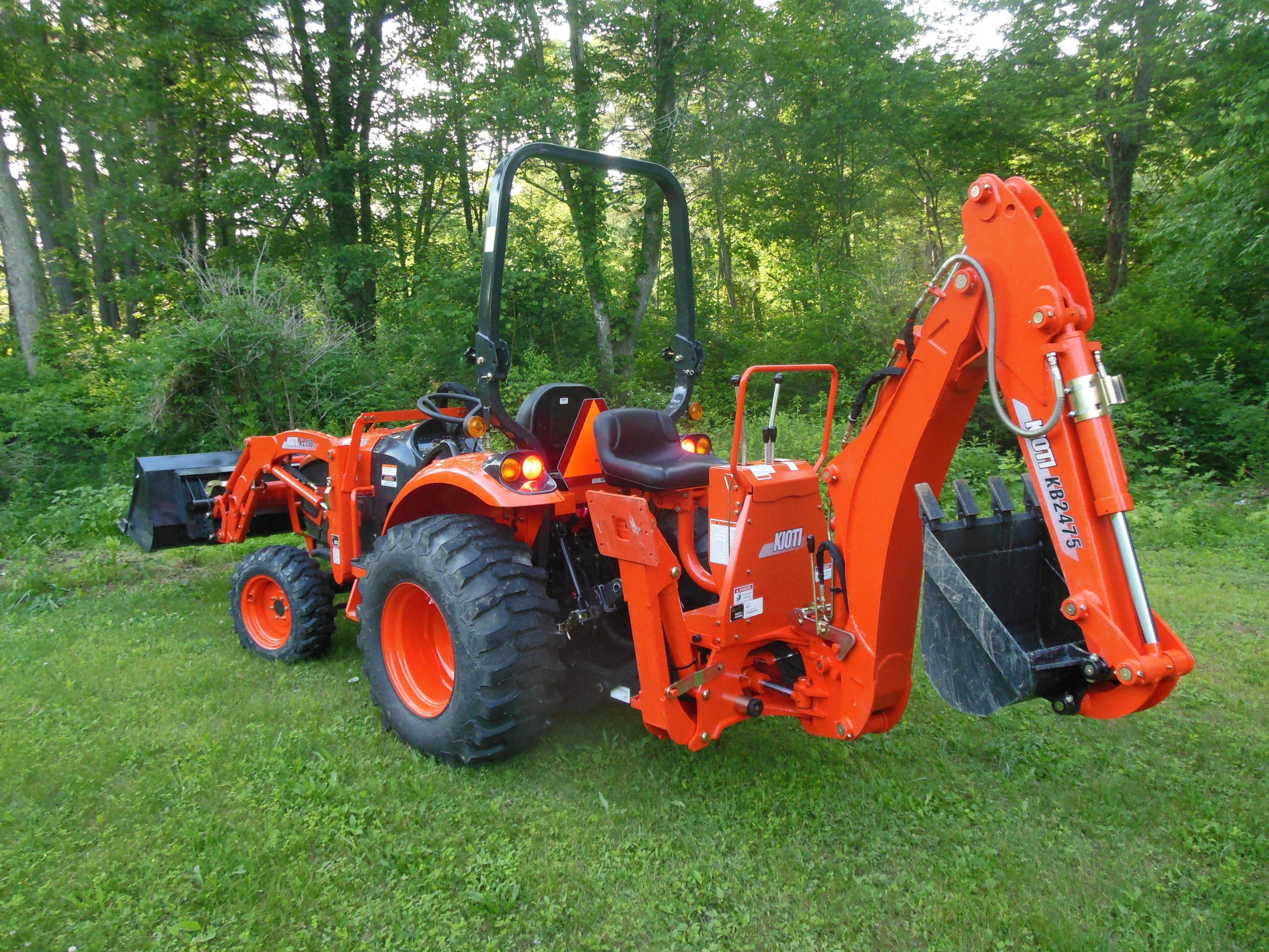

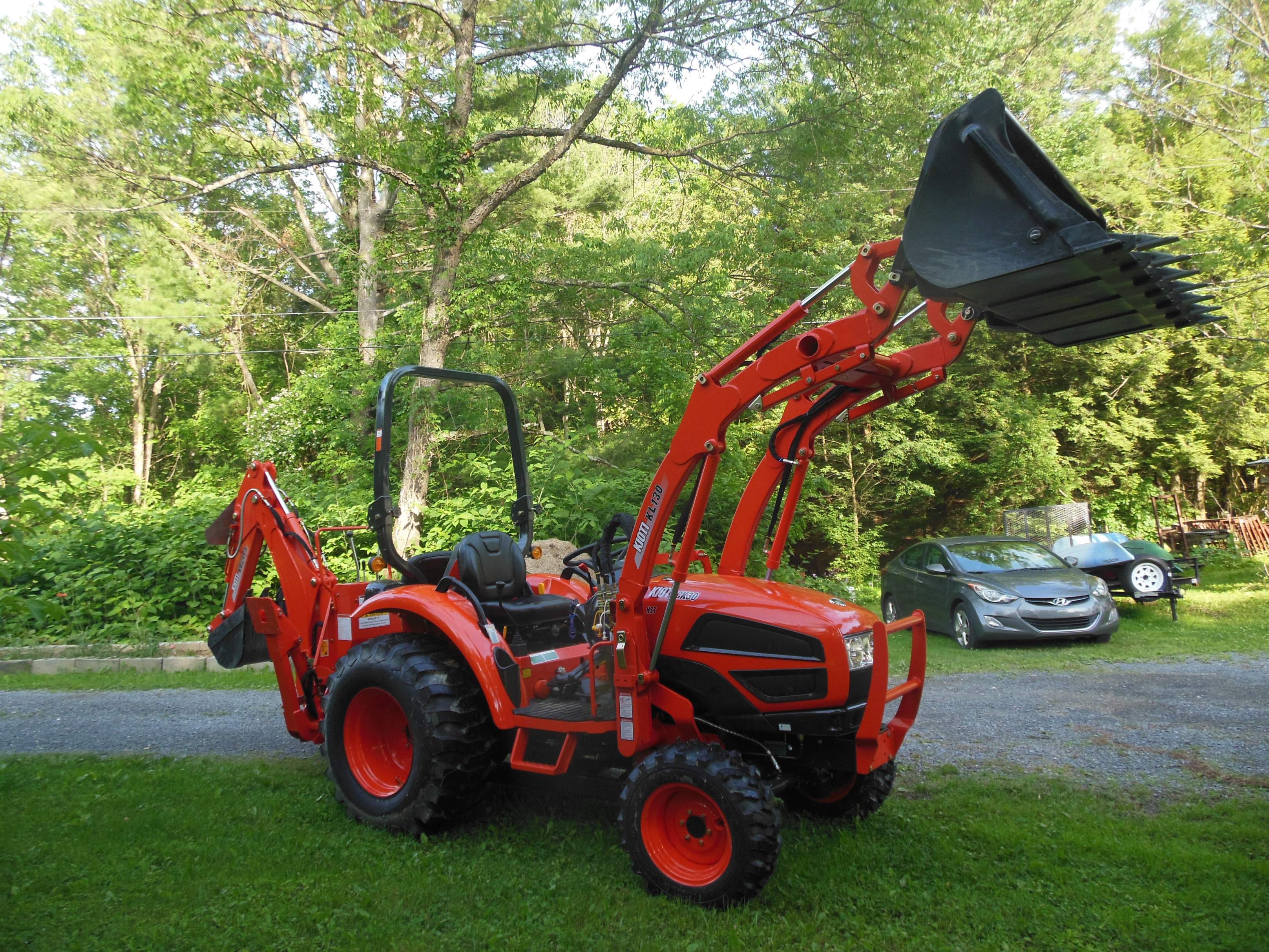

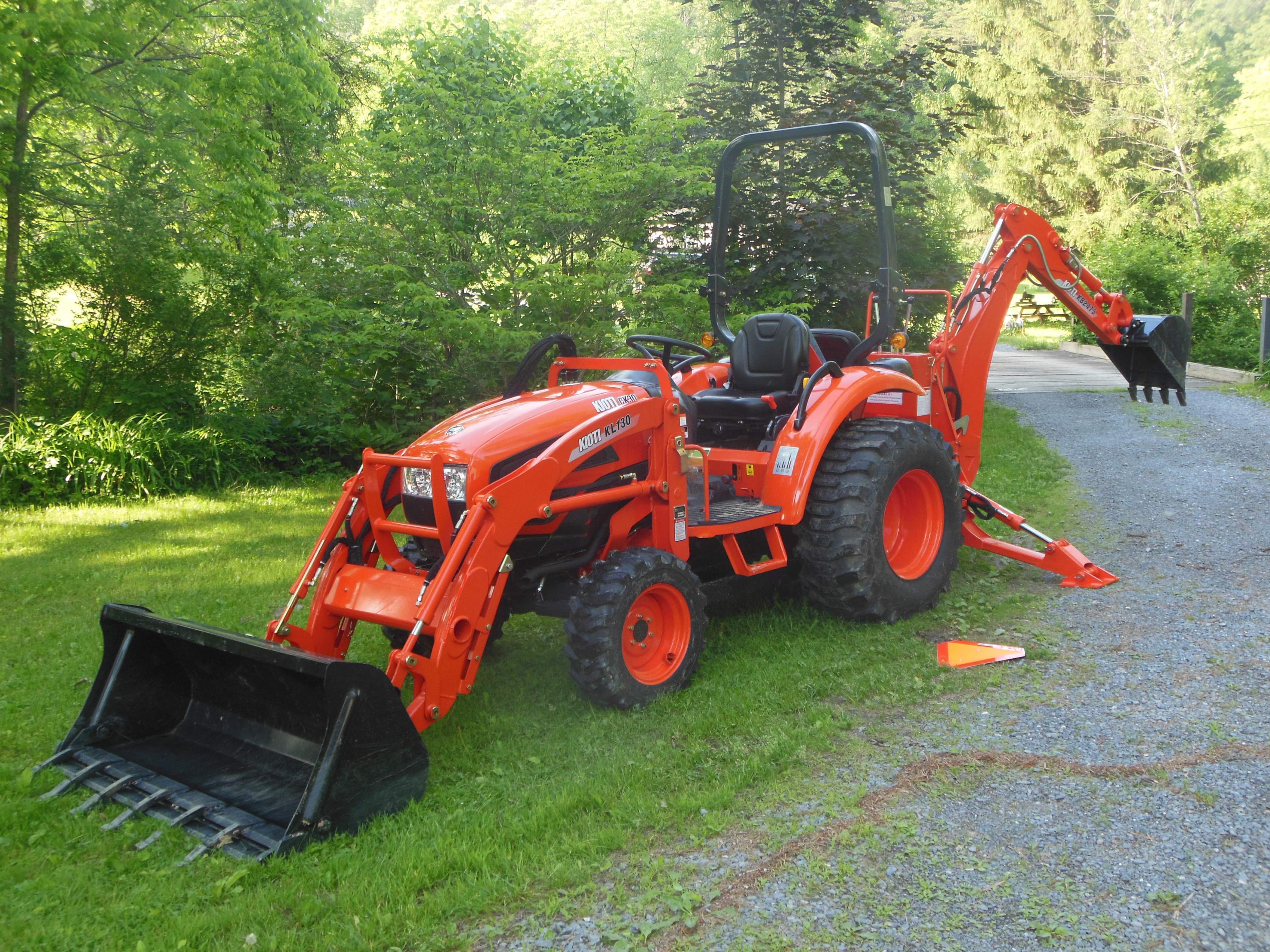

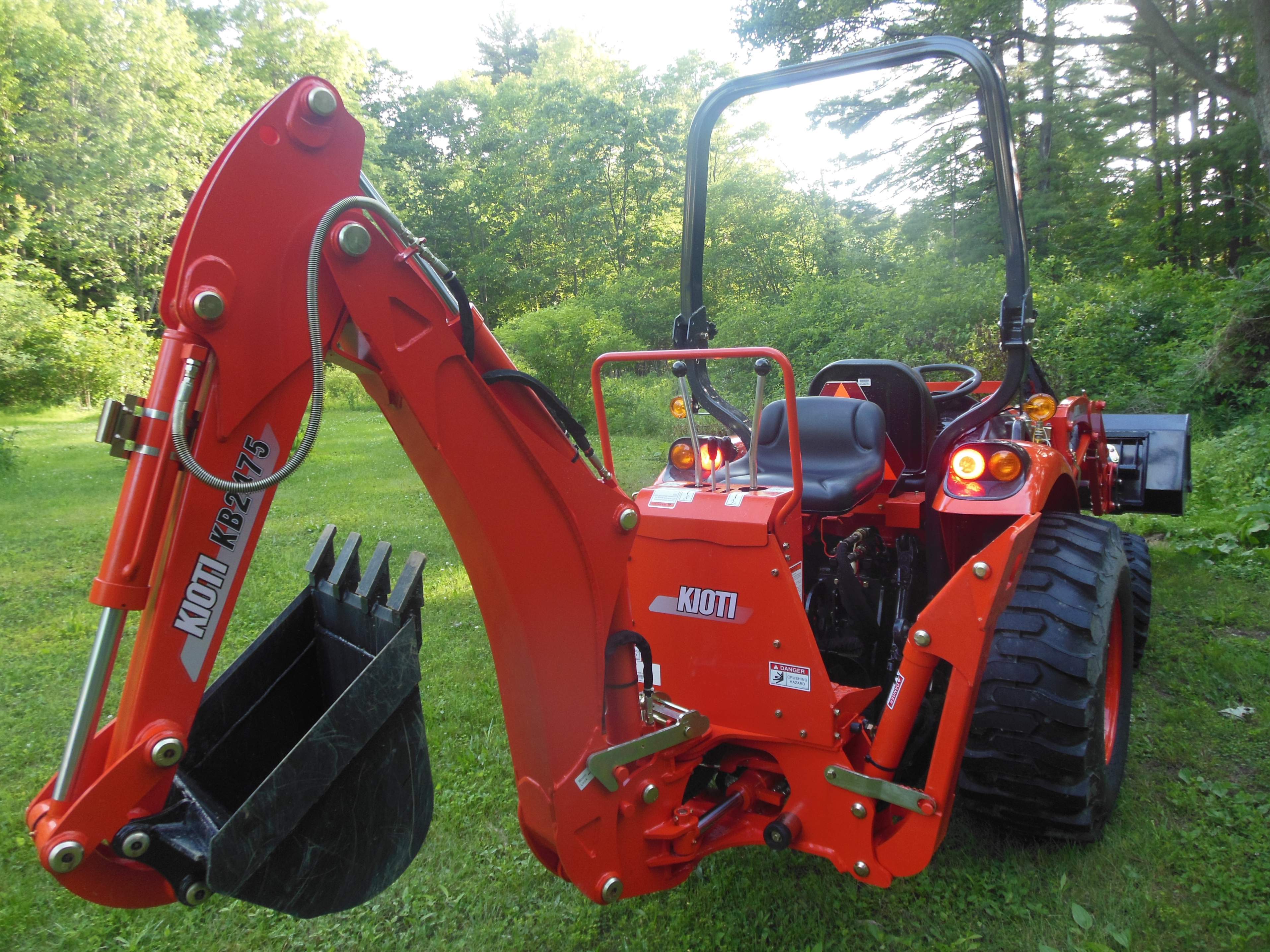

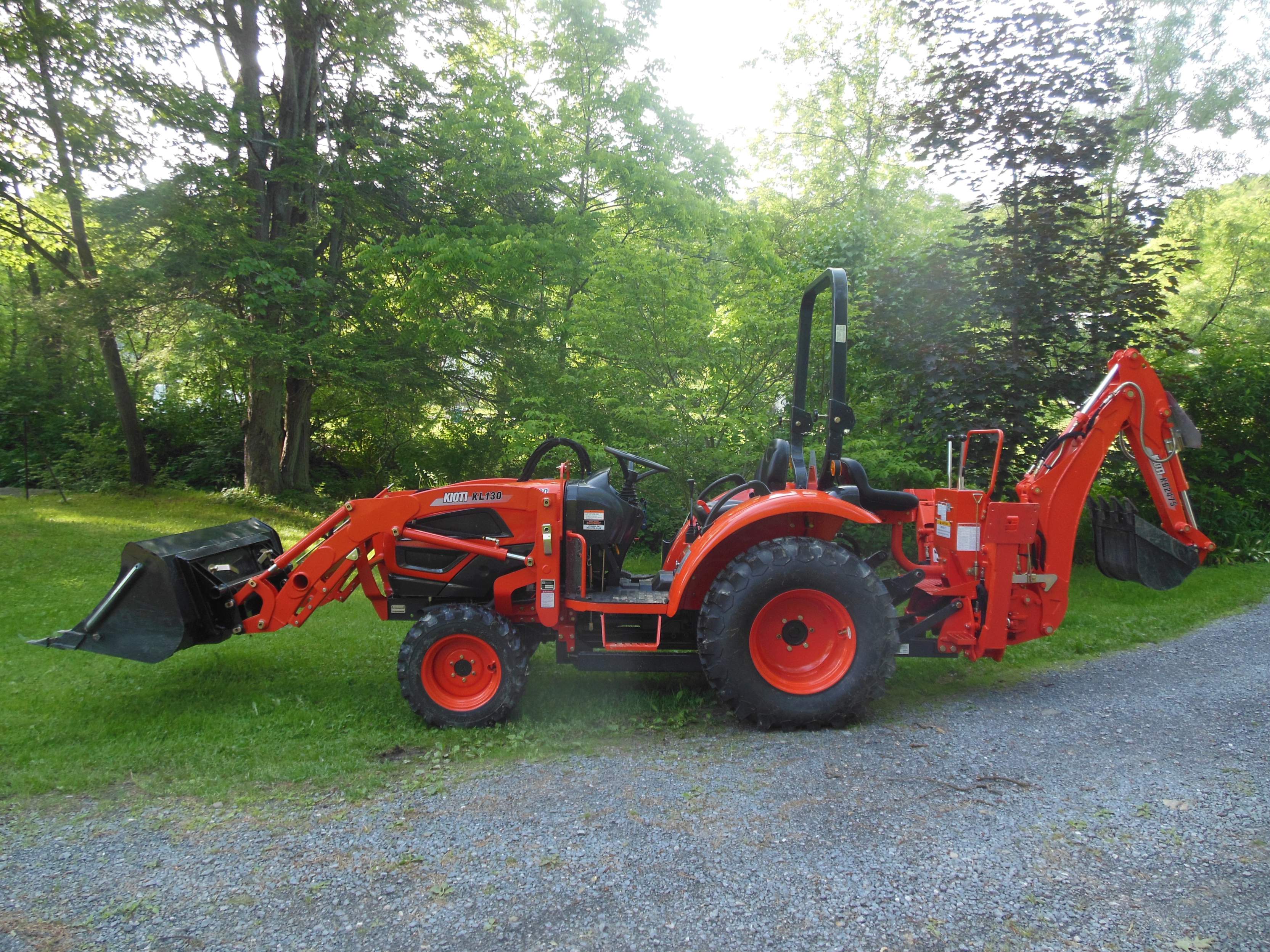

PS, Got the pictures taken of my ck30, but have to make them smaller to fit format. DSCN4261.jpgDSCN4265.jpgDSCN4275.jpgDSCN4280.jpgDSCN4281.jpg

Thanks again for all your help and hope you liked the pictures.

Well, that is kind of a puzzler.. The only time in my DK35se, I get any pulsing is when the RPM's are real low, and the tractor is just "dogging" around barely moving.. Cranking up the RPM's a bit always fixes it.. I don't know what the problem could be.. best contact the dealer. I do believe that the pedal on a CK series is direct connect to the swash plate and does not have the hydraulic connection that the DK series has. Having never spend any time on a CK series, I can't really add much real world experience. I liked your pictures, they were very well composed.
