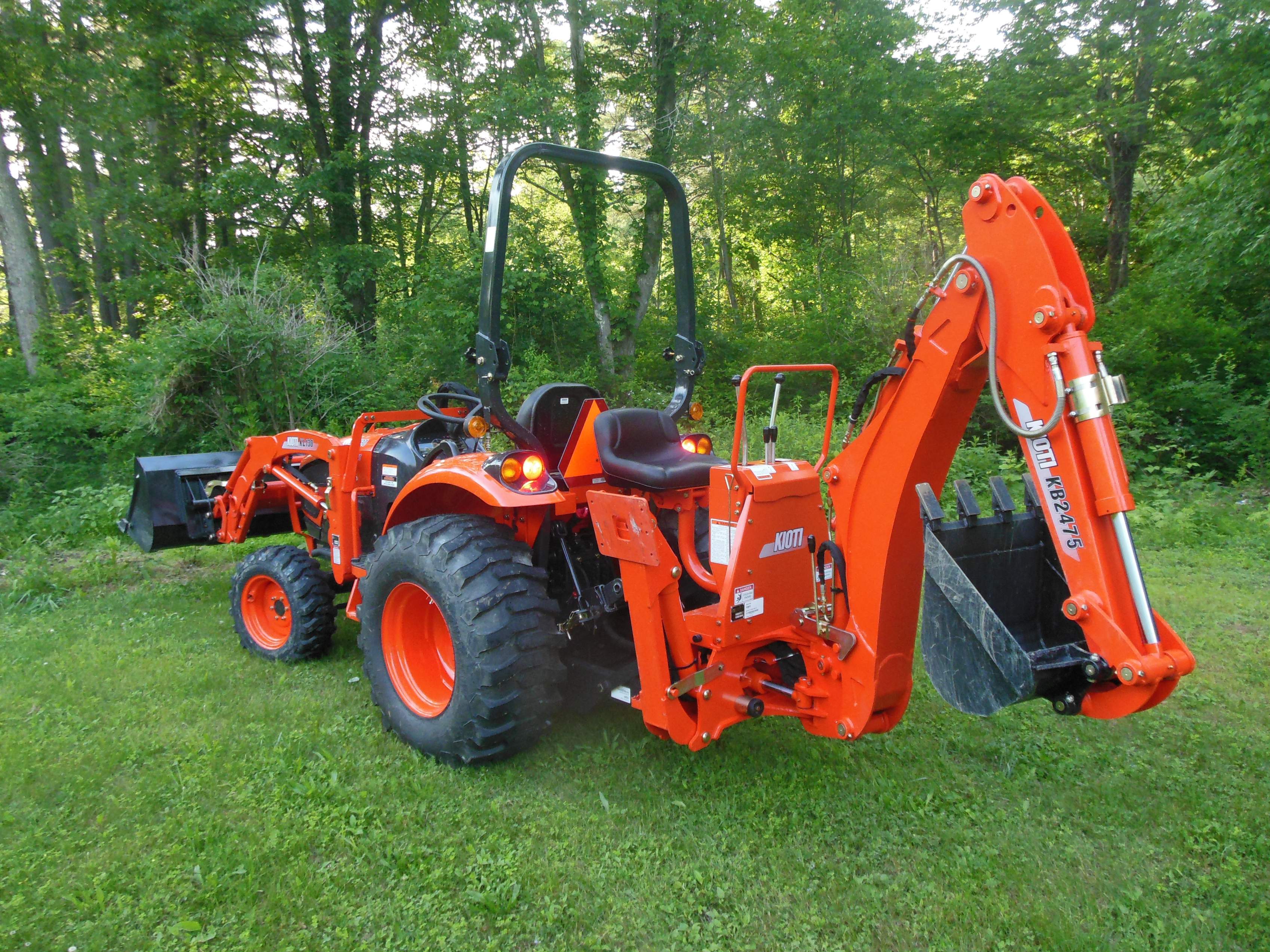

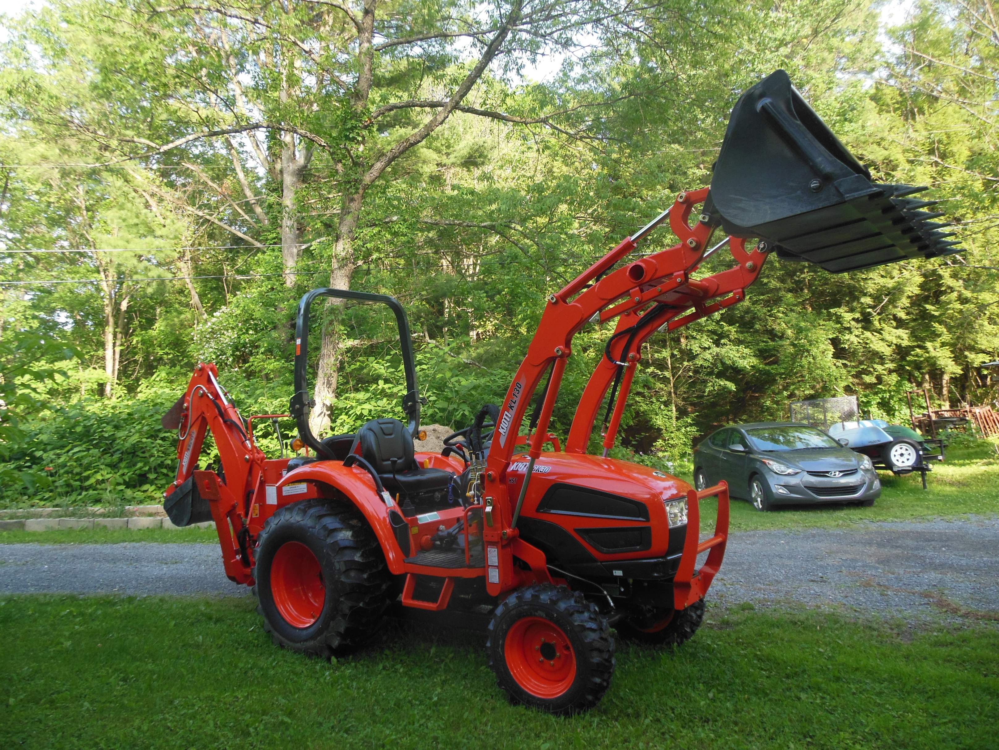

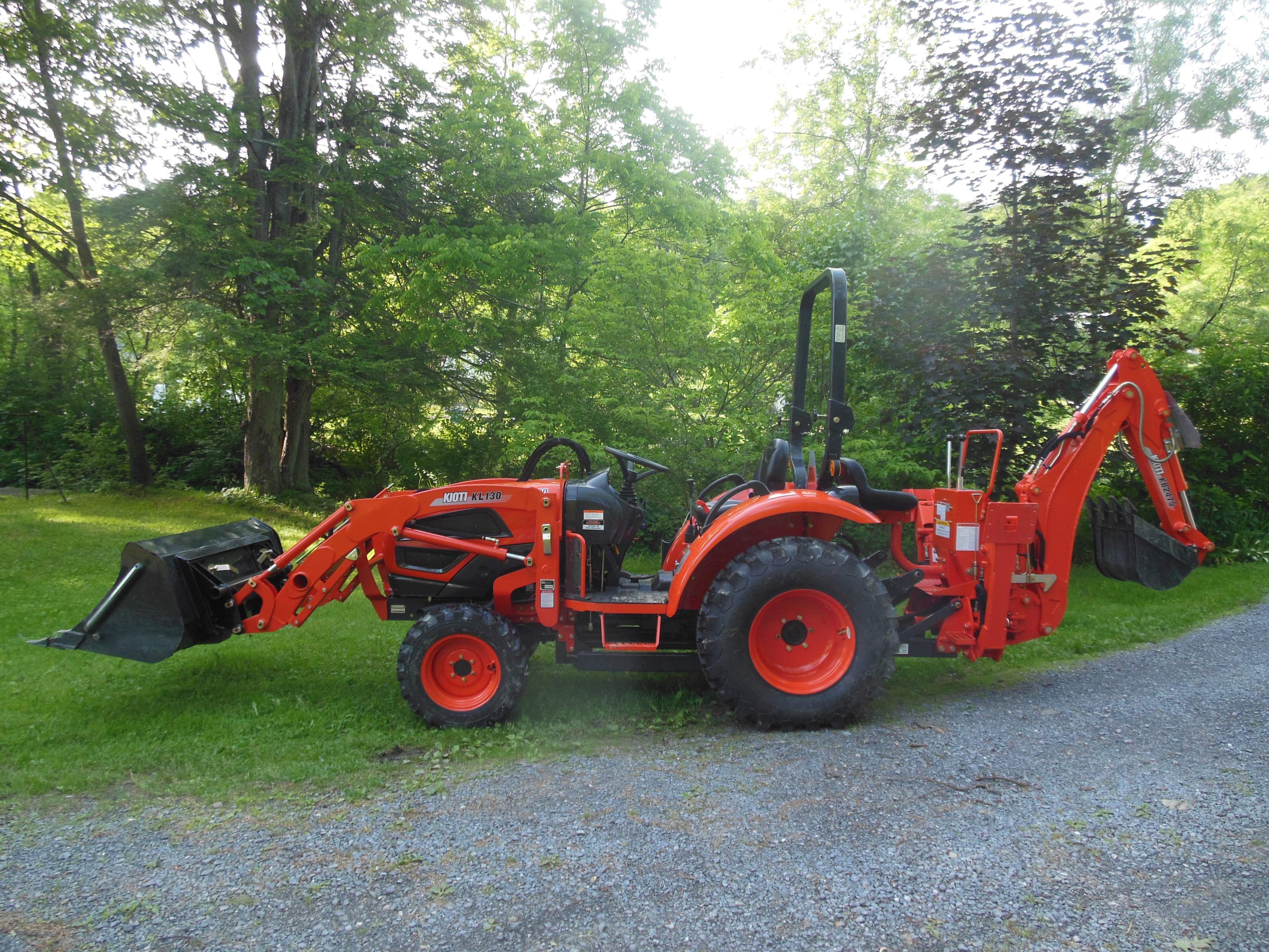

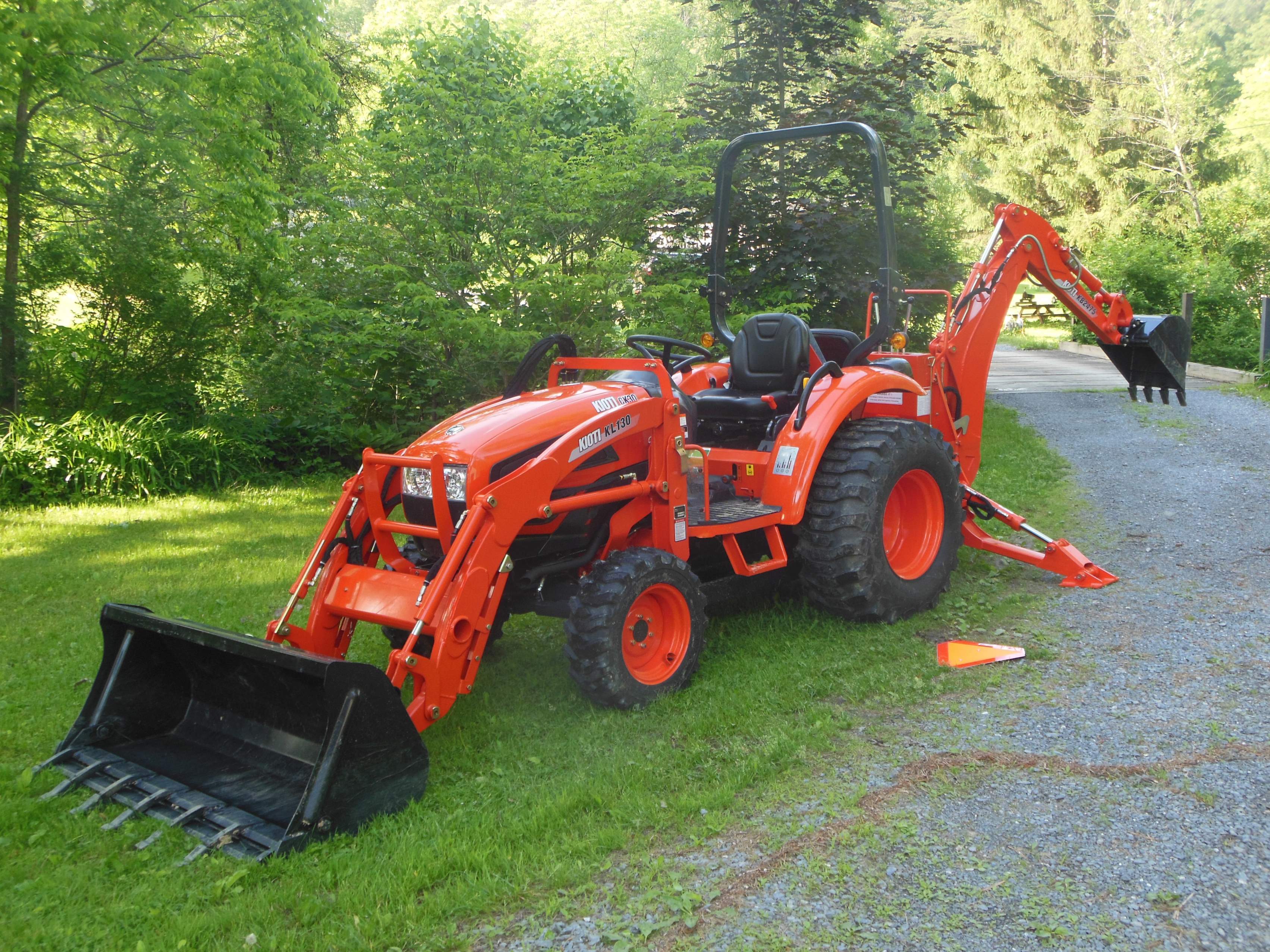

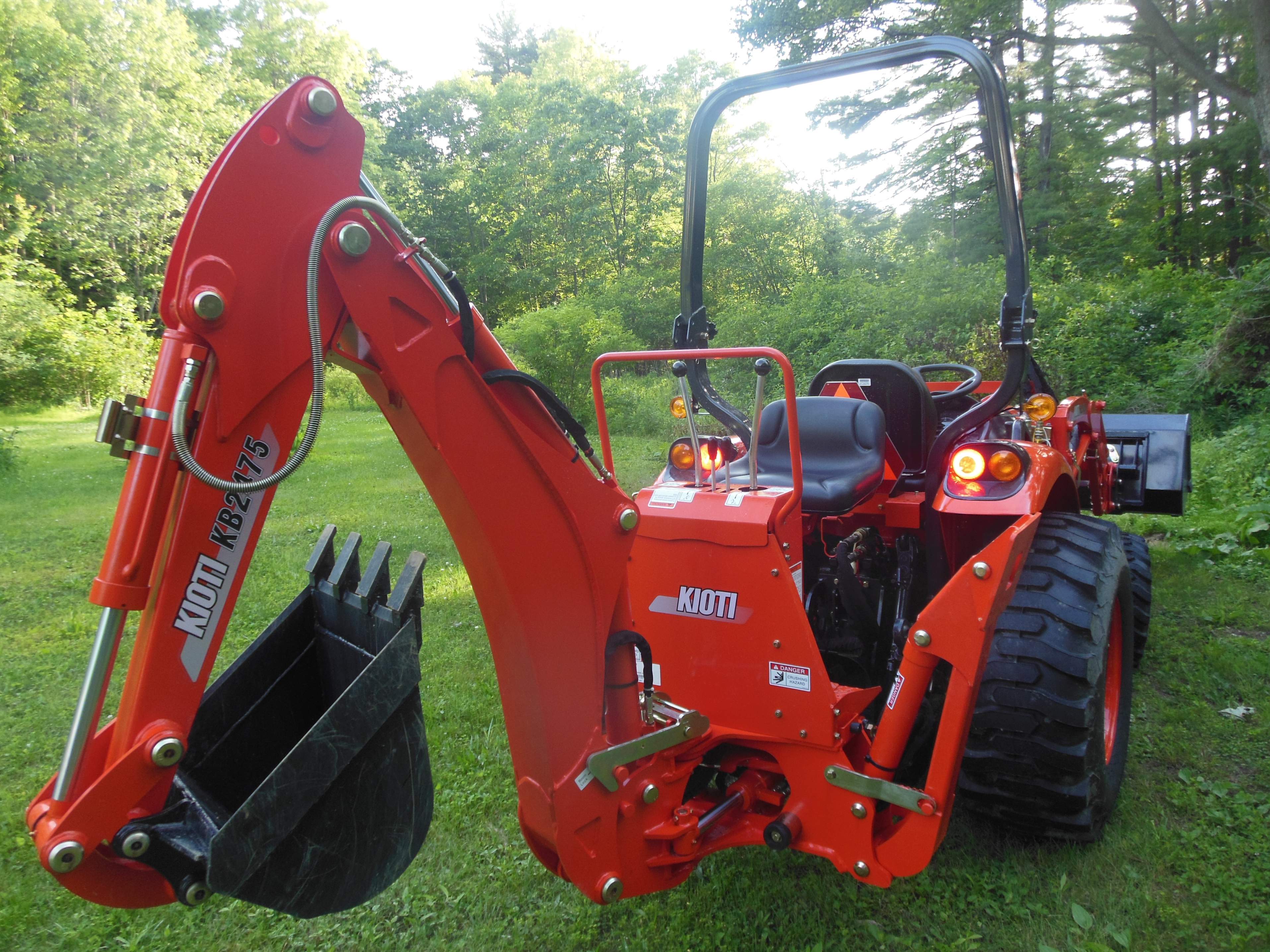

PS, Got the pictures taken of my ck30, but have to make them smaller to fit format. DSCN4261.jpgDSCN4265.jpgDSCN4275.jpgDSCN4280.jpgDSCN4281.jpg

Thanks again for all your help and hope you liked the pictures.

Well, that is kind of a puzzler.. The only time in my DK35se, I get any pulsing is when the RPM's are real low, and the tractor is just "dogging" around barely moving.. Cranking up the RPM's a bit always fixes it.. I don't know what the problem could be.. best contact the dealer. I do believe that the pedal on a CK series is direct connect to the swash plate and does not have the hydraulic connection that the DK series has. Having never spend any time on a CK series, I can't really add much real world experience. I liked your pictures, they were very well composed.

PS, Got the pictures taken of my ck30, but have to make them smaller to fit format.View attachment 430604View attachment 430605View attachment 430606View attachment 430607View attachment 430608
Your pictures are great man you see everything nice and clear.:thumbsup: I wish I would of had gotten a backhoe on my CK cause I could use one sometimes but not enough to purchase one. I myself still can't download pics on this site.:confused2:
