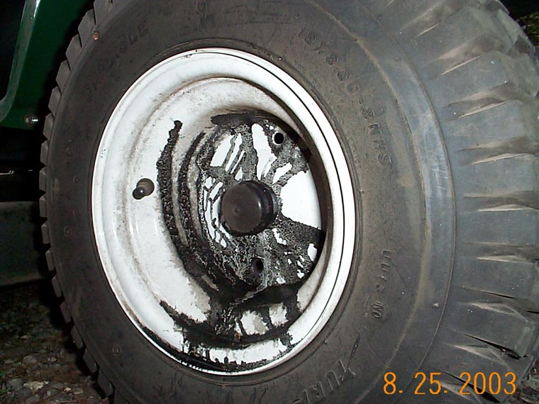

Here is a couple of pictures of my lawn tractors rear end. This happened 4 days out of the manufacturers two year warranty. Luckily it was only 4 days into the one year extended warranty I bought. Believe it or not that was the only time in my life I ever bought an extended warranty. The extended warranty company is making up their mind on whether to replace the transmission or "buy me out" (giving me the tractor purchase price money back). Have any of you ever had a hyrostatic transmission faliure on a small lawn tractor?

Pic 1 attached

Pic 2 attached
I went inside to get a fresh bottle of water and came out to get back on the tractor when I noticed the black fluid all over the tire.

Did the HST fail or just start leaking?

I would say "both". The repair shop said that the only solution was to completely replace the transmission. He said that trying to repair it was not the proper way to solve the problem. There is some reason that it started to leak in the first place. Now that it has leaked, dirt has gotten in there.

really, it looks like the bushings are worn, and that let the seals wear down, which then let the fluid out by.
i repaired the axle in the unit off of a craftsman ride on a month ago, and had to totally dissamble the unit to repair it.
honestly, i'd say that shouldn't be a hard fix, there's only one seal that keep the fluid in the rear end on each axle. and one at the outside end, to keep the dirt out.
