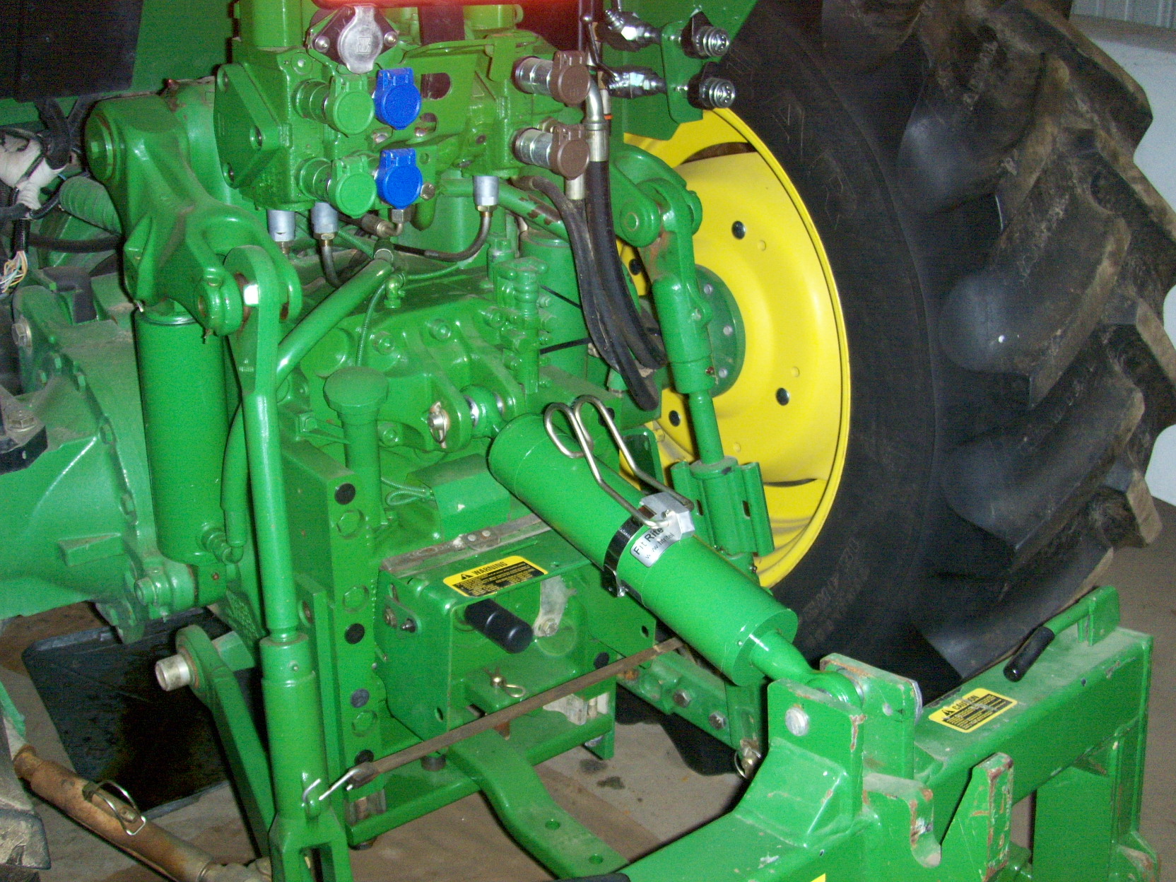

Thanks for the compliments! For those who asked, pictures, stored and connect to my CAT 2 quick hitch. Yes I still need to get the hoses on ;)

Yes, I do have the flow restrictor in-line. I was starting to worry if I was getting real weak or something. :)
Perhaps one day I'll wire up the right fender switch that is currently for raising/lowering the EH, to instead extend/retract the top link cylinder.
Did you TEE into your third function loader circuit for your toplink? Then I could see converting the hitch control switch (or just add another one) to operate the toplink. I considered doing that (teeing into the third function, but not adding the rear switch), but thought I might need float which the third function does not have. I was also concerned I could not feather the toplink using the third function electric valve. It's either ON or OFF
