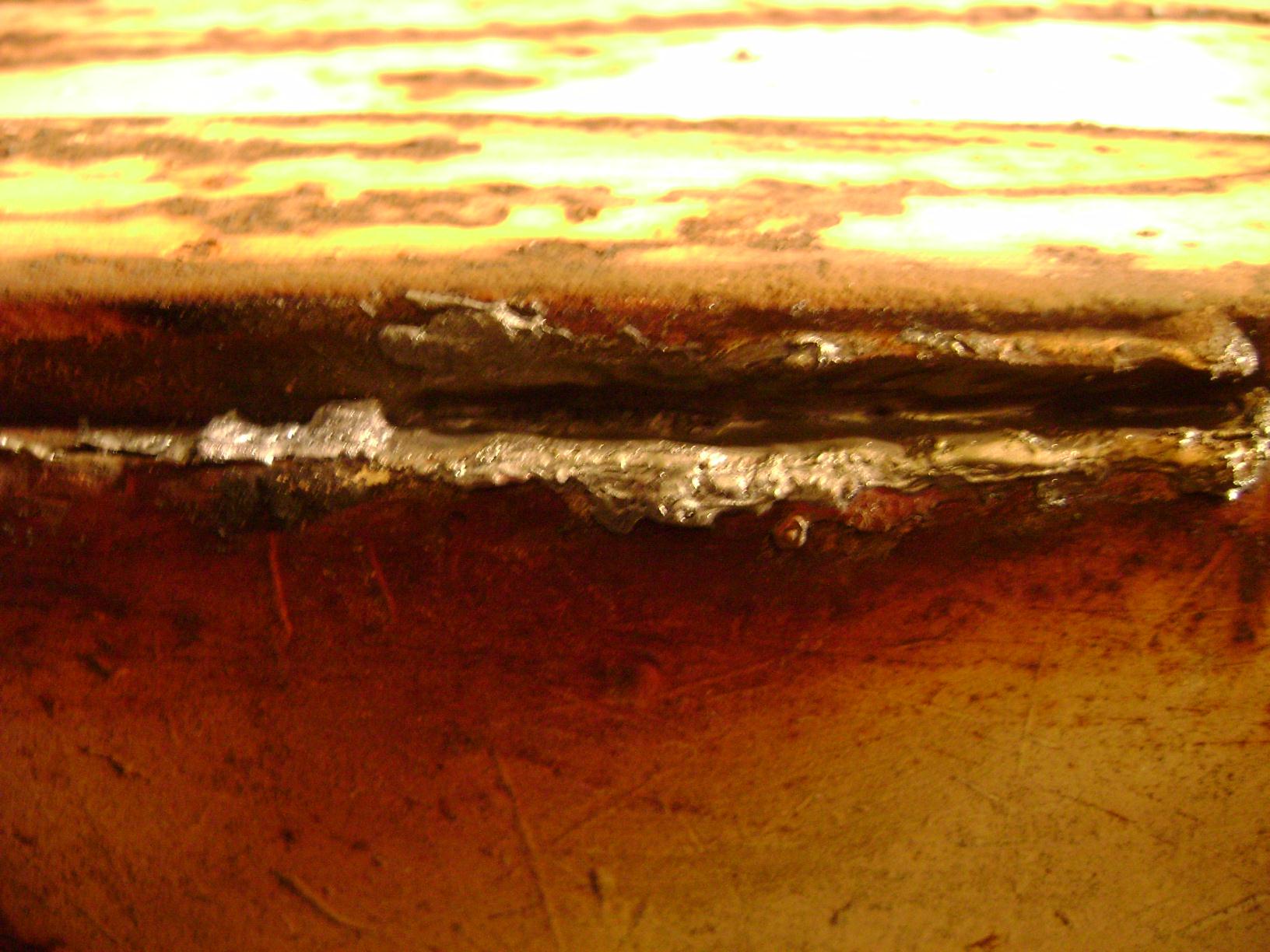

What I love about my Hypertherm 1250, is the scarfing option. It will scarf a weld out without
having to deal with the carbon deposits of carbon arc gouging. :thumbsup:
