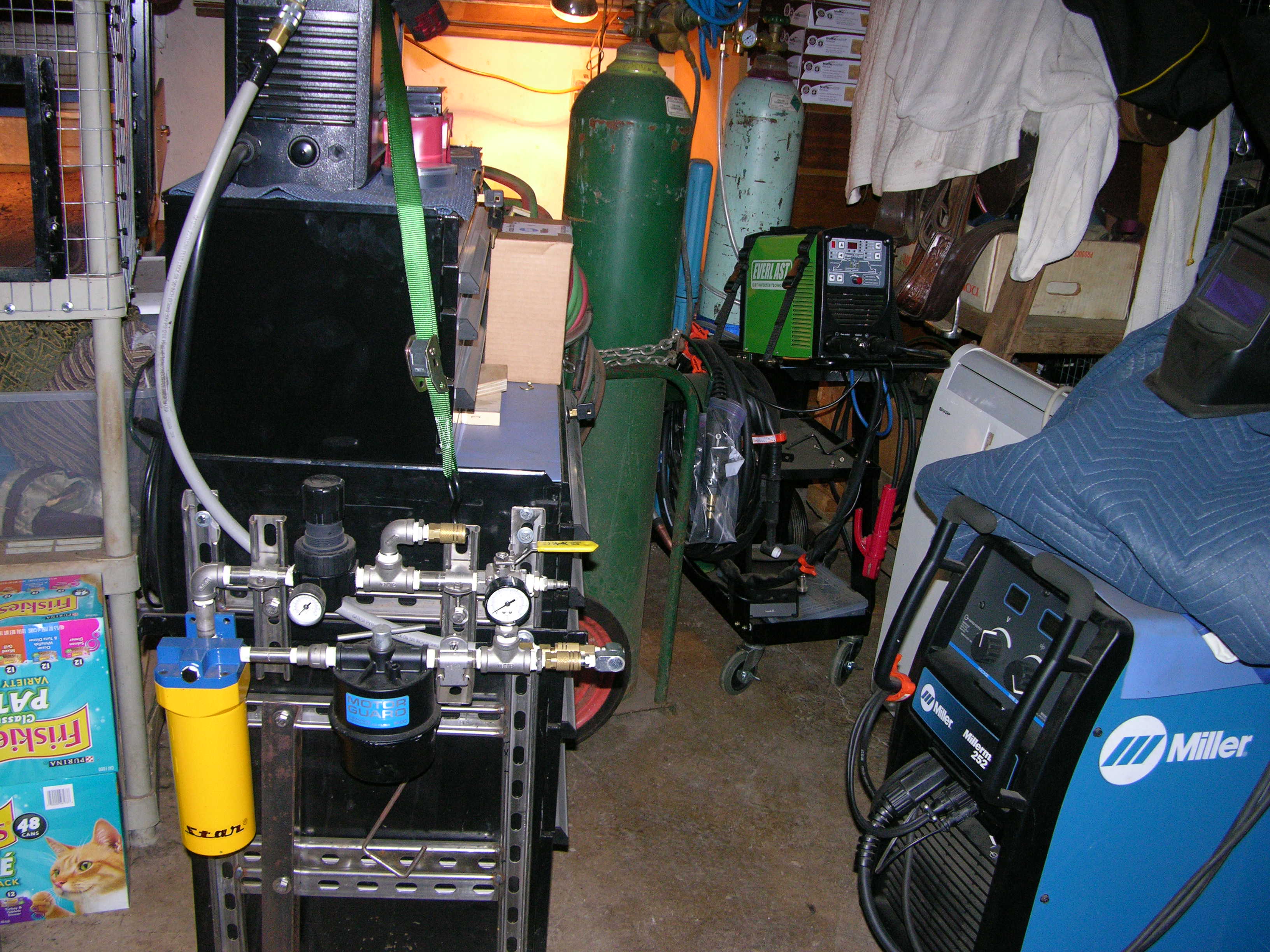

Dragon, I have one of those compressors (not currently in service) and there's a good chance it would keep up with the plaz - just be sure to do something like this so your air isn't killing consumables... Steve

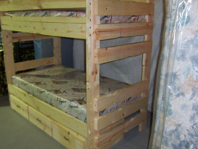

Mark, it looks like one of these is in your future:
Note bottom drawers for storage of welding and plasma consumables, AD hood, gloves, pajamas....
Terry

I've been using a DeWalt 15 gallon compressor and it keeps up just fine. I have moisture separator in the garage but when I used the setup remotely I can see a big change in consumable usage.
