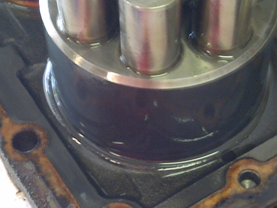

Remember he had a bad priority valve causing low charge pressure. Who knows how long it had been running with low charge pressure. The low charge pressure may have caused pump cavitations which can also cause wear.
Very true,
I would venture that his gear pump has a very large leak through the bronze thrust plates as well.
/ hyraulics question
#22
Tore down the pump, it looks like the day it was made. The whole rest of the HST does too. I am going to talk to the dealer this week and see if we can talk to Kubota about it and get their response.
It just doesn't seem right that this wear should have happened so early on. It also wasn't like I drove it a long time from when the chattering first occurred. It started happening less than an hour back on the engine clock. As soon as I noticed chattering under load I garaged it and only have run it when I was testing the pressure readings and replacing parts.

Matt-
if you have the pump back together do one thing fo rme to satisfy my curiousity if you dont mind;
put the pump on its side in a vice with the inlet side up and take a cup of the UDT or whatever you are using and pour it in the inlet side of the pump which is the larger port then:
wait for the oil to drip through. If there is more than a pencil lead thickness
of oil exiting the pressure side of the pump the pump is shot.
This is the quickest way to detemine if a gear pump is bad if you cannot flow rate it at a hydraulic repair shop.

My best guess about the failure is the charge pressure issue, followed by the fan issue. The charge tops up the unit, and accounts for it's ability to lubricate moving parts, and swap some fluid, which should have the effect of swapping some heat to the broader gearbox and making sure new fluid comes in with adequate lubricity.
It is possible that this was compromised causing increased heat and air entrainment, with "dieseling" of air bubbles resulting.

I can't tell from the pictures but are the ends of the pistons pitted or sand blasted looking? If yes this would be from cavitation which would point towards low or no charge pressure. Problem is some those little pieces of metal missing also went through the motor. Look very carefully at the port plate for any signs of scoring. Also check it for flatness. Check very carefully for any scoring between the kidney shaped ports on the rotating block also.
Roy

I did the oil leak test with the hydraulic gear pump as leonz recommended, filling it up with oil and looking for the leak rate on the back side. It was almost non-existant, with the oil coming through about 10-20 drops per minute so I think that's OK. Brought back visions on "days of thunder" when they looked at the wrecked car and said "hey, there's something that doesn't need to be fixed" and then robert duvall kicked it to make it perfectly ruined. Since it costs $600 I didn't smash the pump I just reinstalled it!
I also called bigorangeparts and the whole new HST was around $1400 (~10% lower than others I called). Jerkyboy, are you sure the bx1500 HST was only $500, that seems really low?
I also stopped by the dealership and they were amazed at the condition of the HST at such low hours. They put me in touch with the kubota tech support and they are opening a case file and customer support is supposed to call me. I'll keep you all posted.

I didn't buy anything yet. The gear pump that runs the implements, power steering and charges the HST was fine and doesn't need to by replaced, but looking at a few suppliers its $600 if it is toast. The HST itself is a hydraulic pump and motor. The price from bigorange was $630 for the pump that was shot in the picture I posted, or $1400 for the entire HST.
Also, to answer a previous question the image was blurry but the pistons themselves looked very clean with no pitting. I did see some very minor scratches on the surface below the HST pump and motor.
