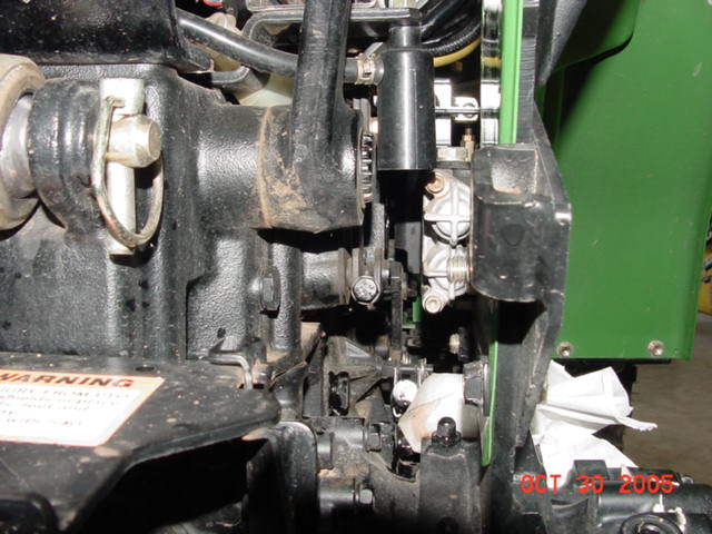

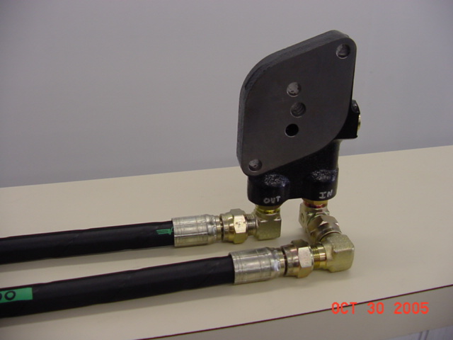

BTW: where does the power beyond connect to the 2520 hydraulics?
/ Hyrdaulics for Dummies
The stock ports are the ones to the lower right. If you mean where they connect to the pump, I think it's to the front of the hydro pump on the right side of the tractor - just in front of where the mid-mount hydraulic connectors ultimately lead if you can trace them back.
/ Hyrdaulics for Dummies #9
Let me help...
The PowerBeyond connects to a "block" that is sandwiched beetween the FEL control valve (DSCV) and the transmission.
See attached pics:D
