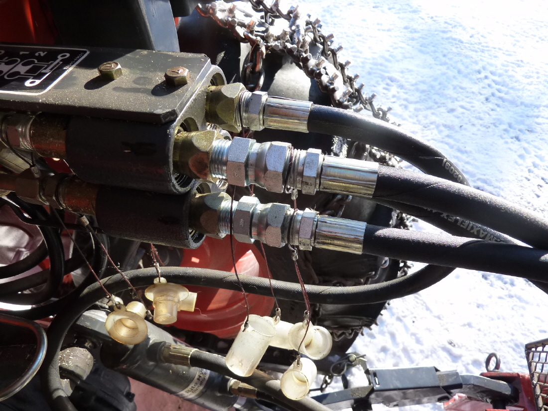

I have had my Fit Rite Hydraulics TnT system for about a year. It is a great tool and has really enhanced the
capability of any of my dirt working impliments. It took me a while to get the knack of making fine adjustments on
the fly but once I did I was able to a better job easier and faster. Which is more fun.
I had no flow restrictors in the hydraulic lines to the TnT cylinders. The hydraulic flow rate on my tractor is only
about 7 GPM. When the tractor was at idle speed the adjustment rate of the two cylinders was pretty reasonable
and I could control the blade adjustment while using a large range of valve opening, from just cracked open to full open.
However at work rpm's, I like about 2200 rpm grading on my geared tractor, the adjustment speed of the
cylinders was very fast because of the increased hydraulic flow at higher rpm. It took a very quick and soft touch on the control levers to be able to make fine adjustments. I used my ears too, listening to the valve for feedback and kind of anticipating when to release the lever. If I watched the blade and released the lever when it looked right I would be to slow and the adjustment would be to big. So I had to release the lever early. It sounds a little hard to do but like any tool you just get the feel of it after a while.
After seeing some discussion on TnT systems where Brian recommended flow restrictors I decided to try them. They are cheap enough so I had nothing to loose. I put the two restrictors on today. They are small in-line fittings. They add about 1.75 inches to the hose length. I put them between the male quick coupler and the hose end fitting on the line going to the welded end of each of the two TnT cylinders.
Just for a fun test I tried to put a crown on my packed snow driveway with a rear blade. Just as if it were dirt.
All I can say is WOW, what a difference. It is just so much nicer to have such positive control. I could actually
watch the blade move and release the lever when the blade was where I wanted it instead of trying to inticipate where the blade would end up when the valve finally closes. Because the hydraulic flow is restricted to a low level the ram speed of the cylinders is now independent of the engine rpm's. It is nice and slow all the time.
In hind sight, if I knew how controlable making adjustments with the flow restrictors would be I would have
never said that I did not feel the need for them. Which I naively believed. I think they are a serious improvement.
At least in my case.
This was my experience and I thought I would share it.

What I tell people is that yes you can guess as to where it will end up if you don't have the flow restrictors, but with the flow restrictors you can adjust it to where you want it. They usually make such a difference that it is almost hard to believe. :thumbsup: :thumbsup:

We used restrictor fittings extensively in the fold systems of tillage and seeding equipment some of which were 60' tillage width and had to fold vertically in several sections to roading width. The rule of thumb was to put the restrictor directly on the cylinder fitting to provide a degree of safety in the event of a malfunction such as a hose burst. The initial purpose of the restrictors in this application was to control the speed as well as the sequence of events during the fold process. Today's larger farm tractors are capable of 30 or 40 and even up to 60 or more gallons per minute of flow at 3000 psi so it's imperative for the manufacturer of the attachments to control that tiger. Many of the tractors have electronically adjustable flow rates but the operator is relied upon to utilize them.
I can see where the restrictors are very useful for precise adjustment of top and tilt cylinders as Gordon, the OP, demonstrates above.

Just to give an idea how fast a cylinder retracts I did the following scenario:
2" bore cylinder with 1" rod at 10 GPM will move approximately 16"/second.
(2" bore is 3.14 square inches and 1" rod is .785 square inches leaving 2.355 square inches of area when retracting the rod. 10 GPM is 2310 cubic inches per minute divided by the 2.355 area and then by 60 seconds/minute)
Briefly feathering or tapping the control valve will, of course, slow the cylinder down.
