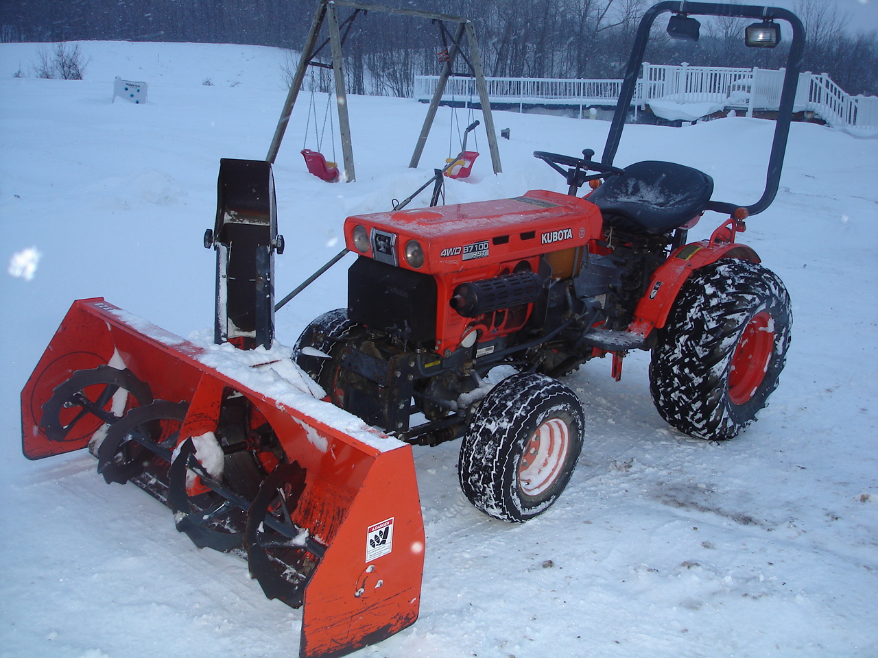

Well here it is. I think I have talked the little woman into it. And I did not even need to buy 1 rose, let alone 11! Thanks anyways.
One thing I made a mistake on is that it has F4 tires not turf. Will I still need chains on a blacktop driveway?
And also how many hours of in between a major service? (not just oil change I will do that myself)
If I end up buying it I want to thank all of you who replied. I let my wife read all the replies and I think that is what did it.
Bitts

Welll a early Congrats to you bitts.
Not sure if chains would be needed if your driveway flat...try w/out...sure hate to see your black top scar. :(
If you don't have operator manuel,I could email you the info your seeking.
