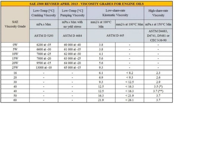

Wrong. The lower temperature oil rating is not determined at room temperature. It's at various temperatures, generally very cold and is different for 0w, 5w, 10w, 15w.
5w30 is NOT 5 weight oil. It is 5w at its measured low (cold) temperature but is 30w at operating temperature of 212 F. And so on for the other oils mentioned. The second # is the operating temperature of the oil. The first # is the weight at some cold starting temperature, which is different for 0w, 5w, 10w, 15w.
Those upper temperatures for each oil are for air cooled engines, not water cooled ones.

   / I apparently don't understand oil weights #18
Here's the chart that shows what temperatures the lower # of oil viscosity is measured at. It's a rotating viscometer that measures in cP (centipoise or poise) vs. the upper (operating temperature) value that is measured in cS (centistokes) @ 100 C (212 F).

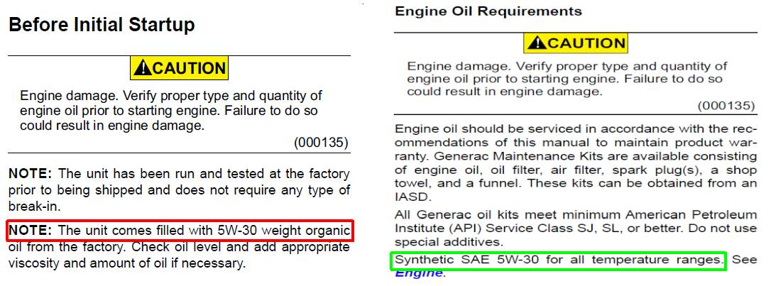

This is from my generator Install (left) and Operator's (right) manuals. If 5W30 is supposedly only good below 50F, why are they spec'ing it for all temperature ranges?
Also note, they supply 'organic' oil, but recommend synthetic.
