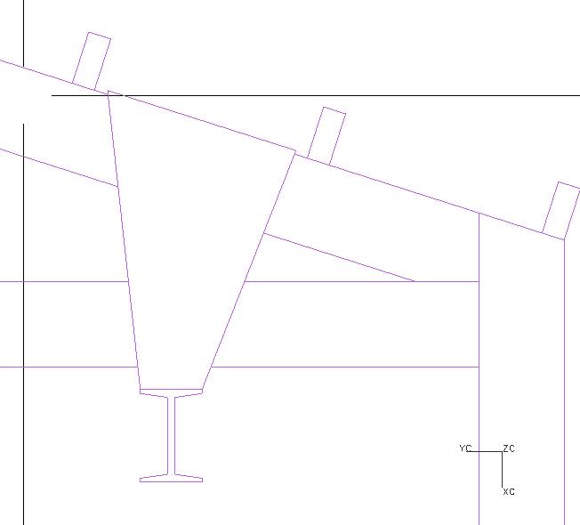

Also Doc, you were probably gonna do this anyway but fabricate a hangar to rest on the top chord of your truss and reinforce truss with plywood sheathing on both sides.
Looks like you ceiling is 9 or 10'? do a stack up of beams, gaps, trollies and hoist headroom to make sure you can lift the stump to the lathe bed height and drillpresses and such can clear as you are moving the load around.
You can extend the bridge beam beyond the 24' O.C. trolley beams to get hoist near wall, just weld a stop on the end.
have fun.

   / I Beam flex??? #28
The formula for a deflection of a beam supported on the ends with a centered load is: (Force * length^3) / (48 * E * I)
E = modulus of elasticity
I = moment of inertia.
For structural steel, E = 29 Mpsi
I is calculated from the dimensions of the beam
I looked in a book for standard I beam data. There are 2 sizes listed for both the 4" and 6" I beam.
a) 4" beam with .193 thick web - I=6.08 in^4
b) 4" beam with .326 thick web - I=6.79 in^4
c) 6" beam with .232 thick web - I=22.1 in^4
d) 6" beam with .465 thick web - I=26.3 in^4
Putting the numbers into the formula:
(2000 * 360^3)/(48 * 29E6 * I)
This reduces to:
67/I
Therefore using the I values from above:
a) 11.02 in
b) 9.87 in
c) 3.0 in
d) 2.54 in
Clearly neither the 4" or 6" beam will meet your 3/8" max deflection requirement.
Using the reduced formula above, and 3/8", and solving for an I value: 67/I = .375, we get I=178.7
I went back to the beam tables and looked for the minimum sized beam that had an I value greater than 172. The minimum sized beam that will meet your requirements is a 12" beam. The book I have lists four different web sizes for a 12" beam (.350, .428, .462, .687). Any of these will work.
The dimensions for the .350 web beam are:
Flange width = 5.0 in
flange thickness = .491 in
I = 218
Its designation is S12 x 31.8.
This beam weights 31.8 #/ft, therefore 30 ft = 954 # beam.
If you really want to use the best 6" beam from above, we can put all the numbers into the equation and solve for max weight at 3/8" deflection. The answer: 294# is the max weight you could suspend at the center and have 3/8" deflection. -- Not a very useful crane.
You may need to look at the supporting 4" beams as well, to make sure they can take all the loads.
