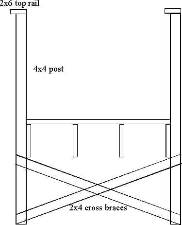

I have never seen PT 5/4s. I would still use 2 x 12's . I would put the crown side of the board up, and use 4 deck screws at each beam. Drill pilot holes at the ends of the decking boards to prevent splitting. Pilot holes are optional in the center of the decking. I haven't seen the shrinkage that others have seen, but then I am just an amateur carpenter.
I think your next challenge is going to be to make the railings on the bridge "feel" sturdy enough against an outward push. The attachment shows a design I have used on a similar bridge to greatly increase the stiffness of wooden railings.
