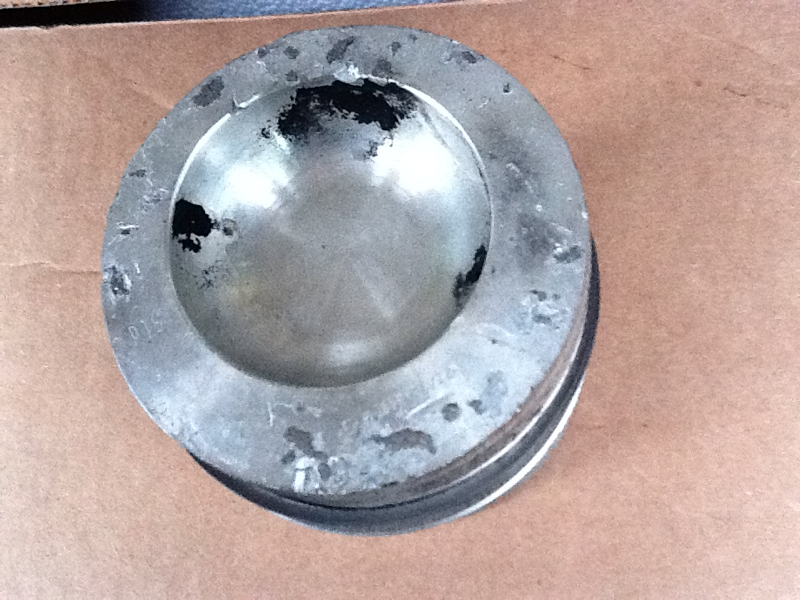

There are two pins that hold the triple hole top link on. One solid pin at the spring and another connected to the rear center housing. most of the time PB Blaster and pound them out. The hollow center pin I'll usually use a similar size socket or pipe the same size. It was hollow so the long pin could run thru it. Might require some heat. Carefully swing the hammer so you don't bust the ear on the housing. It looks ok from the photo, not sure why you need to take it off? The bracket below it is for a sickle bar mower. If you don't need it you can sell it. There would be no reason to reinstall it.

Thank you, I already tried pounding it, but nothing moved so I thought id better ask :)
the triple hole toplink has a busted ear and I want to replace it, its only holding on 1 ear so it wobbles around and I think if I attach something to the 3point it could fully break and do more damage to other things

just curious.. why do you want to remove the 3 hole rocker?

here is a better picture:
that's why I want to remove it
   / i bought a 8N #66
once you get it off, just weld it..
