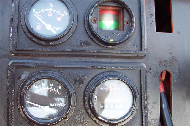

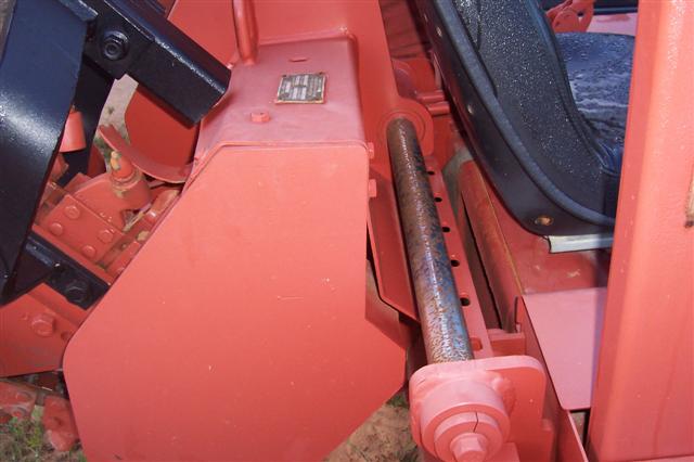

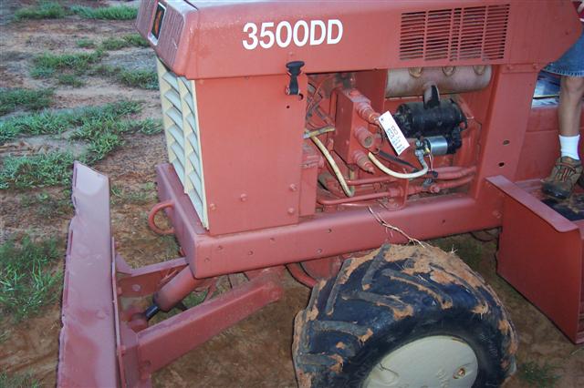

Last Saturday I went to the local auction hoping to buy a grapple that they had there. It ended up selling for way more then a new costs, so that was a waste. While wating around for the grapple to come up, I found a Ditch Witch 3500 DD with 1,720 hours on it. The front tires are worn, but the backs look almost new. It had just been painted, so that made me nervous, and it wouldn't start. I went and looked at some other stuff, but wanted to check out the Ditch Witch again. It was gone. I looked around and found where they had moved it. So now I know it starts, I just had to figure out how. It turned out that the safter switches to be in neutral are out of adjustment and you have to get them just right for it to start. When this is right, it fired right up!! There was no smoke and everyhing worked. The chain spun, it went up and down and the blade was able to lift the front end off of the ground and keep it there. I drove it a little and couldn't find anything serioulsly wrong with it.
This wasn't and isn't something that I really need right now. I've seen similar machines sell for $8,000 to $10,000 depending on age and condition. I figured that if I could get it for half of that, I would be a fool not to buy it. At $3,000 it was me and one other bidder. At $4,000 he quit bidding and it was mine.
It has the Duetz Diesel engine, but I don't know how many HP. It's missing a few teeth, but I don't know anything about them or if it needs all of them. I've searched on ebay for a manuel, but so far haven't found one. The engine and filters were painted over, so I'm going to replace them with new ones. I have two small projects for it sometime this year, but other then that, it will just sit for a few years until I'm done with my dirtwork and ready to start installing my underground lines. Then it will be almost non stop!!!
Any thoughts or suggestions?

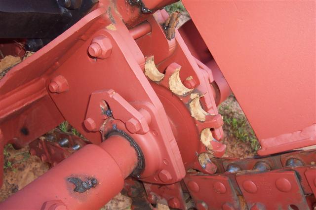

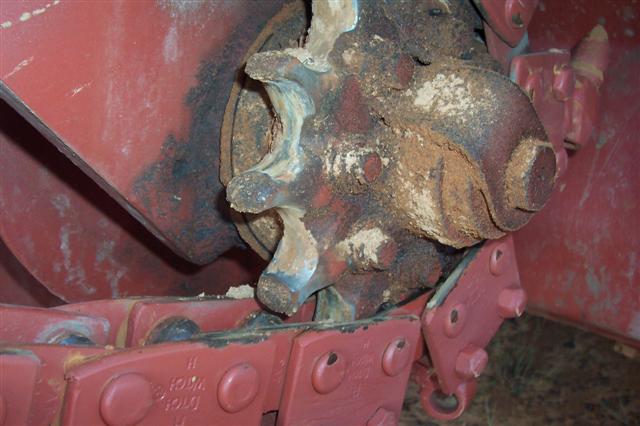

Eddie;
Great find on the Ditch Witch. I have an old J20 that I refurbished. All of the wear parts are still available. You won't be able to wipe the grin off your face when you dig your first long trench. Your drive sprocket looks fairly worn and it looks like your chain is set up with rock teeth. Don't worry it will still dig fine. Good luck.

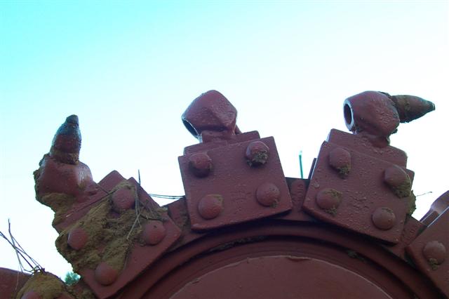

The big appeal for me with Ditch Witch is the dealer is just a few miles from my home. It is the very closest dealer of any brand to me!!! He said that he could get me a manual for free in a few days, so that was a very good sign. One thing that I didn't know, or realize, is that it's an air cooled diesel engine. The radiator in the front of the engine is for the hydraulic oil!!!!
I replaced all the filters for under $90. The hydraulic oil looks dirty, so that's a concern. Engine oil looks fine, but that's just a personal opinion.
Didn't know about the rock teeth and that the chain was set up for rock digging. The blades for digging clay are $14 each and I think I need 40 of them, but I'm not sure how many it's actually supposed to have and if I need to buy new bolts and spacers for each blade.

the teeth should not be that much they just drive in the cup they have a spring pice on them that looks like a roil pin. The only trouble would be if they ran it with out and ruined the holders. never saw any that were marked for just clay we have two different types at work the only difference is the carbide tip is round or has a slight point on it

No direct experience, but the mulchers have posted issues with the oil cooled duetz overheating and failing. Just a thought to keep in mind. May never happen as you won't get that dusty, but....
/ I bought a Ditch Witch !!!! #13
I wouldn't worry too much about the Deutz in this app. They're used as irrigation power units around here all over. Just keep the grills clean and the oil changed regularly.
They typically last a LONG time if maintained. I've heard of units with 30,000+ hrs on them with only regular maintence and minor repair.
I speculate the grills/fins get covered by debris and dust in a mulcher and the thing overheats.
/ I bought a Ditch Witch !!!! #14
The air cooled Deutz series were the 912 and 913 series... these were simple and cheap to rebuild, and lasted a lifetime... They were built from 1964 ?? untill TIER 1 era, however Deutz kept selling the 712 and 812 as well during the early '70s.
The current generation of Deutz oil cooled engines (1011, 1012, 2012) are like Chinese mopeds: they are underbuilt disposables and prone to premature failure.
Keep some clean oil in that Deutz and it'll run forever... ;)

Eddie:
Good buy on that trencher! But I think your DW dealer is gouging you if he's charging you that much for teeth. The dirt cups (the curvey 1/4" thich ones that are worn out in your photos) should be $5 or $6 max. Even a rock tooth is only around $10 or so.
Since you bought it at auction, here's what you need to do:
Change engine oil / filter
Change hyd. oil / filter
Change air filter
Clean out around oil cooler on engine
Check out the bearing on the end roller of the boom - if it's got play in it - replace it while you can, if the bearing wears long enough you will have to replace both it and the roller. Very costly.
Replace the worn out dirt cups on your chain. Your chain itself looks to have some life left in it - the sprocket is in bad shape, but there's no sense in replacign the drive sprocket until you replace the chain. Don't be surprised if you have to replace it within 100 hours.
