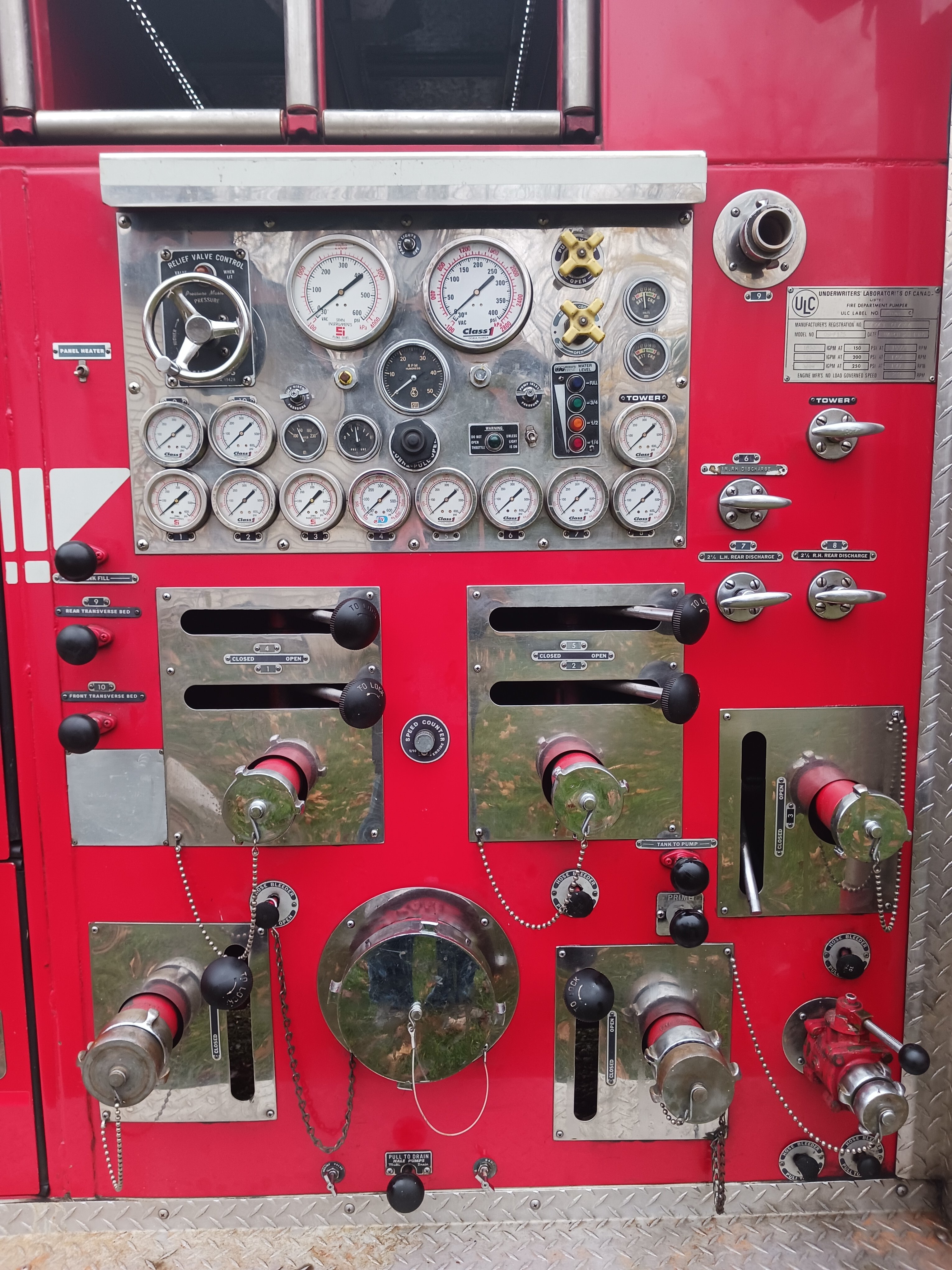

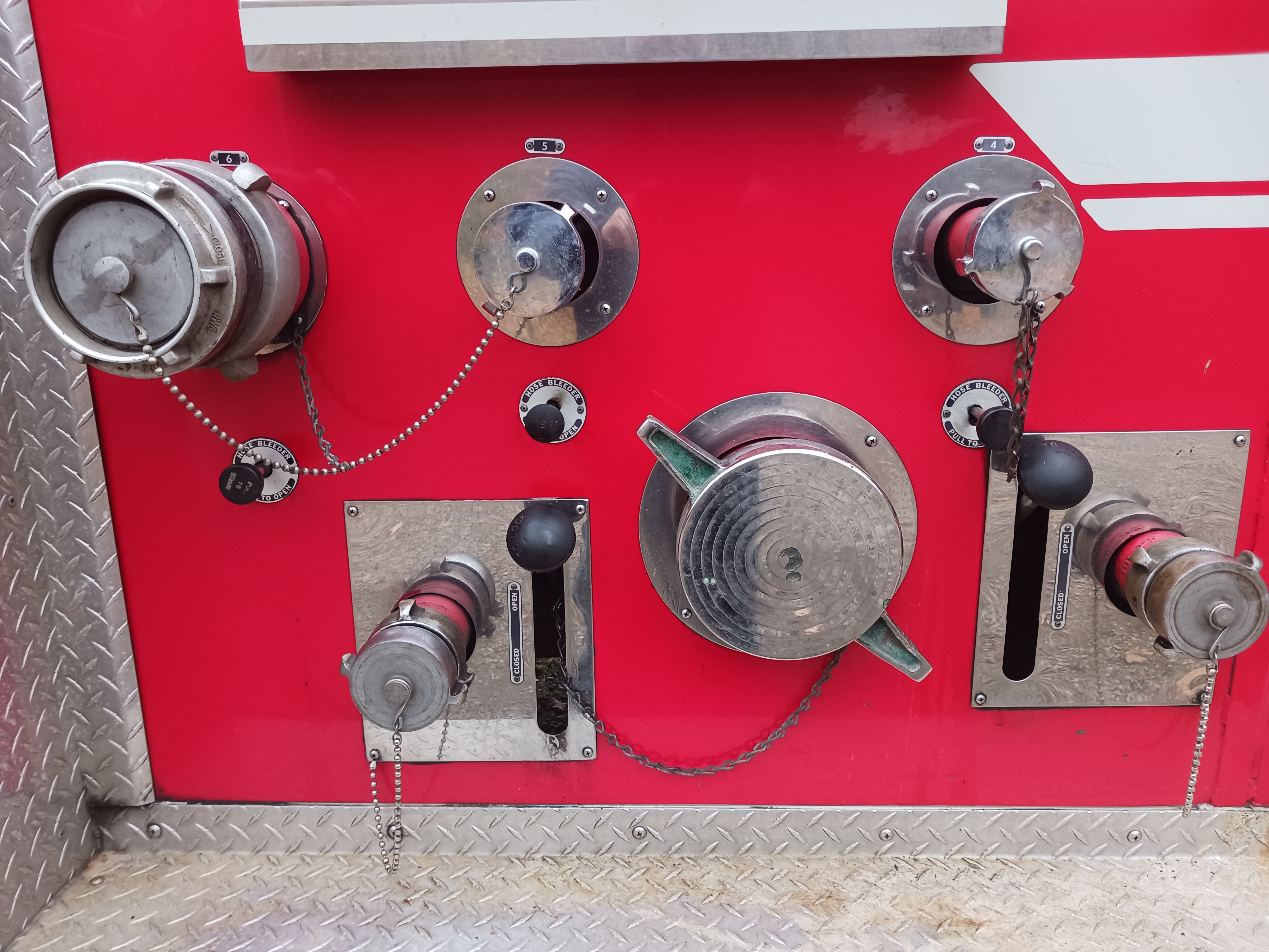

I do know how to operate the PTO to engage pumps. Engage in neutral, once light comes on, shift Allison transmission to drive (but never do until I have valves open)
So lets start with the basics. How to fill.
Here are all my controls and valves.
Talk to me in dummy terms, LOL
How would I fill it?
I see most everything is numbered.

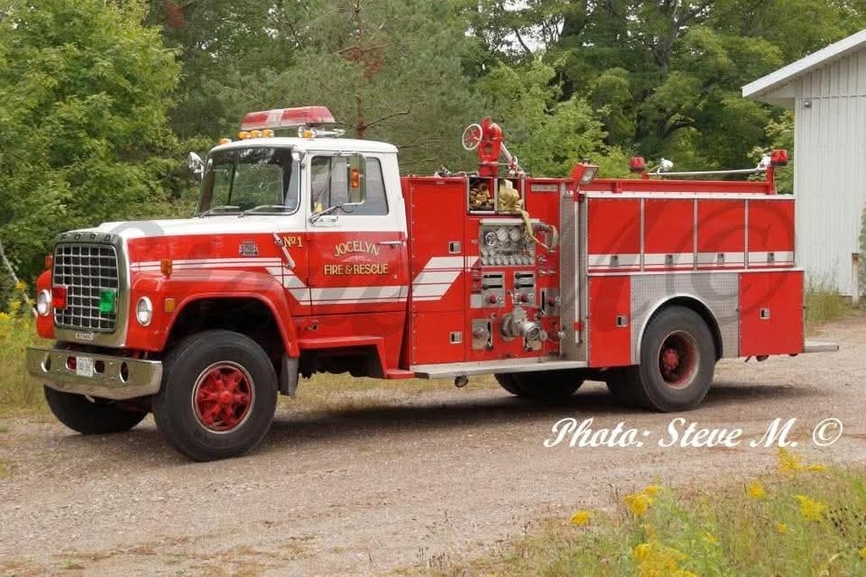

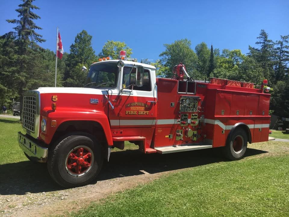

As a bonus, here are some pics sent to me on facebook of it back in 2019 and it's twin that is also in the area. Credit to Greg and Steve for the pics.
The first thing I would do is get a fitting to go into the pump to pressurize it with water off a garden hose. This can be most easily be done removing one of the 1/4" test ports on either side of the RPM gauge.
Watch for leaks. You can also test the gauges for function by opening the valve with a cap on the port. You should see both of the large white gauges rise equally as the pump pressurizes.
Be patient, it may well take a few minutes to fill the pump before you see the pressure gauges rise. There is nothing in the pump that will be damaged by garden hose pressure. You will be charging both the intake as well as the discharge side of the pump as it is a centrifugal pump.
