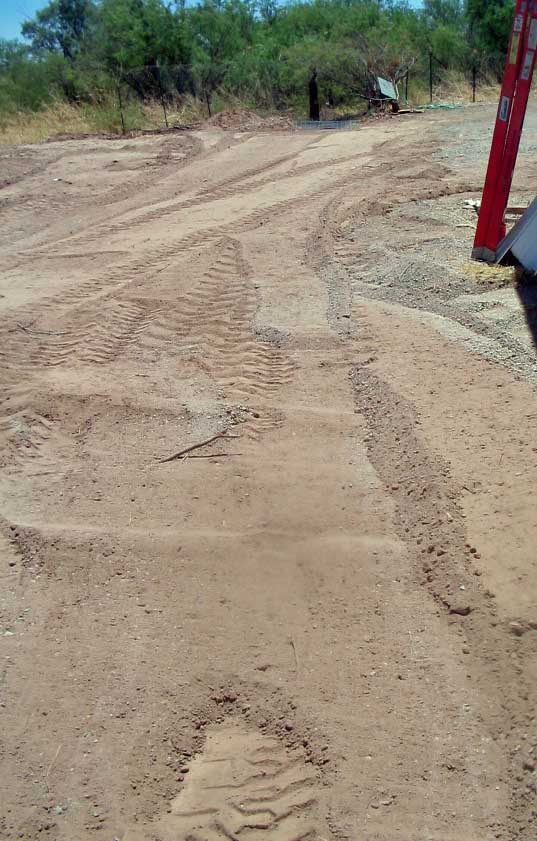

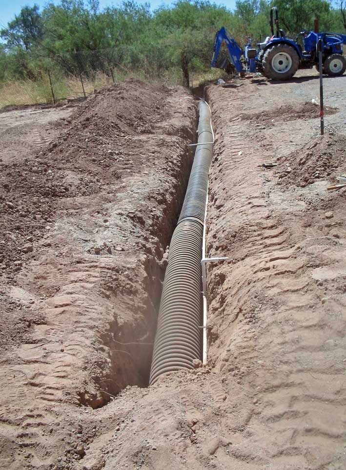

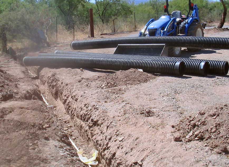

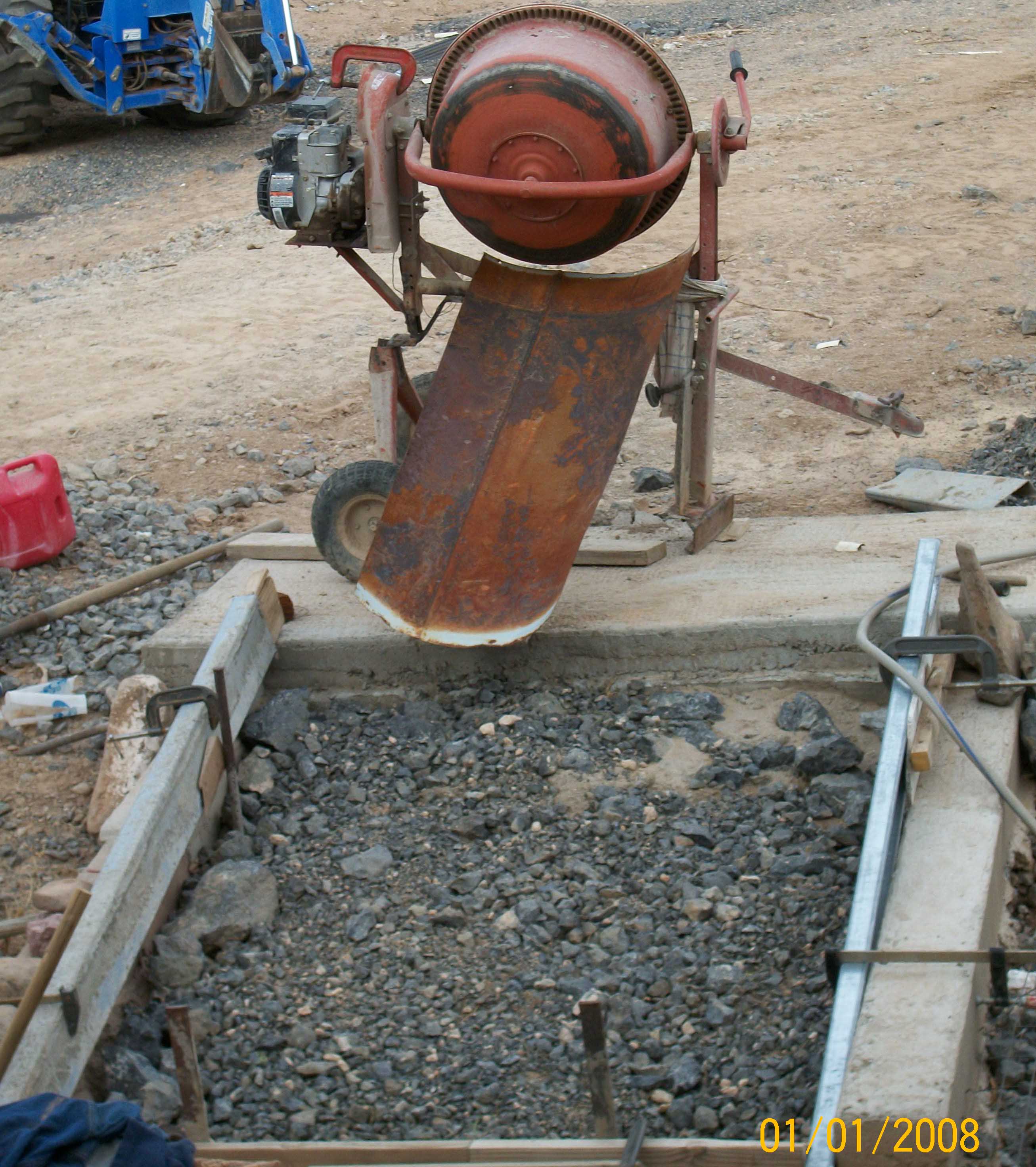

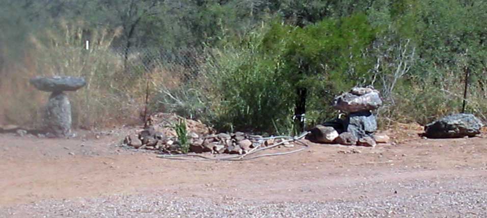

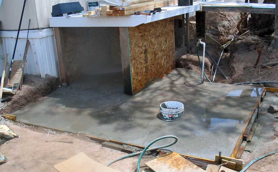

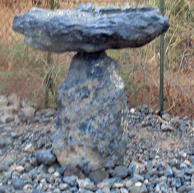

I do lots of building, always making some kind of a mess. 97.37% Is all done alone. Like help with cement work, but do that alone when needed. Everything shown in the pictures was done without help. The drain pipe goes out by the green bush in the last picture.

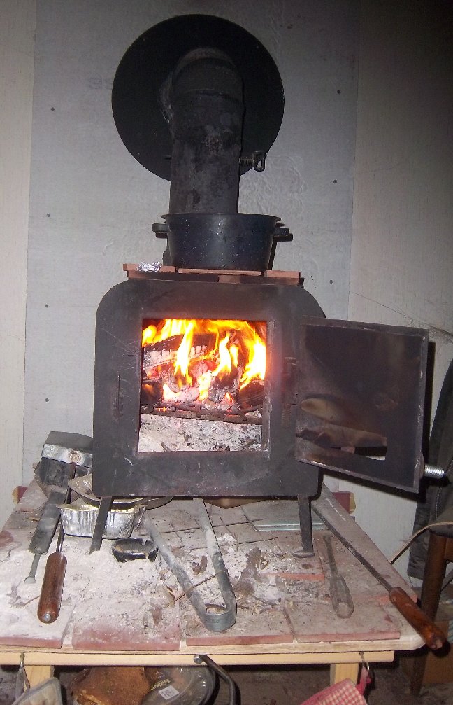

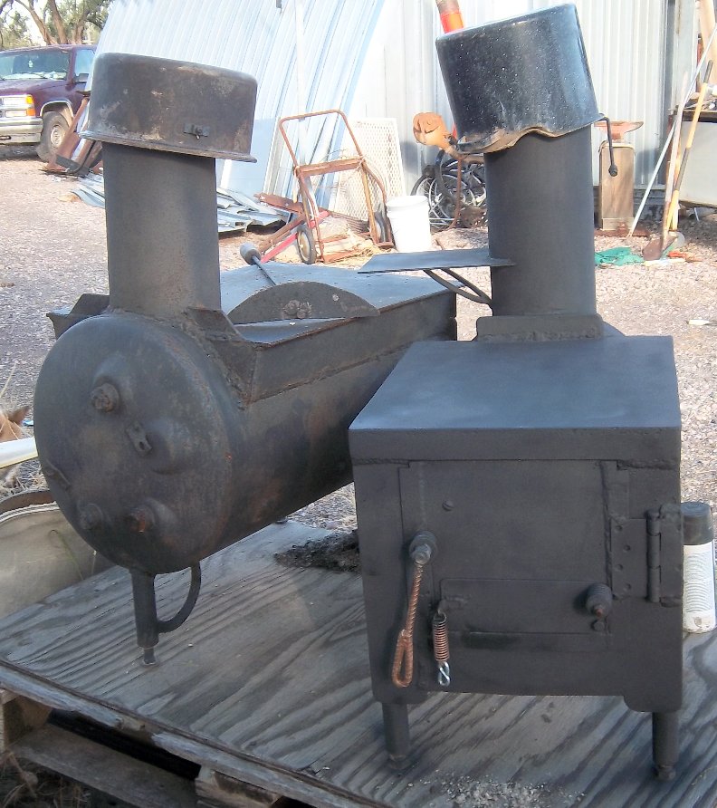

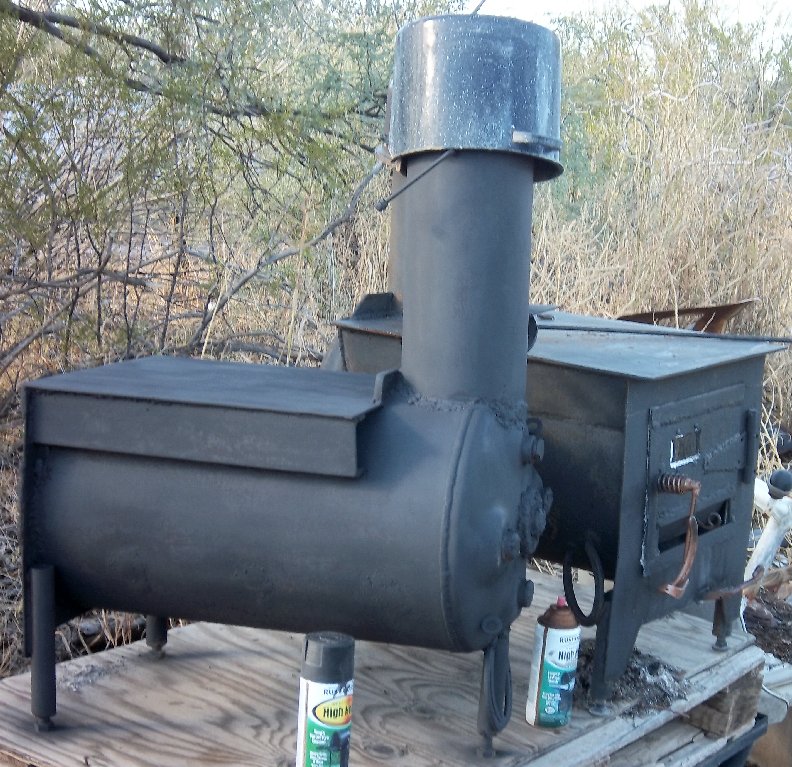

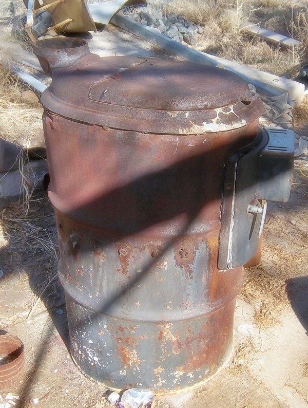

Here are couple of wood stoves that I built last year.
   / I Build "UGLY" #55
Time to revive this old thread & have some more fun.
You folks must have built dozens of things by now.
Show Off A Little
View attachment 300895 - View attachment 300896
I built one like your water heater stove on the left, for my parents. Top load lid was a bit heavy though. It work very well for years.
   / I Build "UGLY"
#56
I looked at some plans for a top loader and decided that was not the way to go. Most of them leak smoke and when adding wood, that is not the best way to go.
   / I Build "UGLY" #57
Yes, that is an issue. I didn't have too much of a problem building one that didn't leak smoke, a matter of flat and parallel construction, but sometimes wisps of smoke would come off the lid/door when open. I think it was because of the lid heating up and soot on the inside surface. They found it easier to load then a more traditional front loader. My current stove loads from the front.
Your stoves look like they should work well and give years of heat.:thumbsup:
   / I Build "UGLY"
#58
My little original stove is on its forth year and 2 others similar that I built for neighbors are on their 3rd year. I heat about 900 Sq. Ft. with it and have to make sure its turned way down in order not to over heat the place. (Over 80). The heavy pipe going into the stove extends into the stove 1.5". that keeps the heat in a little better. The doors are fairly tight and sealed around the outside. I call them "semi air tight.
The newer ones pictured also have a baffle across the back 1/2 of the stove that keeps the flames from going straight up the stove pipe. I can cook on mine, but it heats fairly slow. The 2 new ones have a lot more of the flat surface exposed directly to the flames. Better for cooling. The stove pipe damper is also a fairly snug fit. Once a good bed of coals is established they can go 3 or 4 hours with out wood and will give off heat for 6 or more hours. The pipe coming out is 1/8" wall & 7" ID. Small stove is sleeved down for 6 inch.

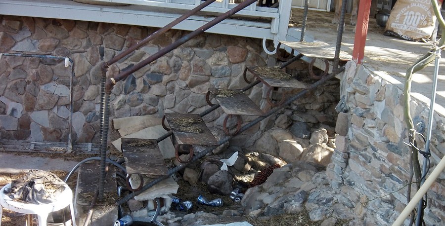

Time for a little more fun & ugly stuff.

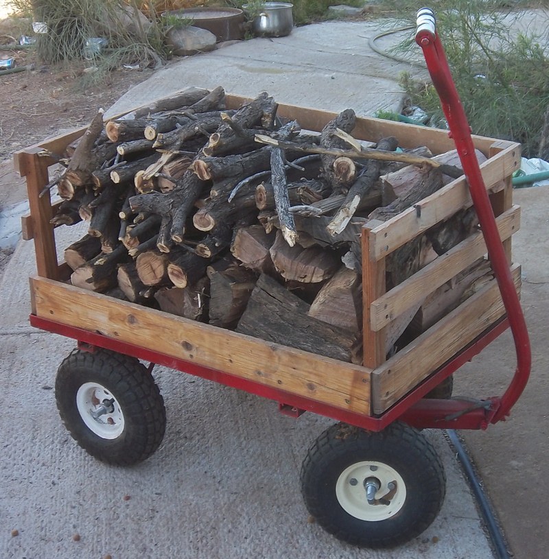

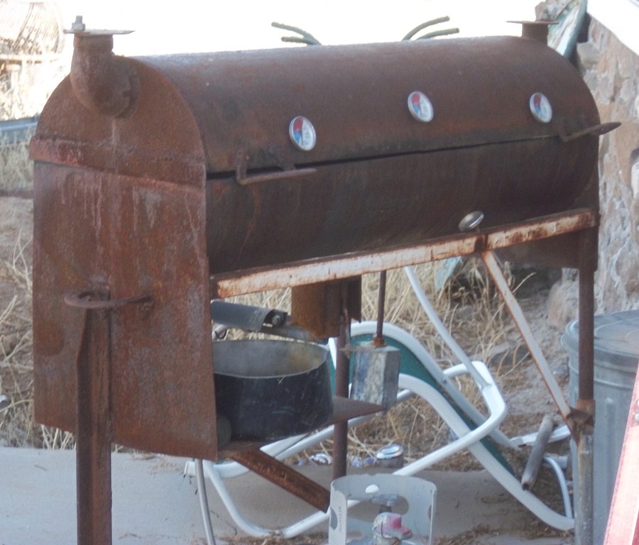

fire 2.jpg - mail box.jpg - out door stove.JPG - red wagon.JPG - smoker.JPG - stairs.JPG
