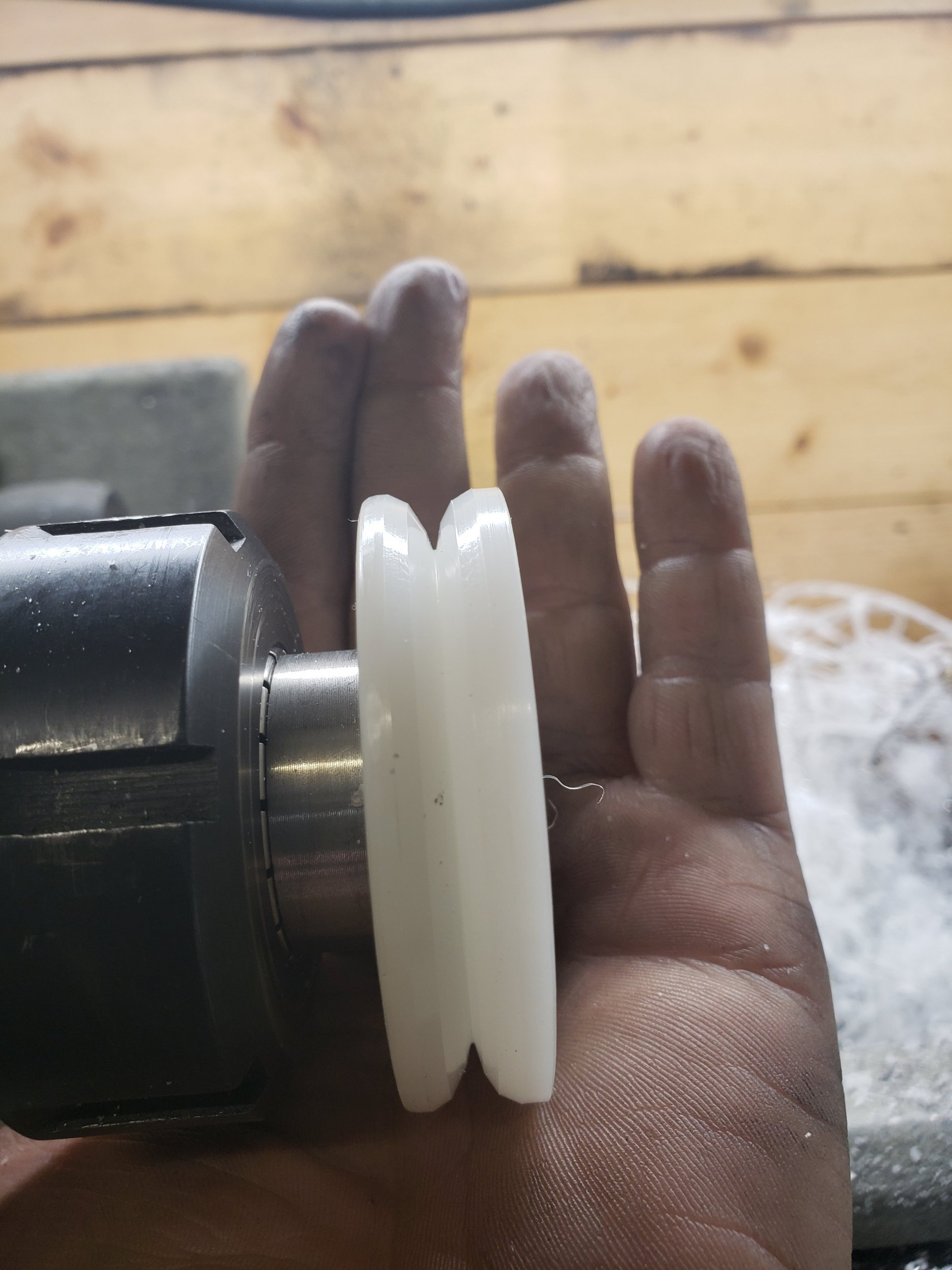

A question, though.....
Why doesn't the diamond wire cut through the pulley's on the saw?
(scratches what's left of the hair on my head).
It's abrasive cutting so requires relative motion (slippage) to cut. Same reason your tires aren't (immediately) cut through by the abrasive highway, my pulleys aren't (immediately) cut through by the wire. Start doing burnouts though, and that goes out the window. There's no relative motion between the pulley and wire, I made sure of it. I made these pulleys out of UHMW (cut/abrasion resistant plasic - same thing cutting boards are made of) and machined them to a specific profile such that the wire is drawn down deep into the pulley and pinched from two sides for maximum traction.
And I designed the pulleys in such a way that they offer their own dust protection to the bearings so that I could remove the dust shields from the bearings (those dust shields cause a lot of drag). Also flushed the grease out of the bearings and used light oil instead. They spin like a top now, takes a couple minutes for them to stop spinning when the wire breaks.
All that said, I have cut through a couple of them. One of the problems with the saw is lack of rigidity, and that allows vibrations to happen in the saw and in the wire. There's some anomaly that (I think) happens when the wire vibrates at a frequency that coincides with the RPM of the pulley, and it ends up wearing unevenly. Like "cupping" on a tire of a vehicle that has alignment issues. It ends up wearing through the plastic on one side only. It took about 10hrs of run time before this first happened.
