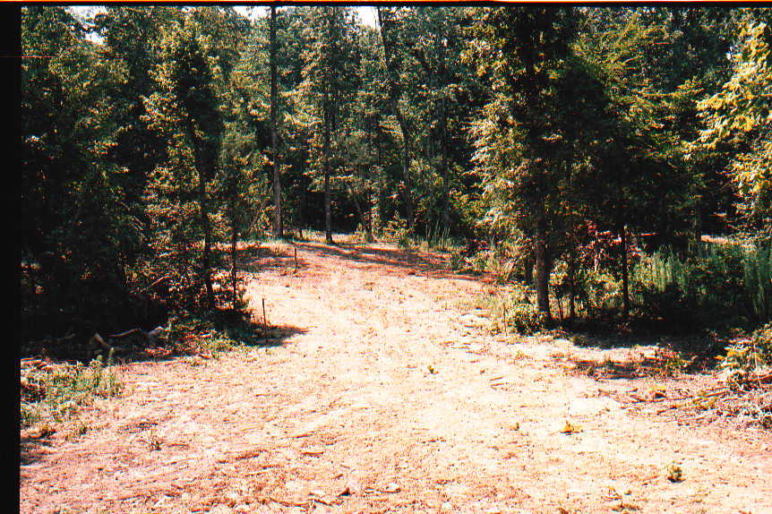

   / I built a driveway.
Here is what the driveway grade looked like after about
6-8 30+ inch hardwood stumps had been pulled. I have a
picture of the stumps but I can find them.
This is the driveway where it intersects the private road.

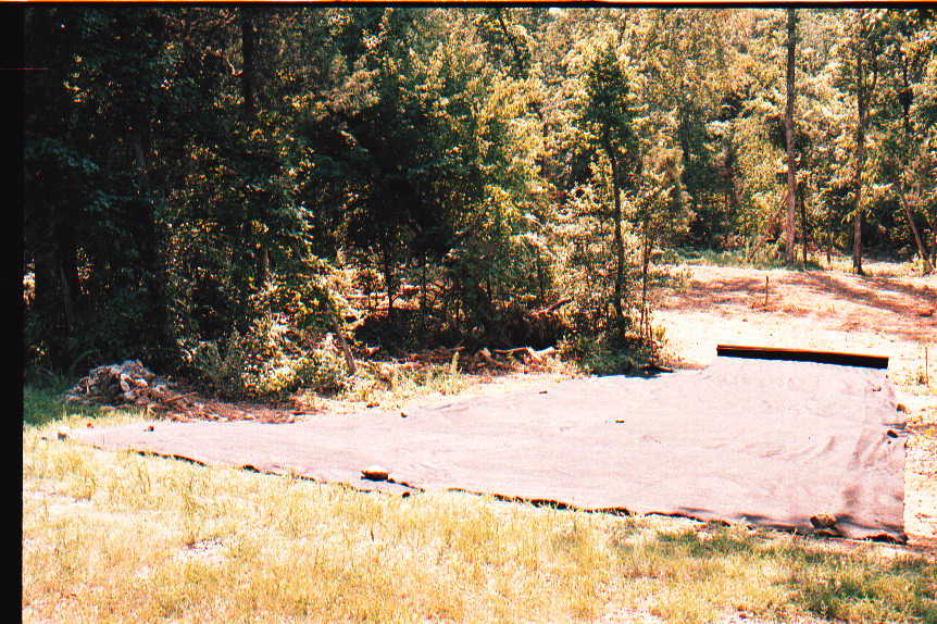

Same spot but with the fabric laid out. This is two lengths
overlapping to get a wedge shapped area to turn into from
the road.

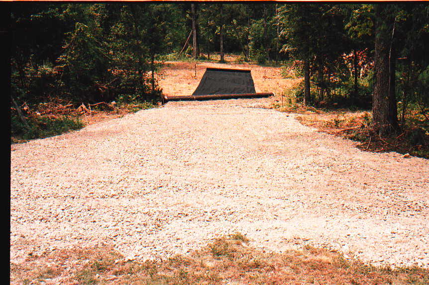

Same spot, different angle and better picture! /w3tcompact/icons/smile.gif
This is two loads, about 16 tons of ABC. The trucks backed
up on the fabric with out any problems. It was the only time
that the trucks went on the fabric. This area was smoothed
out real well. A few hundred feet up the drive, driving trucks
on the fabric would have been a bad thing.
Each load would be about 5-6 feet tall about at least 13 feet
wide.

Same spot with about 4 loads, 64 tons on the fabric.
The culvert is in place. There is a gap that is not apparent
between the ABC and the culvert. Just ran out of gravel
at that point.
I thought about trenching down 6 inches or so to get the
culvert a little lower. This would have saved me a load of
gravel but in the end I decided it was not worth the work.
The culvert sitting on grade was at just the right angle to
have the water flow. If I trenched down I would have spent
alot of time getting the angle just right.
We have had some good down pours, I got caught in one and
watched the water interact with the road and culvert. Every
thing works fine. At least so far! /w3tcompact/icons/smile.gif

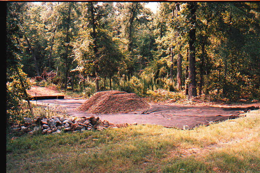

This is taken 25 feet on the driveway and with the culvert
covered. The driveway is going off to the left and about
to make a right hand turn. There is something like 6 loads
of ABC, about 100 tons, to get to and over the culvert. The
left curve to the right turn took another two loads.

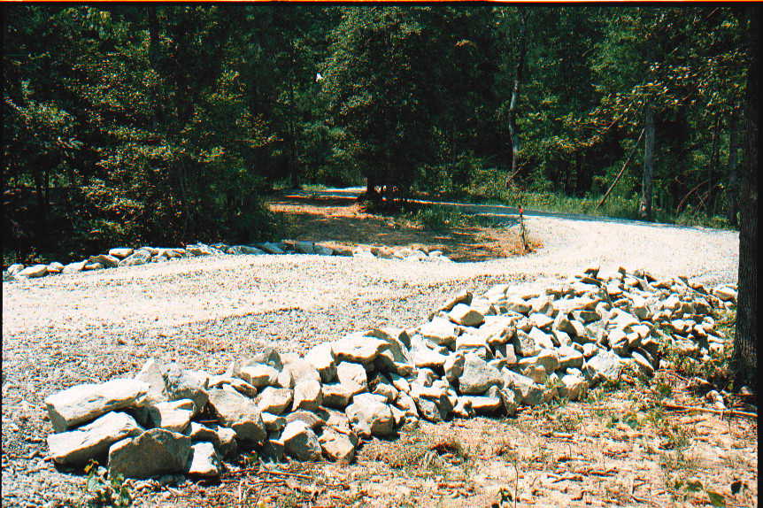

Moving a few feet to the right and about 16 hours in work
time in the future, this is a picture of the road that was
all but finished graded and with about 10 tons of rip rap
installed to stablize the road bed. From grade to the top of
the driveway is about 24 inches.
