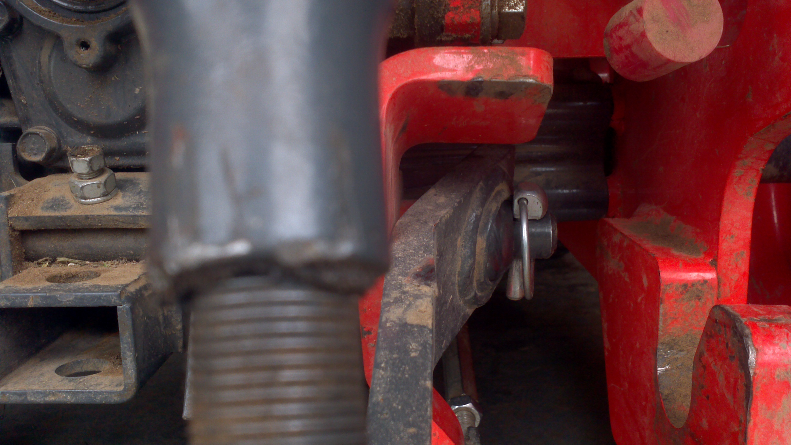

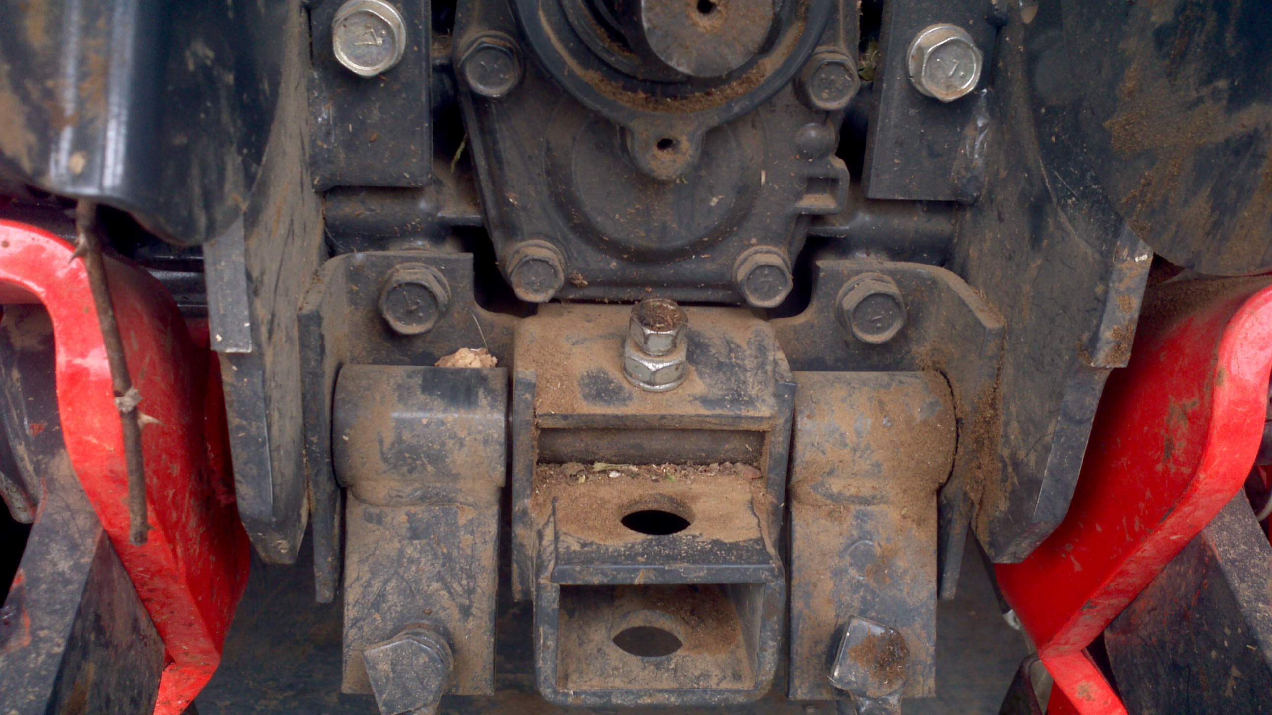

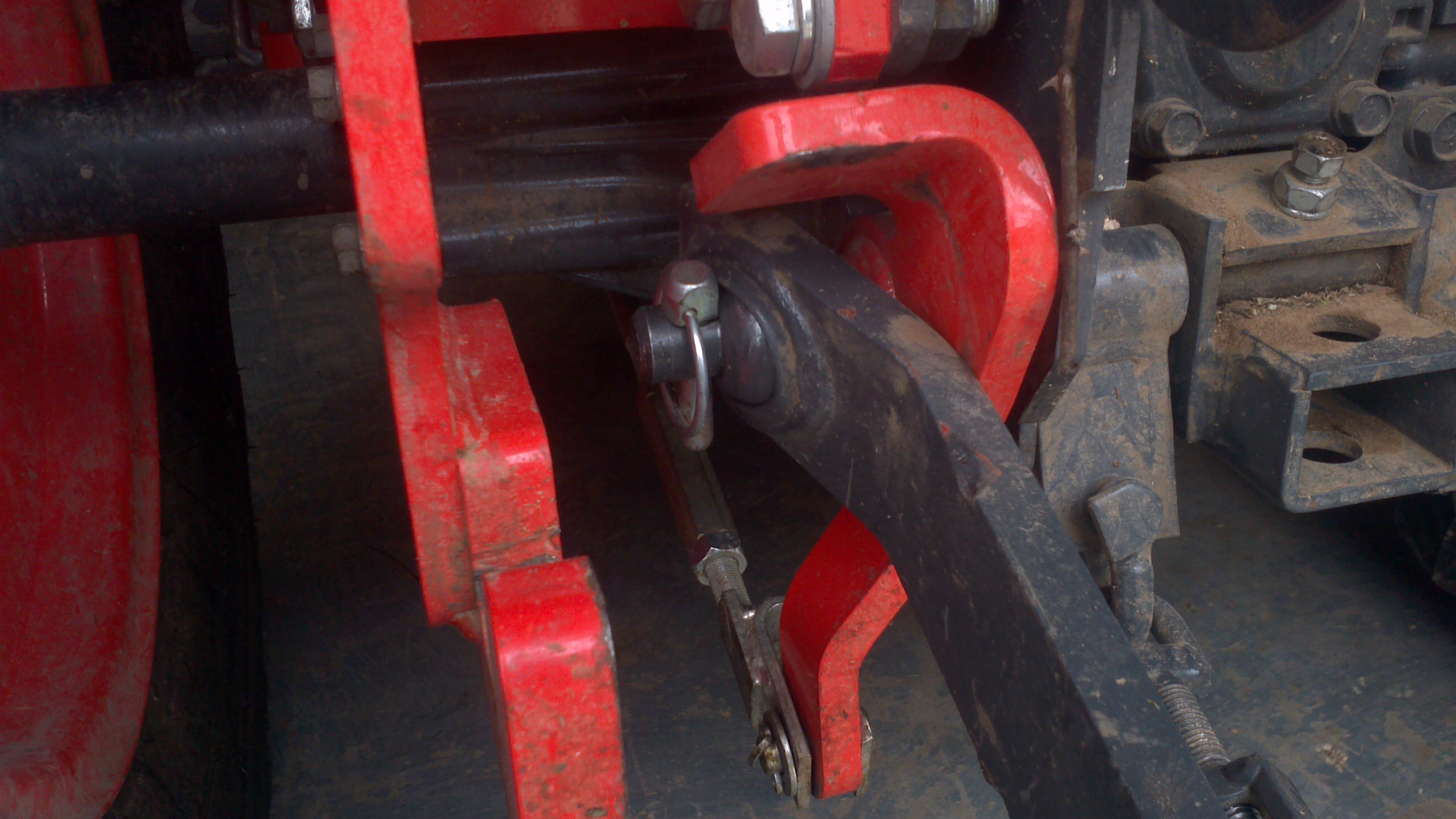

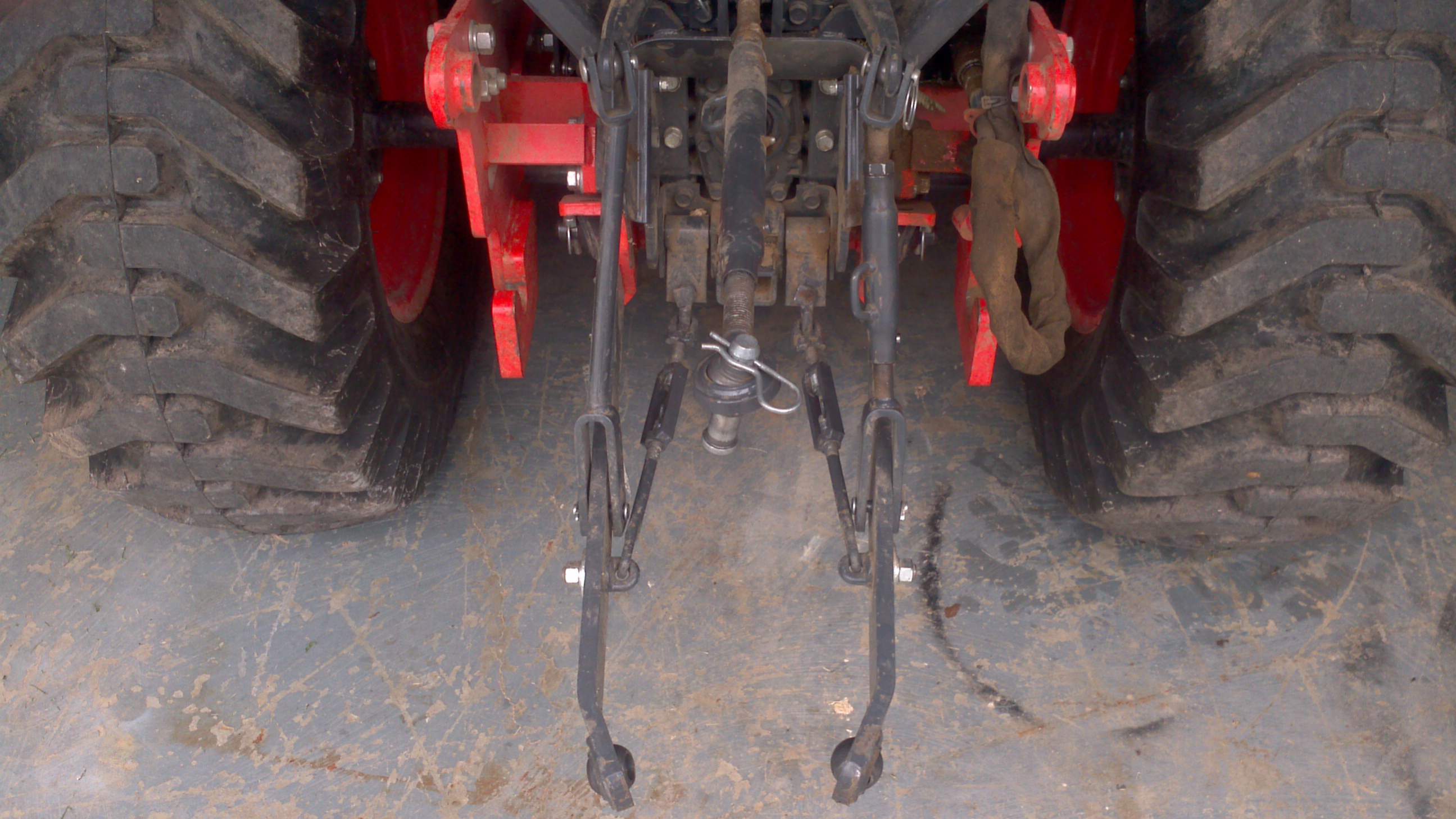

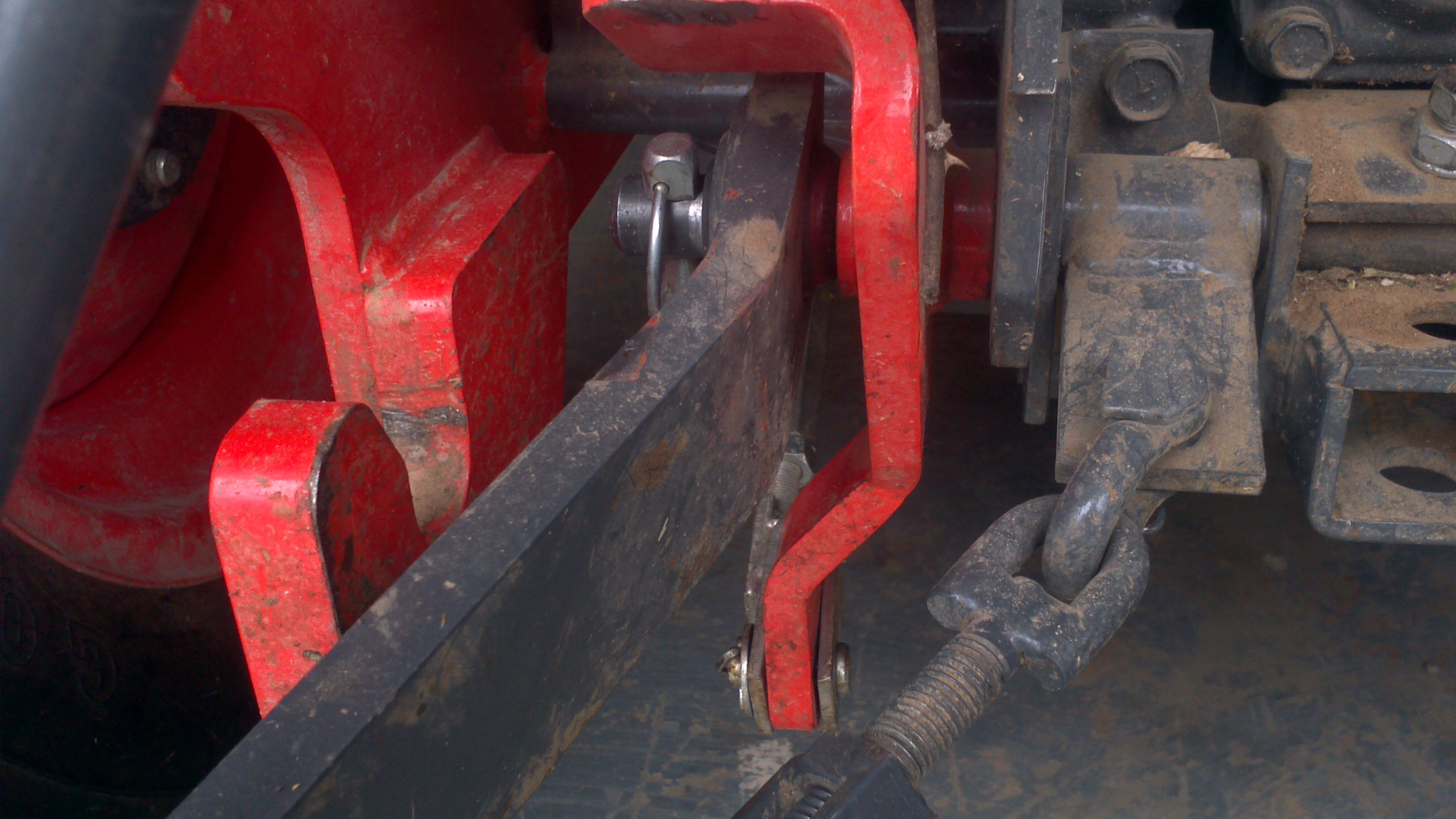

koojets
Here are some photos of my 3ph on my B3200. Basically the same as your B3300.
Are you having trouble sliding the pin far enough to the side to get the lower links on?
   / I can't figure this one out.... #18
koojets
If I understand his situation the way I think I do, it's not the lower links - it's the check chain eyelets that are inboard of the lower links - there is no where enough room to slide the lower link retaining pin far enough to one side to allow their installation when you have a backhoe sub frame mounted. Your pictures clearly show that limitation. The lower links are no problem to take on and off, but if the eyelets are not i stalled then he will have to remove on side of the sub frame to have sufficient clearance to install them.
#19
Beckmurph - that is exactly the problem. Thank you for the photos.
Yes, IvanS. I did misunderstand what you were saying. It is as you described - one side of the subframe needs to be removed to allow the check chain eyelets to be threaded by the lower link.
