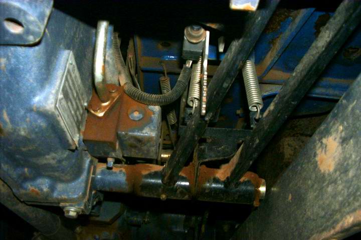

First I don't believe in bad car ma so I don't think my post in the rural living has anything to do with this. I am trying to clear about 3 acre. of thick but small/tall brush. Ocasionly I run over small logs that seem to make their way under the tractor and wedge on parts on the under side I have never had a problem just pull them out and be on my way. This week end i did it. I noticed the brake pedal on my 2001 tc40 gear driven would not depress I looked and sure enough a small chunk of wood was between the floor and the brake pedals on the underside. I pulled it out no problem but after doing so the parking brake would not engage. after some more inspection I noticed that the catch for the parking brake was hitting on the divertor valve that splits the hydraulics up to the laoder joystick. the whole diverter seems to be bent or at least the bracket. What I am looking for is pictures of how the diverter should sit and the bracket. It does not appear to have damaged the diverter but I may need to replace some of the piping for the loader as the lines looked a little out of sorts.(no leaks just curved on the ends) can anyone take a picture of their tc40 so I can see what it should look like under there?

Greenthumb, I think the diverter for the 3PH/Loader hydraulic systems is on the other side of the tractor. I believe the one on the left side might be the solenoid controlled valve for rabbit-turtle or maybe even the PTO diverter, but it really doesn't matter. If no one else responds before this evening, I'll try to get you a picture when I get home from work. That will be around 7 pm CST at the earliest.

Greenthumb, I've got three pictures for you. I have to admit a little embarrassment because my tractor is so dirty, but I've been doing a lot of work on my pond silt and it is dry and dusty here. Anything with the slightest hint or film of oil grows a "beard."
The first picture is looking straight up. The hydraulic valve is the solenoid controlled rabbit-turtle valve, so if you are having trouble changing hydro speeds, you will know why.
EDIT: OOPS! /forums/images/graemlins/blush.gif I just re-read your post and you have a gear drive tractor. /forums/images/graemlins/shocked.gif All my talk about the rabbit-turtle switch must have you scratchin' your head. /forums/images/graemlins/crazy.gif Sorry!
Your brake pedals are on the right-hand side and clutch is on the left. My pictures don't help you one bit. Aargh! I have to start reading better. /forums/images/graemlins/smirk.gif
<font color="blue"> Anyone with a gear tractor who can help? </font>

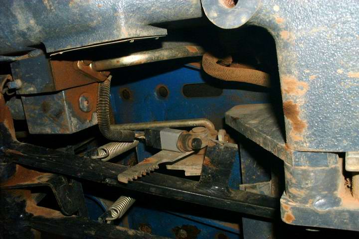

Another picture from the front looking back.
   / I did it now! Need some repair pics tc40 #5
Last one, from the back looking forward.
Let me know if I can help some other way. Good luck with your repair.
