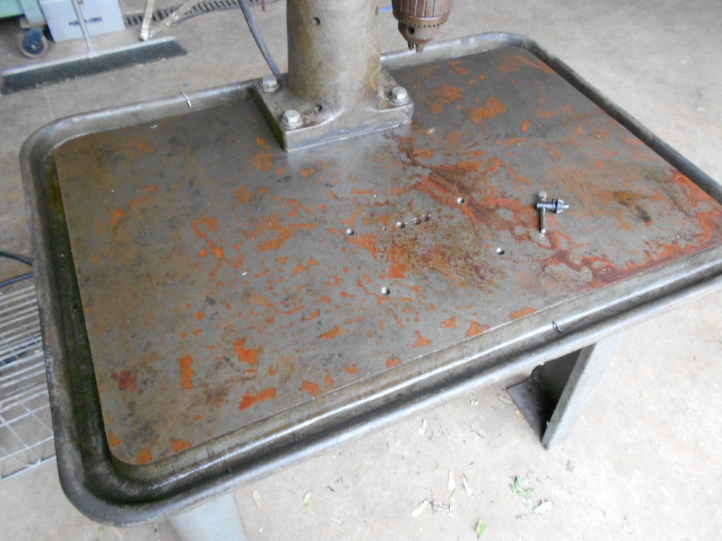

It's a perfectly smooth table. Maybe 2'x3' with a very deep oil groove around the perimeter. I don't intend to use the drill press as a mill, but it could be nice for rows of holes. Unless that table is junk.

Since your press table has gutters along the edges it is intended to collect cooling or lubricating solution.

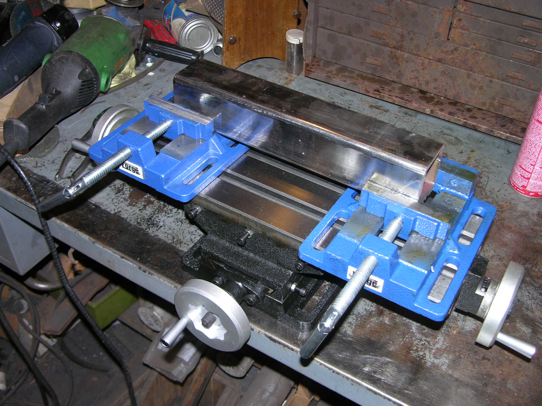

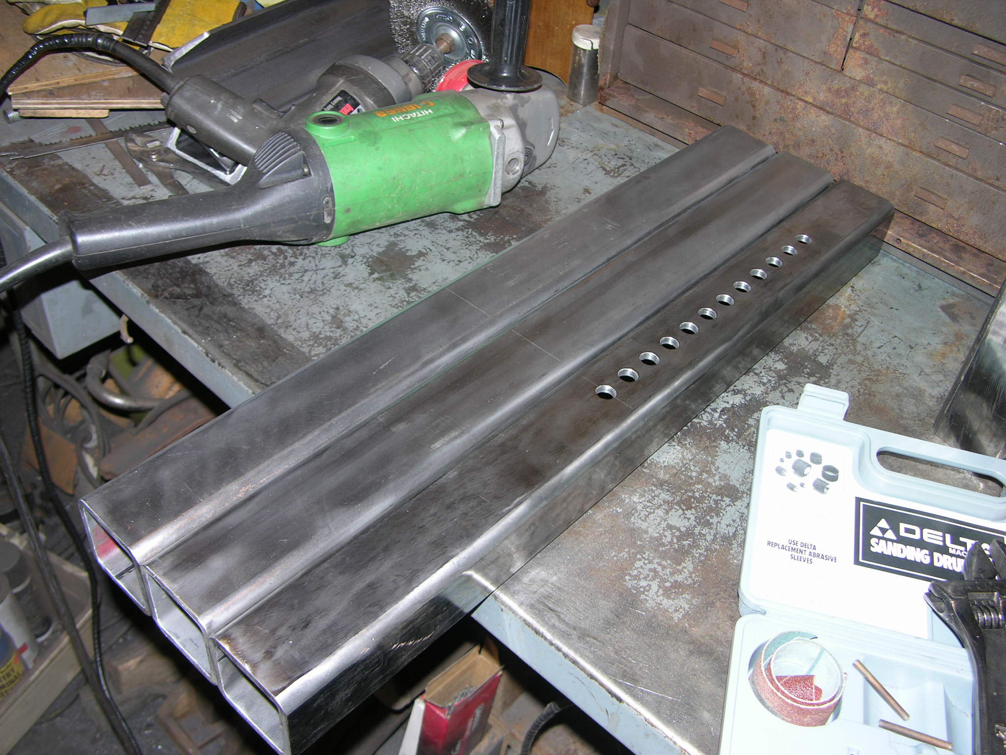

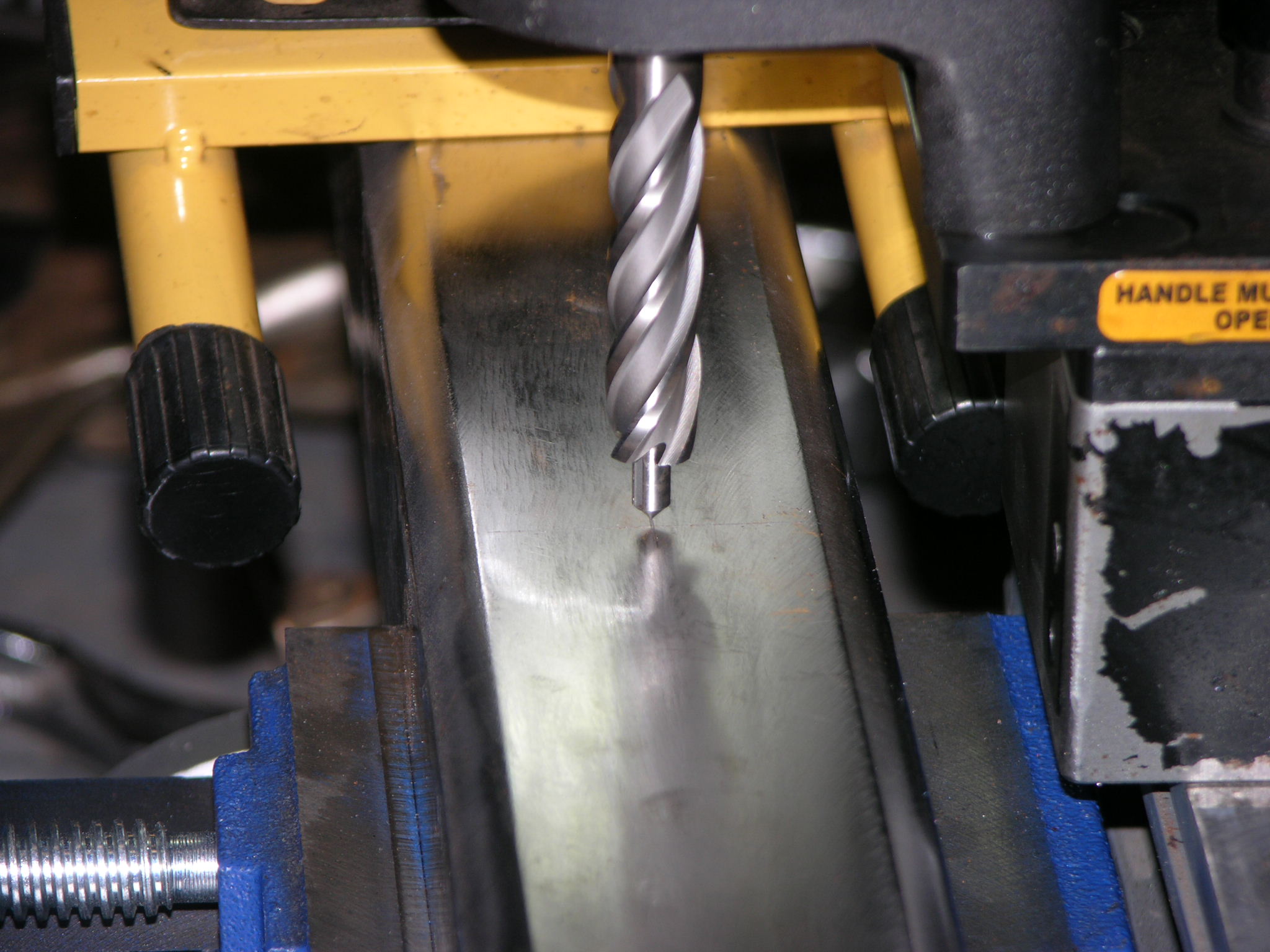

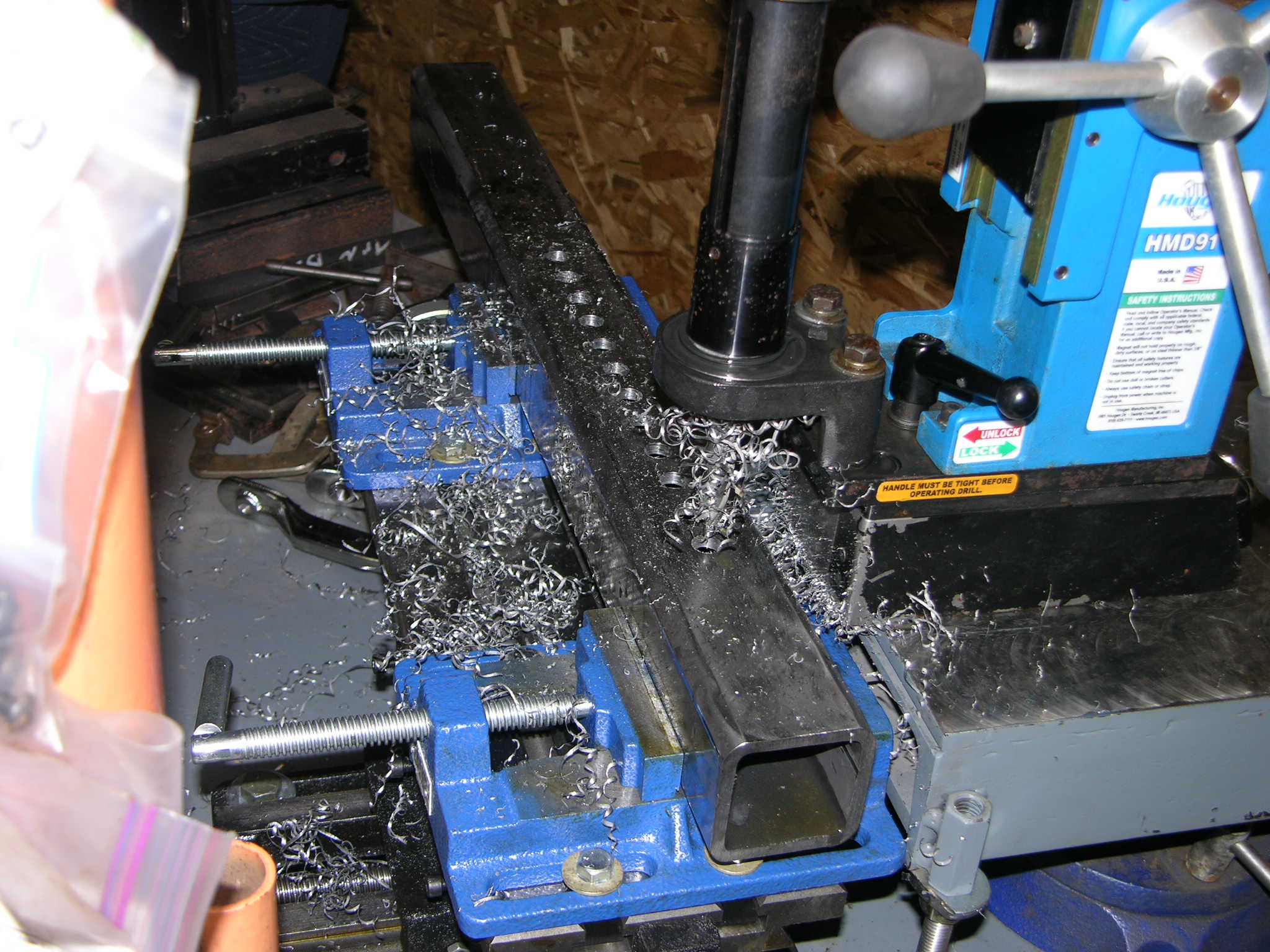

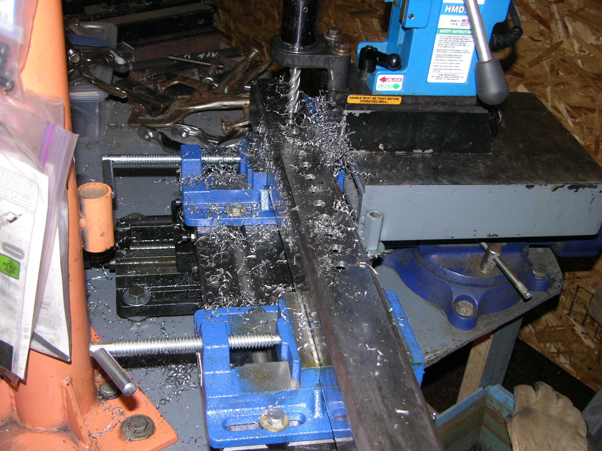

Any table like that is gonna have a certain amount of play, or it won't move - but this one's not bad, you just need to hold back tension on it as you crank the lead screws and it stays pretty uniform. Probably what the CL guy improved on with the brass gibs.

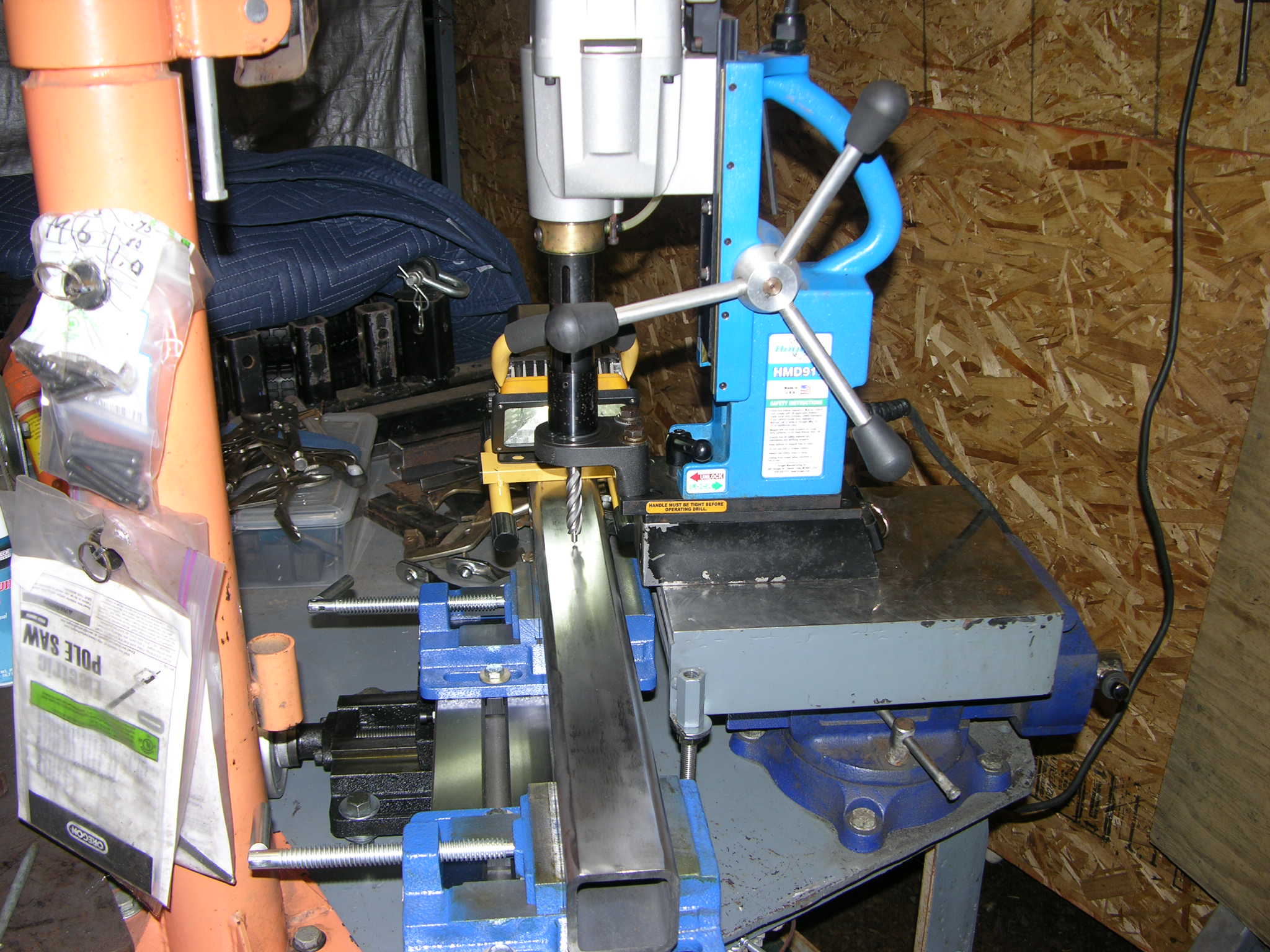

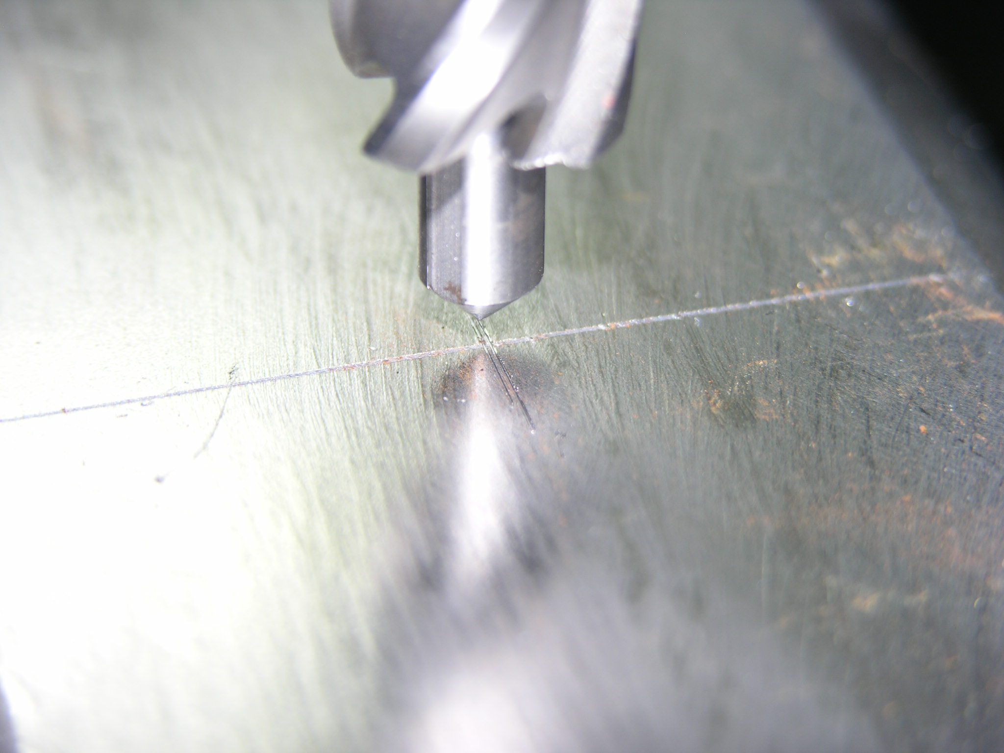

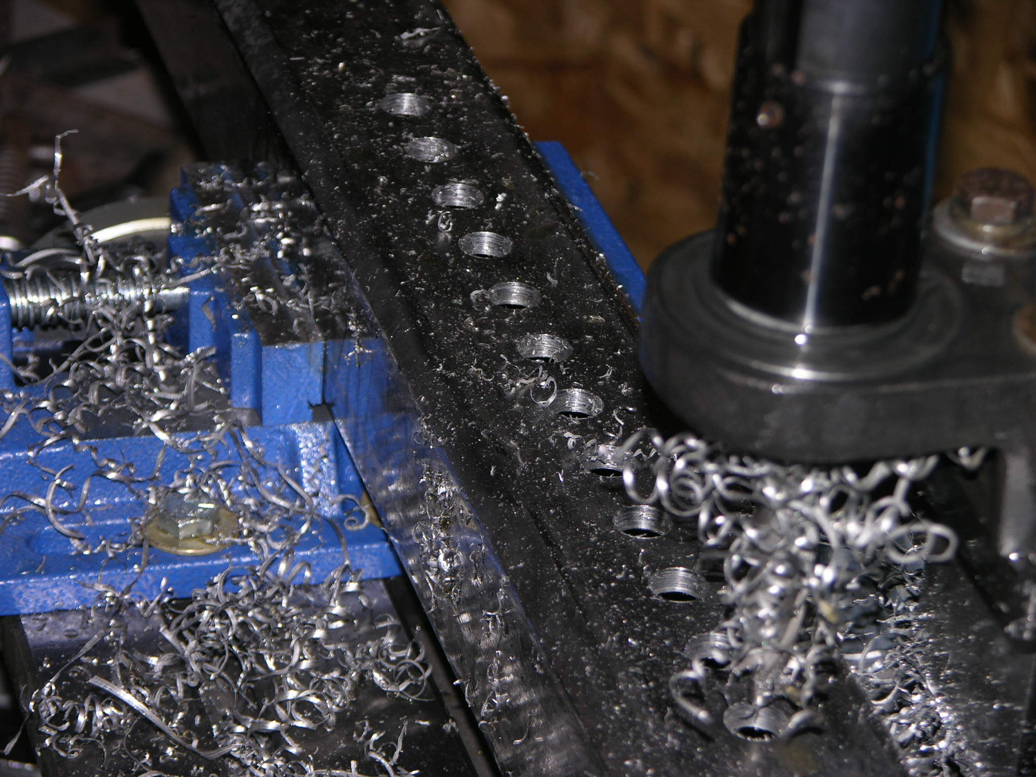

Personally I wouldn't hesitate to drill a few more holes in that DP table, somebody already STARTED a few :rolleyes: - then I'd mount the xy table and 1 or 2 DP vises - the ones I used are just HF cheapies, but I clamped BOTH around a piece of 2-1/2" tubing and set them up as a PAIR, being careful to align things so you can run just ONE axis on the table and NOT have a shift in axis relative to a drill in the chuck - if you do that, then the following pics are what you can expect (other than mine were done with an $1800 mag drill and annular cutters) ...Steve
Oh, and if that DP is as solid as it looks, you should be able to get a taper adapter to 3/4" weldon shank, with or without coolant feedthru if you want the option to run annular cutters with it -
