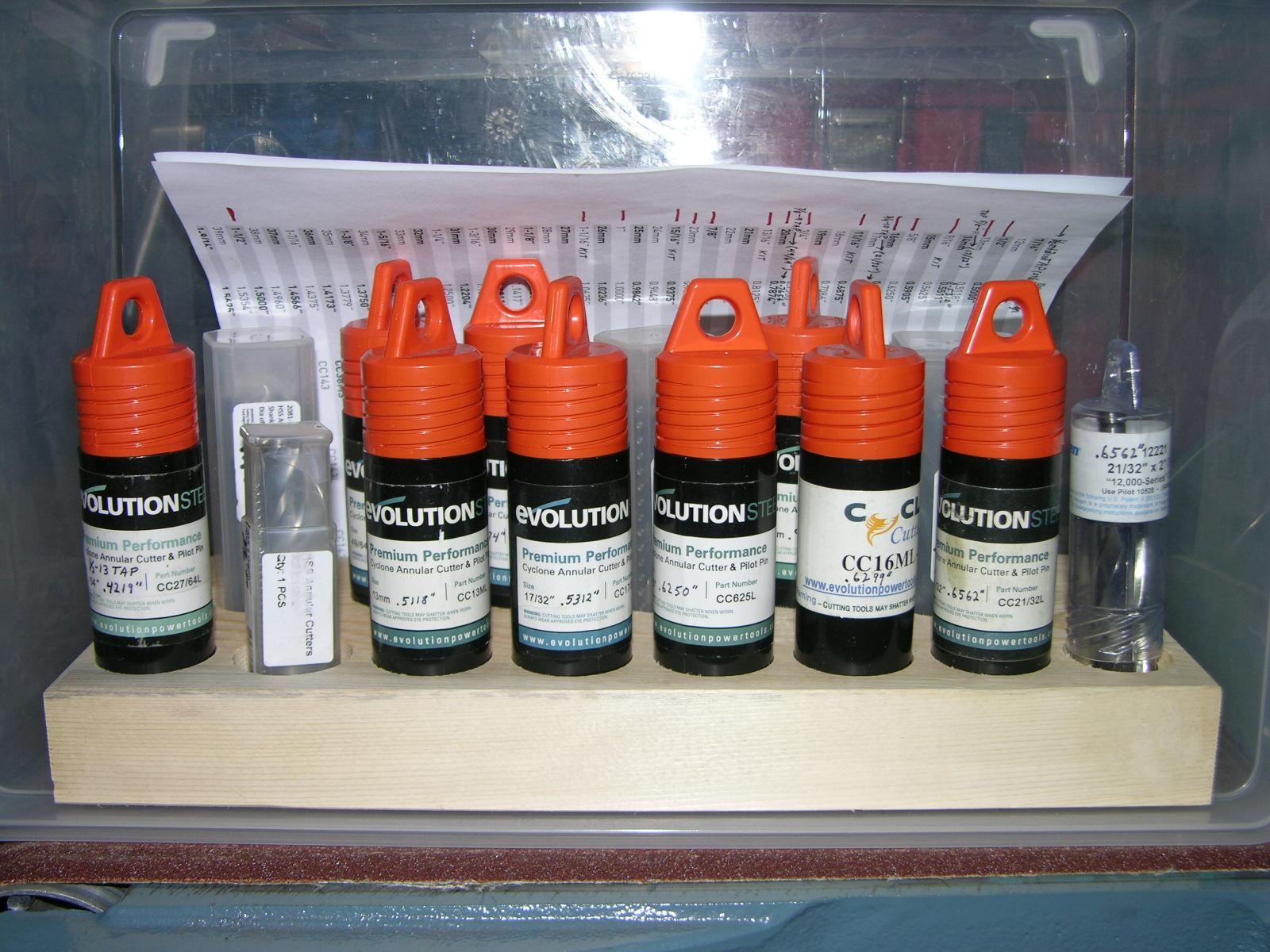

Thanks. Ironically, I already printed the Little Machine Shop page. I'm pretty sure it's a #3, but it can't hurt to check. Gotta buy the drift, but the chuck is currently out so it won't be a problem. What are people doing for a coolant pump? I was thinking of using a 5 gallon bucket to store the coolant and then suspending the pump in the bucket.
   / I don't know how to machine... Is this too good to be true? #22
That could work, you don't need more than a few OUNCES of pressure - my mag drill came with a built-in GRAVITY feed coolant bottle - since it takes 27.65 inches of head for WATER to = 1 psi, mine has maybe a third of a pound of pressure when the bottle's FULL.
You would need an adjustable restrictor tho, a drip or two per second is fine. I use a 10:1 water based coolant (about $55 a gallon, still working on my FIRST gallon) and I don't recycle. If you recycle, you'll want some sort of filter to keep fines from plugging your coolant flow and trashing a $$$ cutter. Mine has a small ball valve on the outlet of the bottle's bottom outlet for adjusting flow. The slip ring reservoir can also be filled and shut off, lasts for 2-3 holes depending on material thickness and hole diameter.
Not sure if those Jancy adaptors do this, but normal mag drills use the "pilot" as an automatic check valve - back end has a "nail head" that seats against the back of the cutter, push on the (spring loaded) pilot and coolant flows.
If you haven't already, dnl that hougen document (they have others in their support area) - TONS of info there, worth reading more than once... Steve

Spreading the cost out is a time-honored way to get where you wanna go WITHOUT your wallet "bleeding to death", I do it all the time - I bought my mag drill as a "fabricator kit" and got 5 piece set of Hougen cutters with it for about 60% of what the individual cutters cost, then bought "onesy-twosies" from a list I made up of sizes I wanted available - there's one or two still on the list, but I won't get them til the (projected) need turns into reality. Still, I've probably got close to $800 in cutters so far. Some are exact size, but probably 2/3 of 'em I bought are "clearance" sized - by that, if I need holes for 3/4" bolts I'll use a 20mm cutter (.7874") which gives me .037" clearance...
DSCN1966.JPG - as you can see, I also mark the EXACT decimal sizes on all the tubes for my convenience.
Not sure how big the forum allows for pdf's, if it works here's my current list of cutters (marked in red on pages 15-16) - The 1-1/2" cutter was expensive, that's the size ALL the pins on my backhoe are, except for the main pivot on the hoe bucket; it'll make fabbing some projected attachments MUCH easier... Steve
