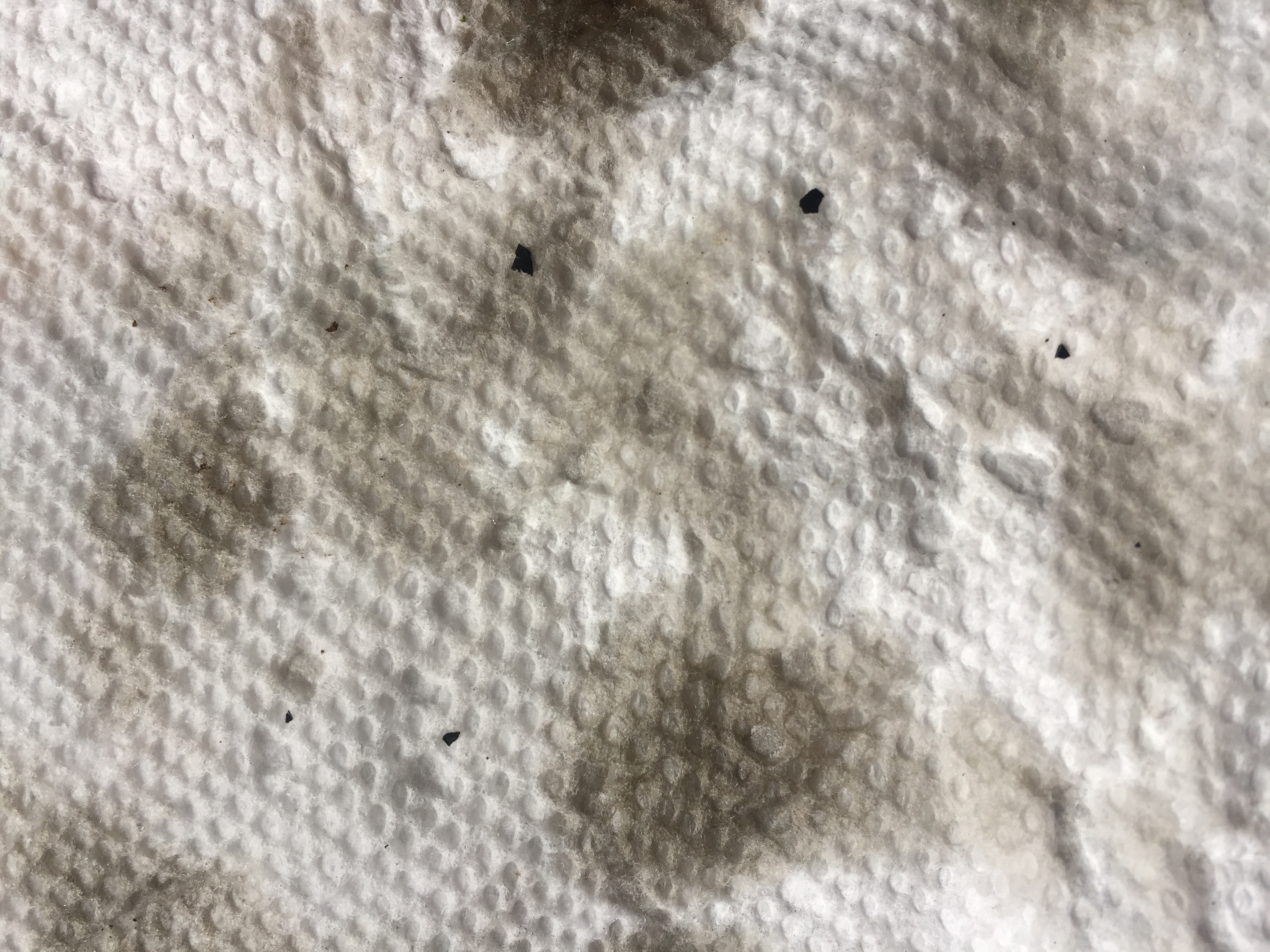

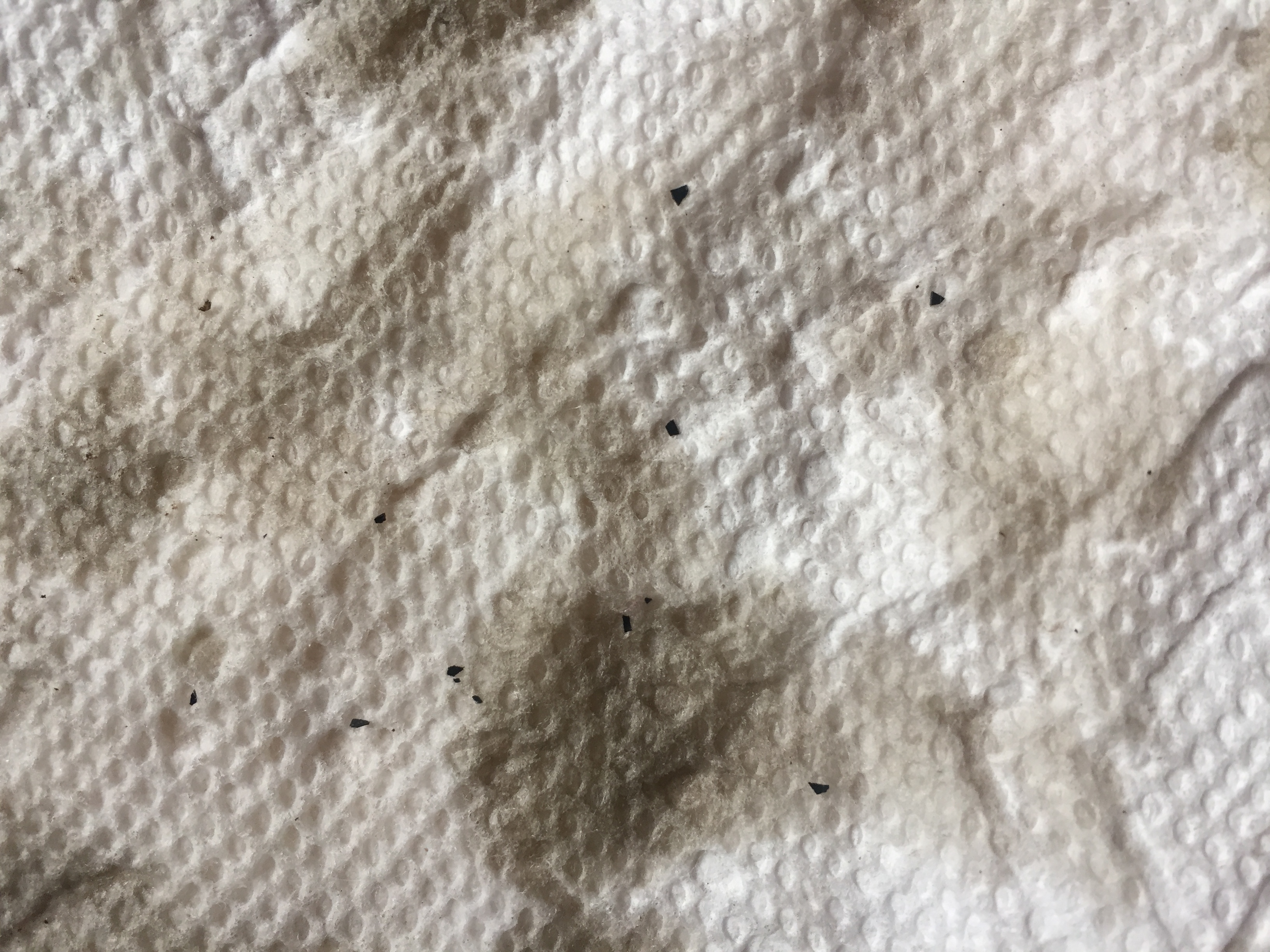

99BA2365-8286-46A2-A1BC-80628F09208F.jpegD94F33C2-7686-4C33-8F61-37AAF0F1CA6C.jpegHe was mad because I ran the tractor with almost no oil in it.
So I drained the oil this morning and strained with sock and put the oil back in. I found nothing in the sock. On the bottom of oil drip pan (I used clean 6 quarts container), all I found are these. They look like paint flakes. When I squeezed with my fingers they broke into smaller pieces. I don’t it’s sharp enough or thick enough to cause any damage. At least so I hope. What do you think?
And why the oil is dark already? Is it normal for diesel engine? Or was it because some of the old oil still left and got99BA2365-8286-46A2-A1BC-80628F09208F.jpegD94F33C2-7686-4C33-8F61-37AAF0F1CA6C.jpeg mixed in? Should I replace the filter?
   / I drove Kubota with about 1 pint of engine oil for 30 feet #20
View attachment 573013View attachment 573014He was mad because I ran the tractor with almost no oil in it.
So I drained the oil this morning and strained with sock and put the oil back in. I found nothing in the sock. On the bottom of oil drip pan (I used clean 6 quarts container), all I found are these. They look like paint flakes. When I squeezed with my fingers they broke into smaller pieces. I don稚 it痴 sharp enough or thick enough to cause any damage. At least so I hope. What do you think?
And why the oil is dark already? Is it normal for diesel engine? Or was it because some of the old oil still left and gotView attachment 573013View attachment 573014 mixed in? Should I replace the filter?
It appears that your engine has faired well.
If you had not changed the filter previously, Now would be a good time.
Diesels make sooty black oil, and that soot sticks inside. darkening fresh oil immediately. Even just that little bit that doesn't drain out holds a lot of "lamp black" ;-) If the filter was not changed, there is a good amount of blackness in there as well.
I think your "low oil level damage possibilities" concerns can be put aside. "Just don't do that regularly" ;-)
