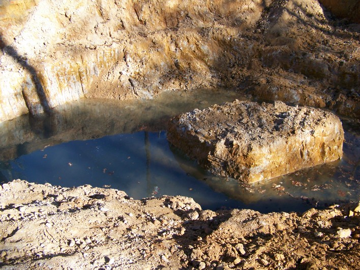

I removed the stump from the pond today. I kept thinking it was a little to high in the pond and too many fishing lines would be lost to it.;) I will put some broken culverts in it's place.
I also cut back and sloped the shallow end this evening after dark and gave it a rounder, less square look. My loader lights work great,:) but I need to wire a seperate circuit for the backhoe lights to get more brightness for better depth perception. :(
The water level keeps creeping up and we haven't had any rain all month.:D Which pleases me immensely.:cool:
hugs, Brandi
