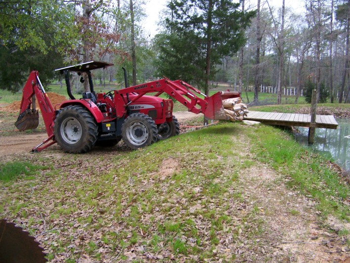

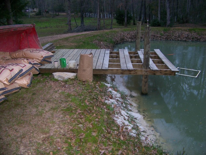

On Feb.26th, I put out 17 fifty pound bags of Sodium Bentonite Clay on the dam areas where water was seeping. This after ripping up every other 2 pier boards.
The pond has overflowed 3 times since the clay was put out. At first I thought it didn't work, as the pond was still seeking. But it only seeped down to 2 inches below overflow. Before putting out Bentonite, it seeped down to 10-12 inches before the seeps dried up. So I know it is working. Now I think it is a mass issue. The dam needs more mass on it, so I will see how to add 6 inches of dam height under the pier. I think I got that figured out. It will mean ripping up most of the pier and rebuilding it.

Brandi, did you just spread it out on top of the dirt? It doesn't looked mixed in at all.
Eddie
Eddie
Correct. It is not mixed. This is the 620 grain clay. I told them my situation and they said the best thing to do is broadcast it and let it get wet.
hugs, Brandi
Who is they?
I don't understand how that will accomplish anything. Betonite works by expanding when wet, and filling any voids that might be there. You have to apply enough of it to get the job done, which is why it's expensive, and you have to mix it in with your existing soil.
In everything that I've read about it, it takes quite a bit to work, and they always disk it in to mix it with the existing soil.
It's not garanteed to work, it just improves the soils ability to hold water. Compaction and existing quality of the clay is still the most important factor to holding water.
Eddie
