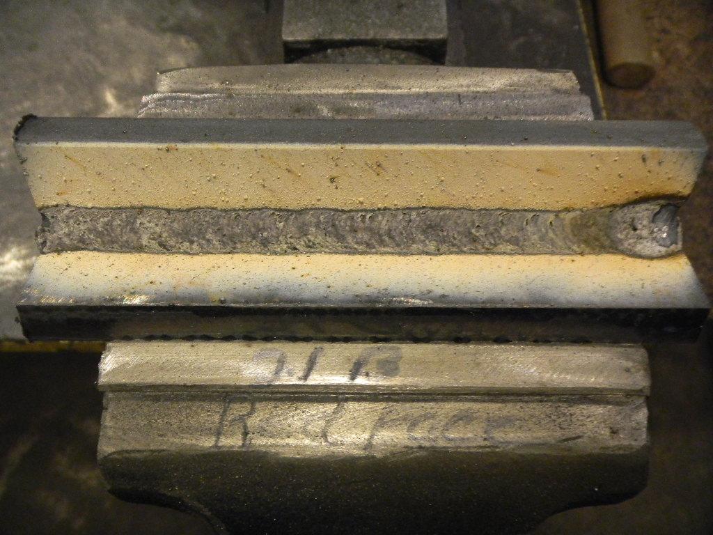

That is strange that they only go up to .035 wire. If you ever find yourself under gunned for power, you can switch to flux core self shielded wire. I've run tons of Hobart's Fabshield 21-B. I have even butchered a few bend welding tests and still passed.:eek:
Here is what it looks like.
Product Details - Hobart Brothers Performance Welding Products
