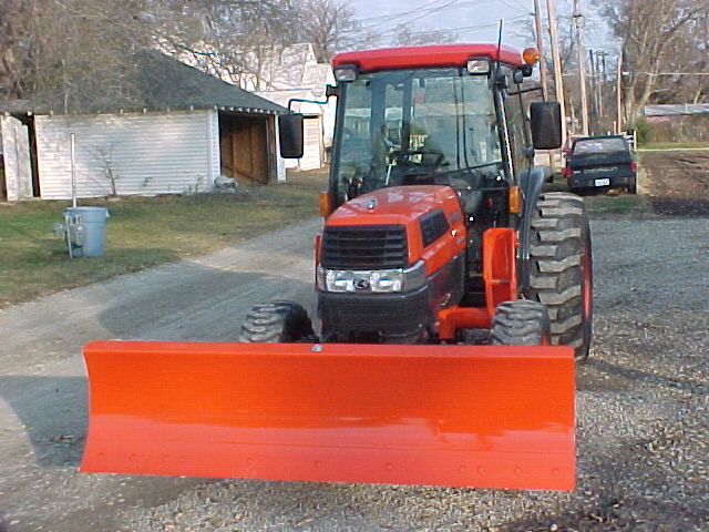

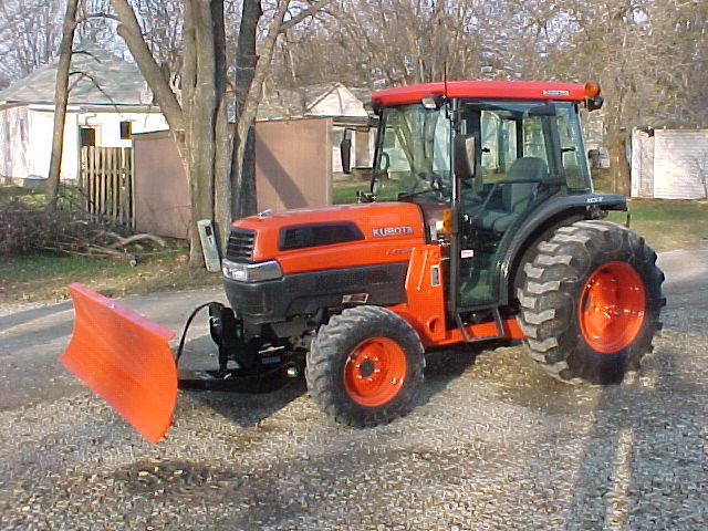

I got my front blade and installed it today. any one eles have one one the 5030?

pic #2

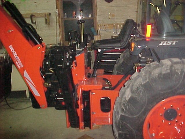

Last one.
jury is still out on the backhoe, parts are not here yet.
   / I got my L 5030 cab tractor #25
I have a front blade and blower on a 3830. My blade is much heavyer. 7 1/2' Fisher power angle. Mine drive way is gravel so I us the blade until everything freezes down really good then change to the blower.

OK my spacers came in today. They are 3 1/2" thick andd they sent longer bolts, they are black instead of orange but you can see it good. It was dark before I got it done so I took pics in the shed. I was able to slid the seat back over 1" from the min stop. This clears the glass 1/2". I feel a lot better know.
#30
another #2
