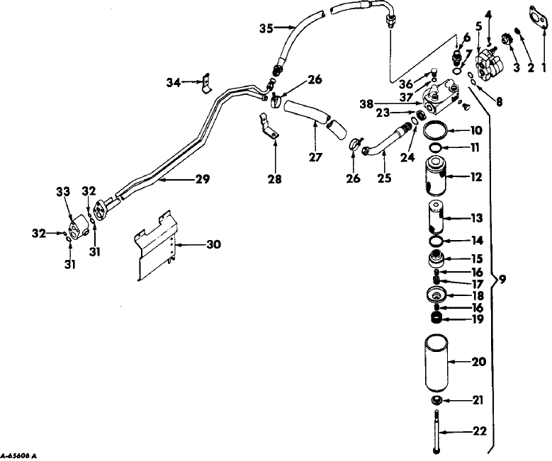

Where is the fill hole for hydraulic oil? Does it use Hy-Trans?
   / I-H 404 #2
Should be an approx. 1" plug in the trans. shift cover. It will be between the gear shift, and seat. A 1/2" drive should fit the square hole in the plug.
Check plug will be on the left side, sitting in the seat, just behind the axle housing, about center level of the axle.
And yes, Hy-Tran in there. System holds 7 gal.

Appy, here is the exploded view of the hydraulics.
#12 is the mesh screen.
#13 is the element.

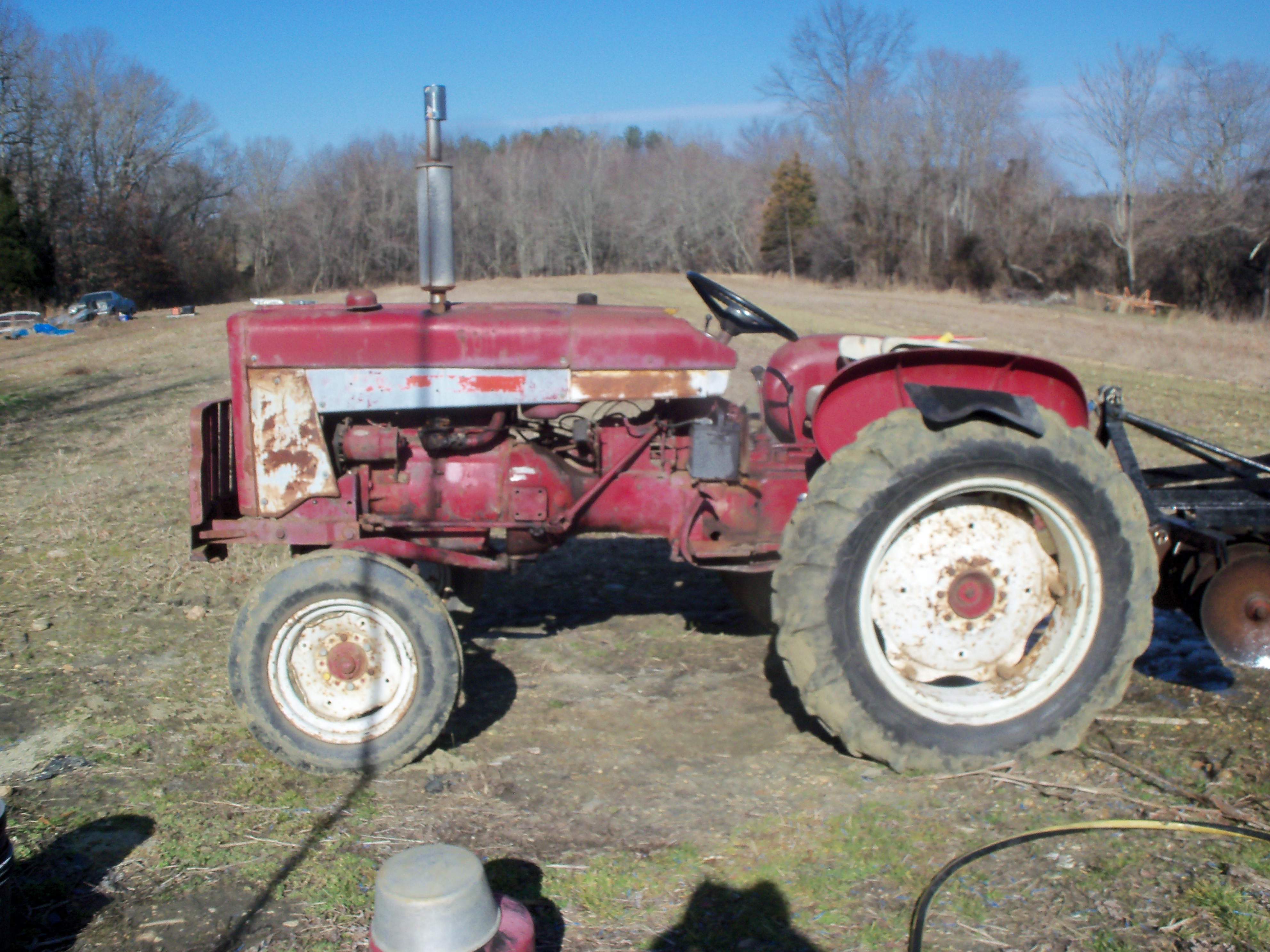

Just finishing up painting the 404...I went overboard. Stripped the paint, primed and ready for finish coat. I'll send pics...calander material. I won't want to get it dirty...but, I bought it to work it. Mechanically sound.

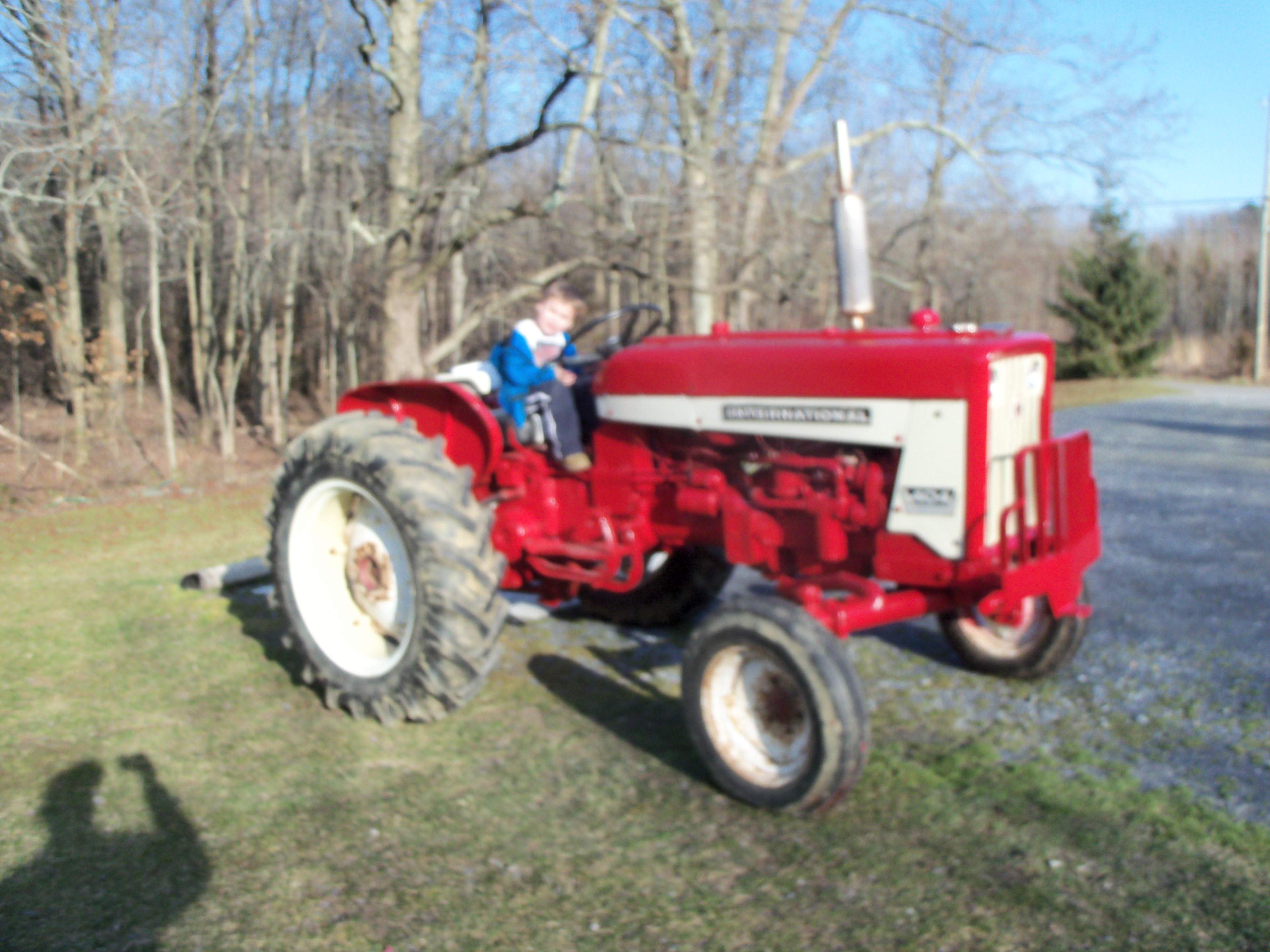

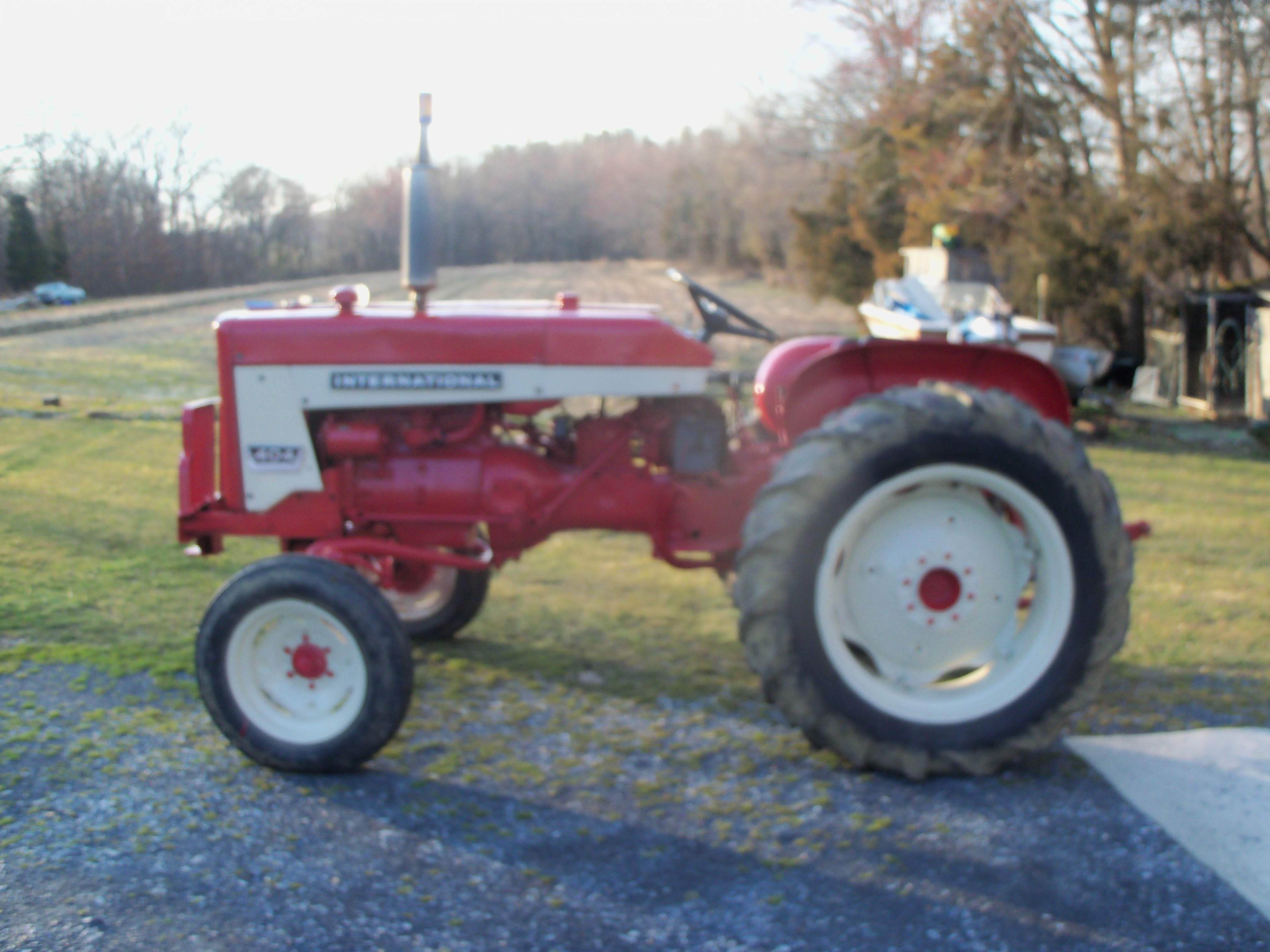

Thought you might like to view these. The manual was a must have. Thanks

   / I-H 404 #9
Looks good..!! Nice job..!!
