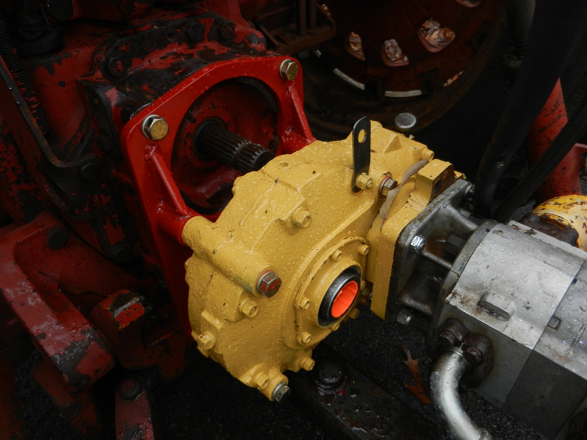

I don't know if I'm spoiled or screwed.
I don't have the collar to pull back....I don't have the pushbutton. My mower is hydraulic so it bolts on. Support bracket bolts around PTO assembly. Speed increaser bolts to support bracket. Hydraulic pump bolts to speed increaser....and done. The bad news is the speed increaser and hydraulic pump (with attached fluid hoses) gets to be a bit heavy and awkward to move about.
