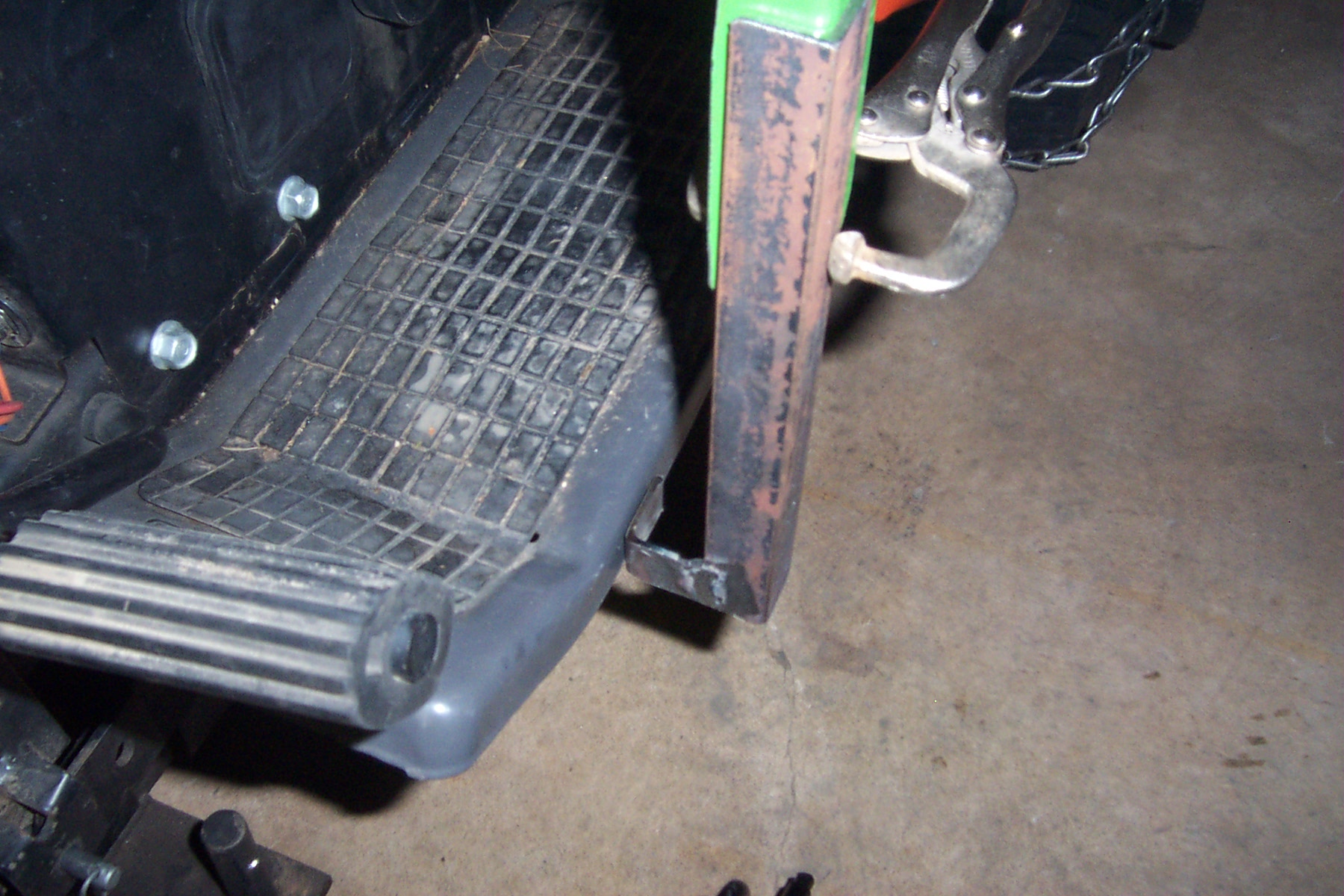

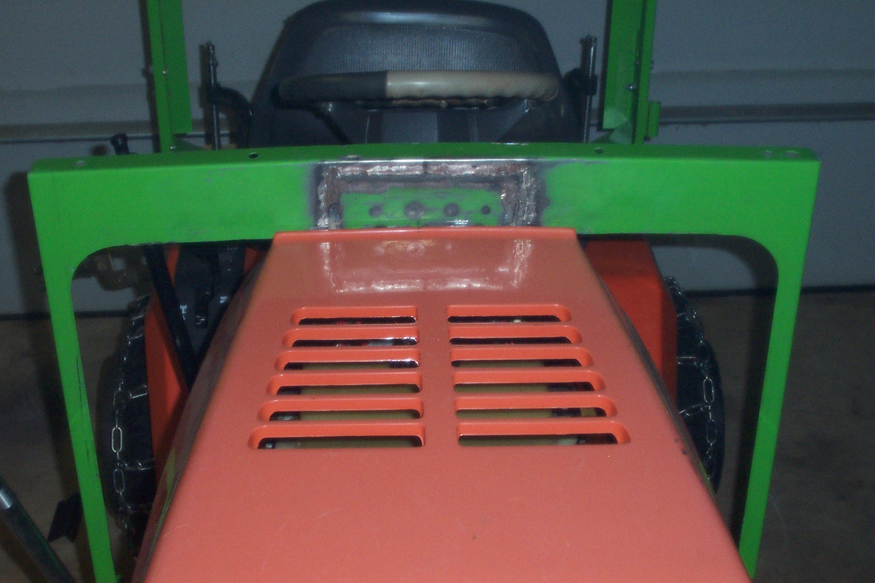

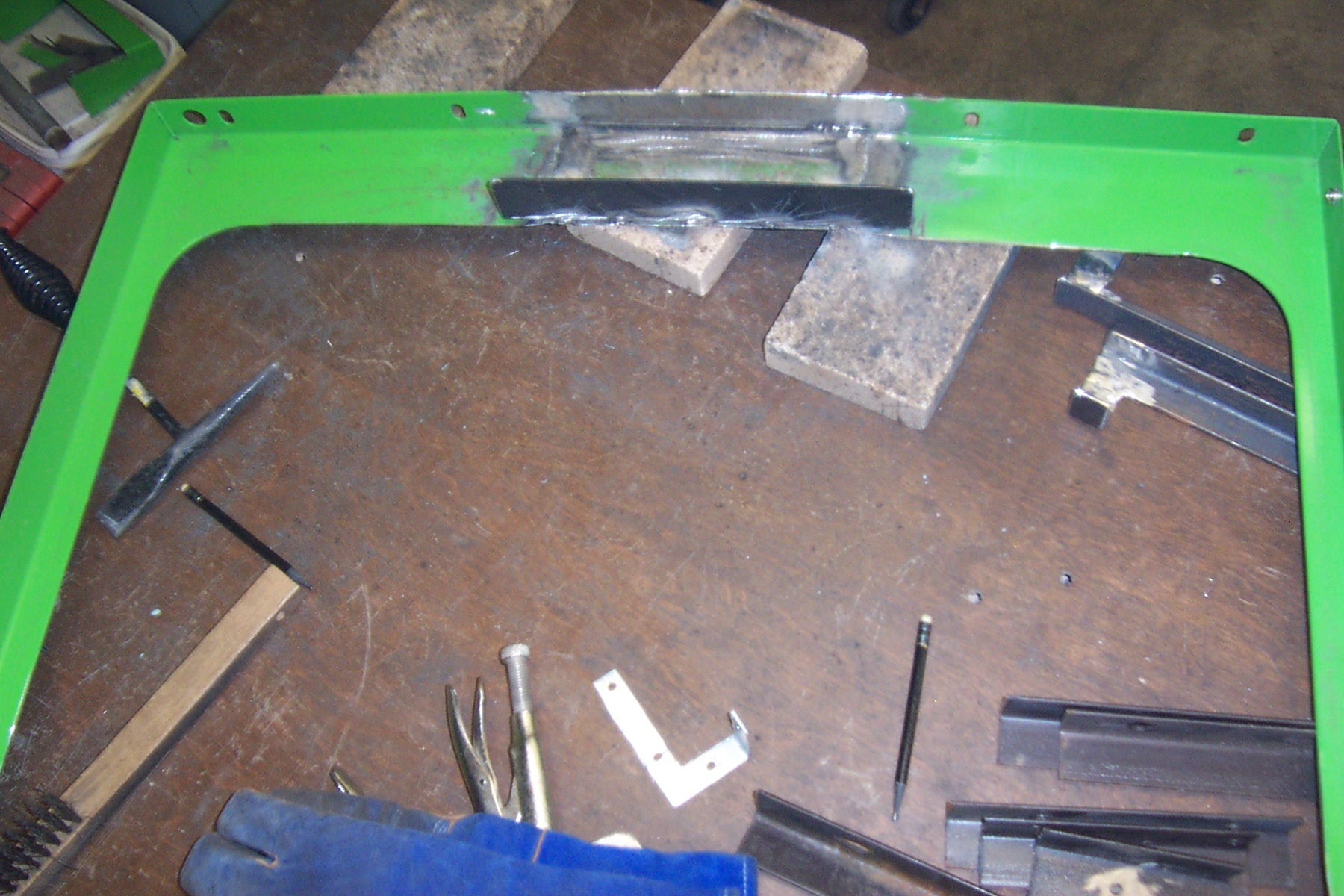

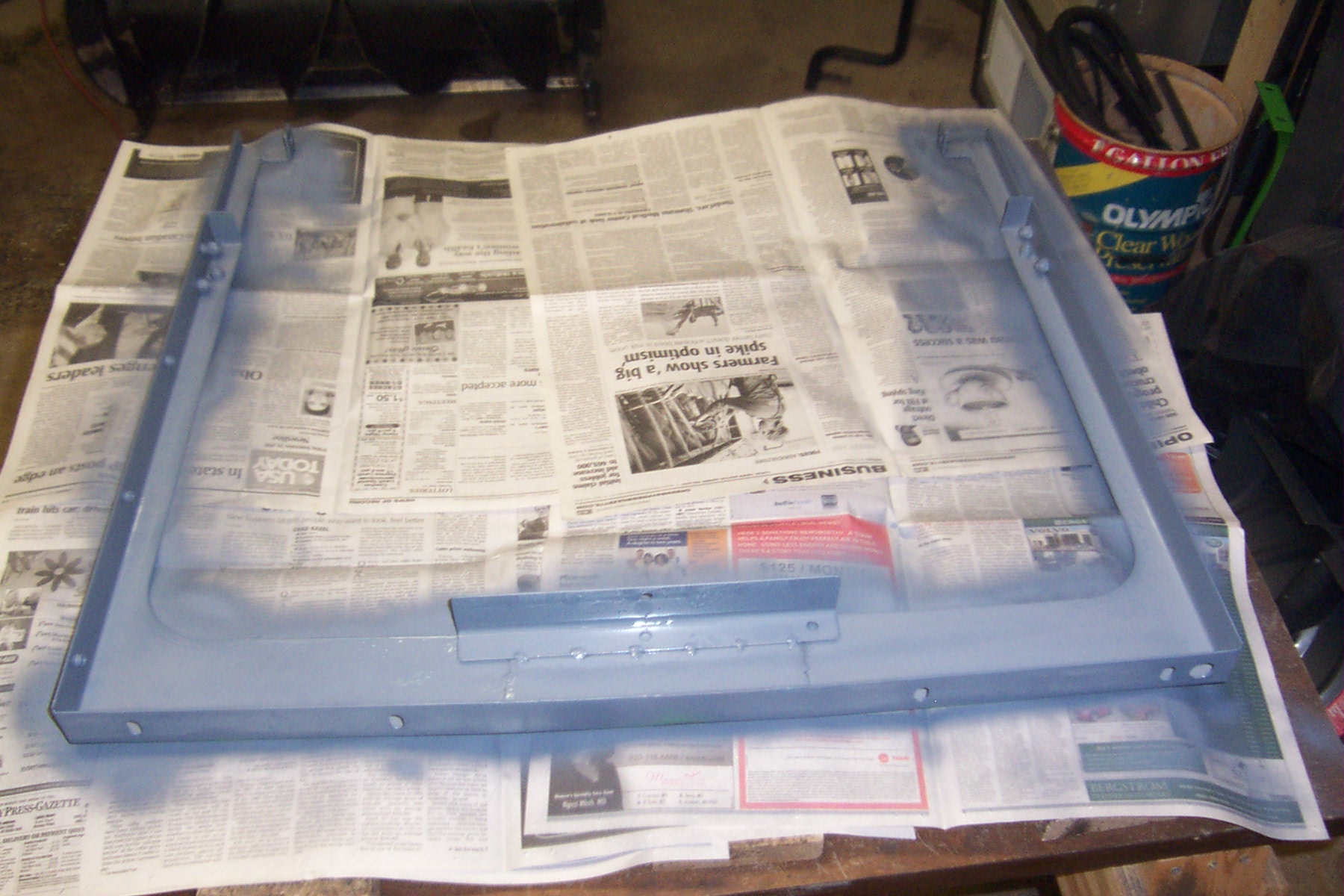

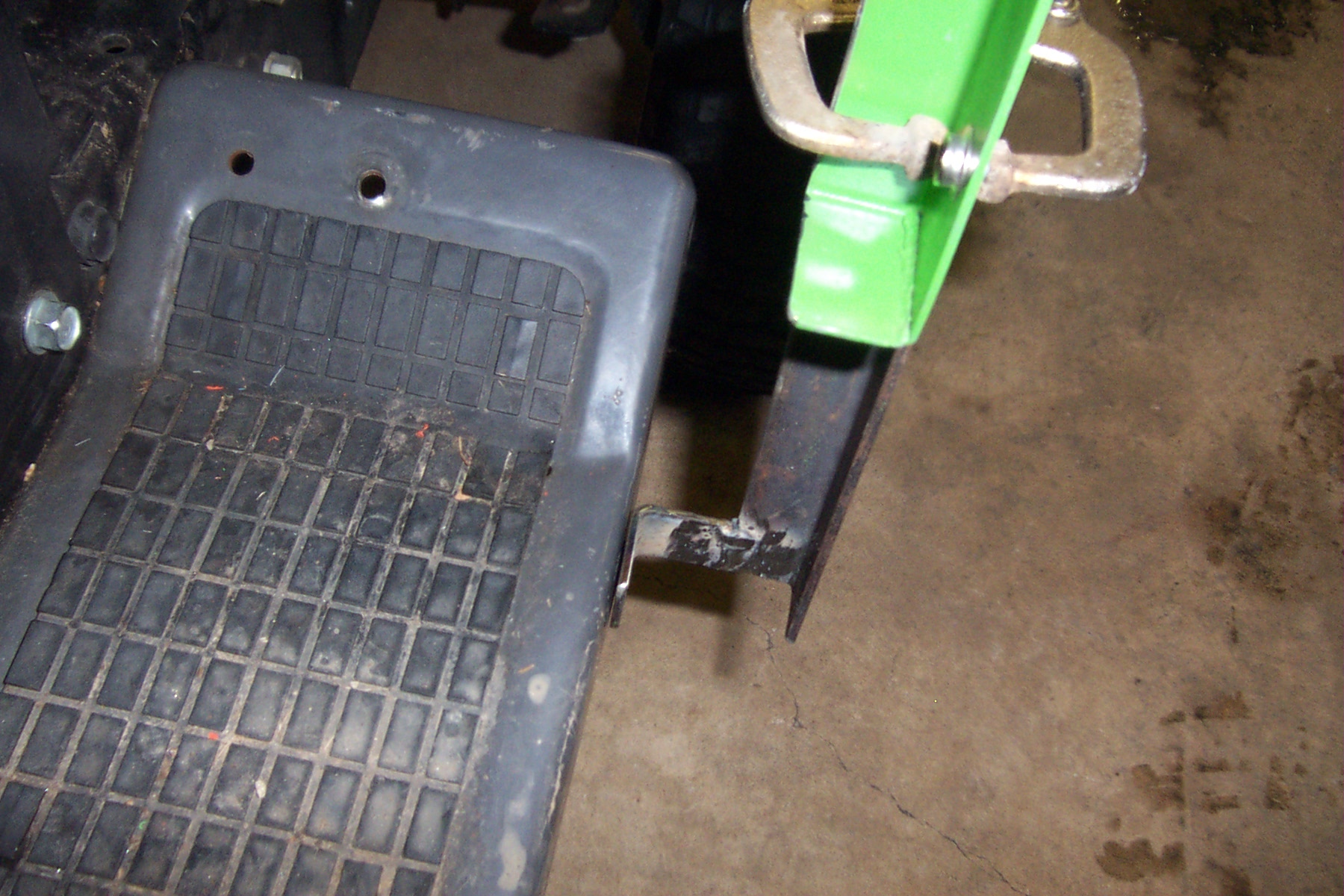

Here are a few pics of cab.The first thing I had to do was cut out the lower panels in the front.I also had to remove the boxed area and fill that in. Then I had to extend the front legs to reach the footpads so I could bolt them on.Then it was time for some primer. I won't paint the final color until summer but wanted to protect the metal.

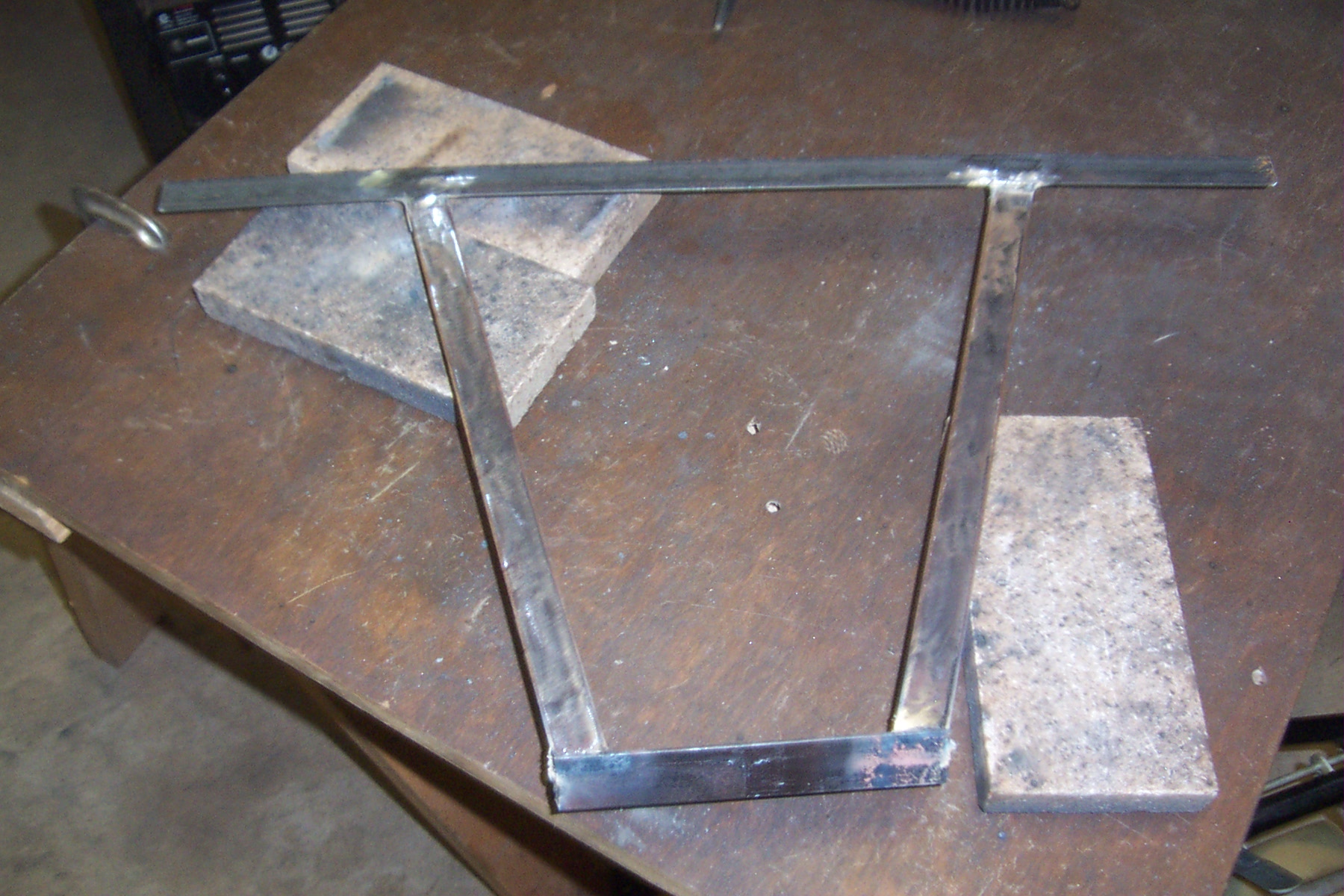

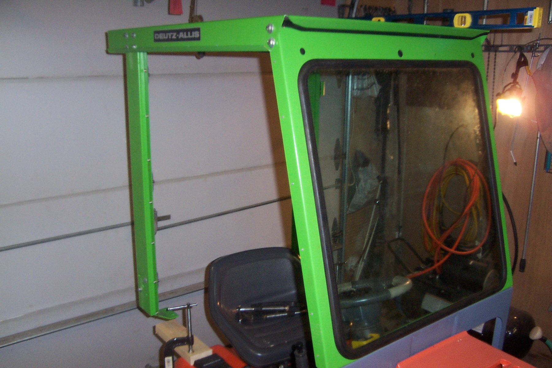

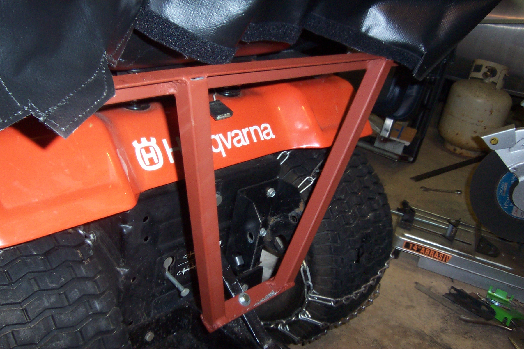

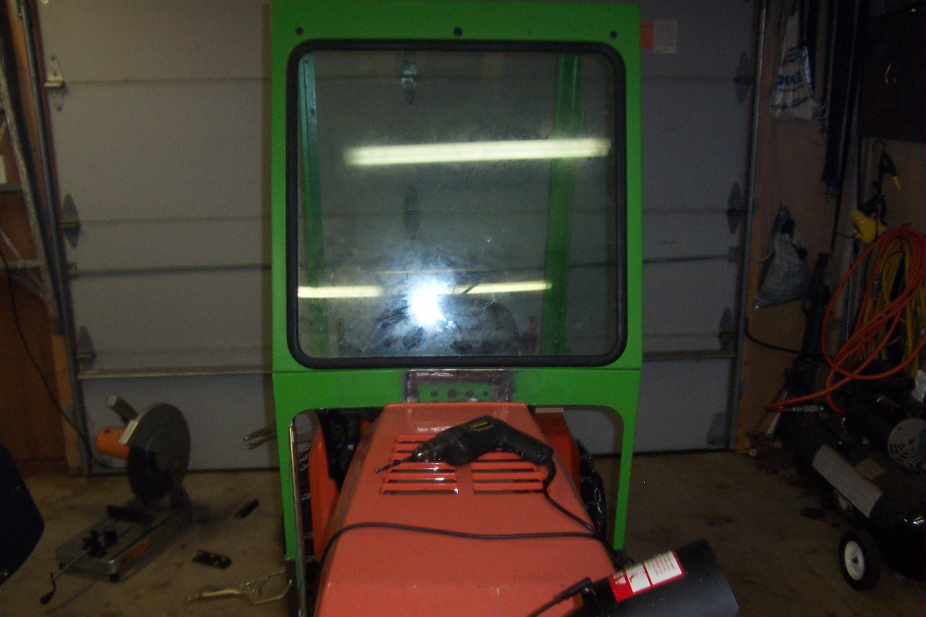

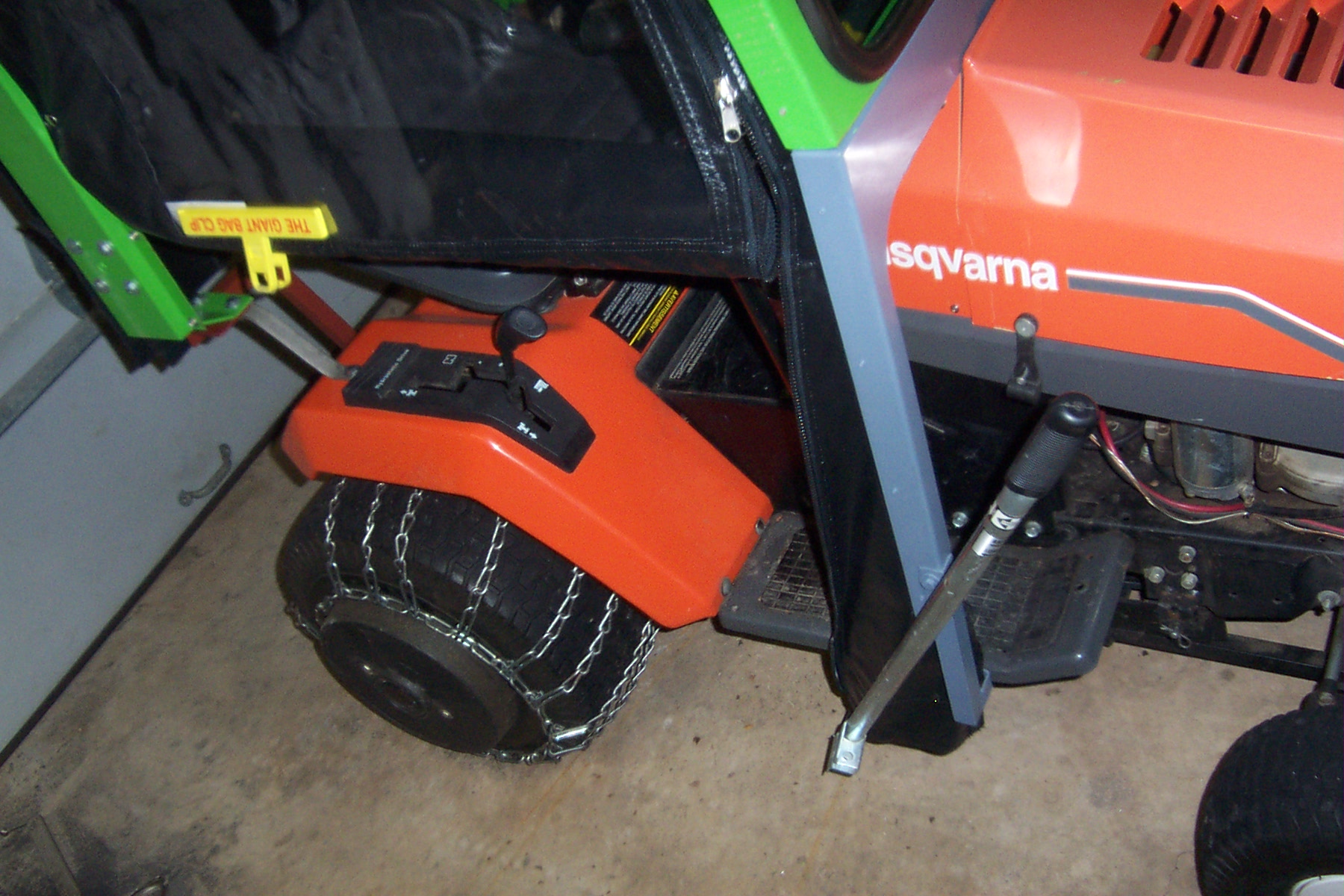

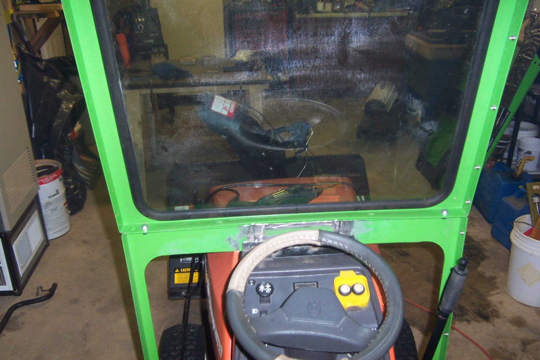

I put on the front glass to see how it looked. Next I had to figure out where the back posts had to go. As you can see they were also too short. I made a frame to reach a bracket on my hitch. Then it was time for primer again. I ran out of gray primer but found a can of red primer.

Looks like it is going to be a good fit on that tractor. Once you get it painted the proper color it should look fantastic. I started by cab build with a cab similar except my windshield was tapered (wider at the top than at the bottom) I think you will be real happy with the decision to put it on the husky.
