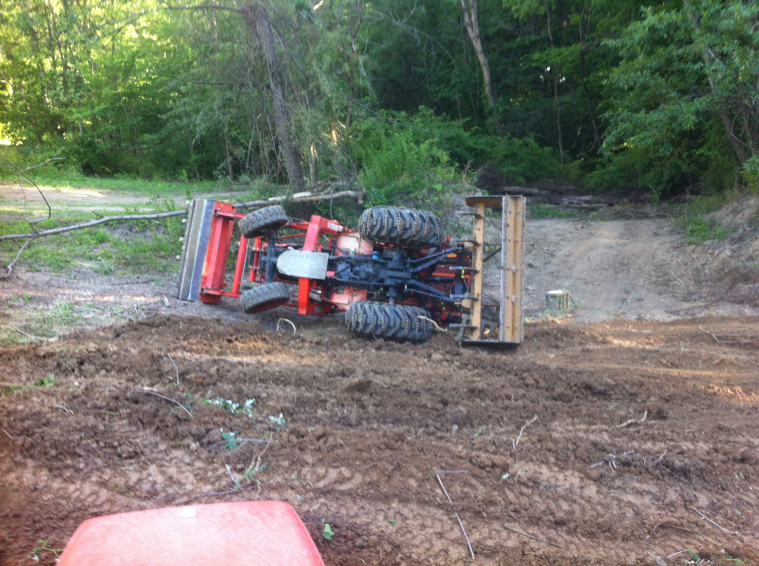

Well, it happened last summer. After over ten years operating my B2910 (Close to 1,000 hours on the tractor), while using the box blade to pull down the banks of a failed attempt to make a pond (previous owner, probably 40 years ago) I was numbed by the repetition of going forward, back, forward, back,forward I guess, and did not notice that I was building up an edge, that was about 2' high when the event occurred. What happened was that I got too close to the edge of this little build up, and the tractor slid down, and then abruptly stopped when it reached the bottom, and a slow roll occurred. VERY slow...but before you know it...the tractor was on its side.

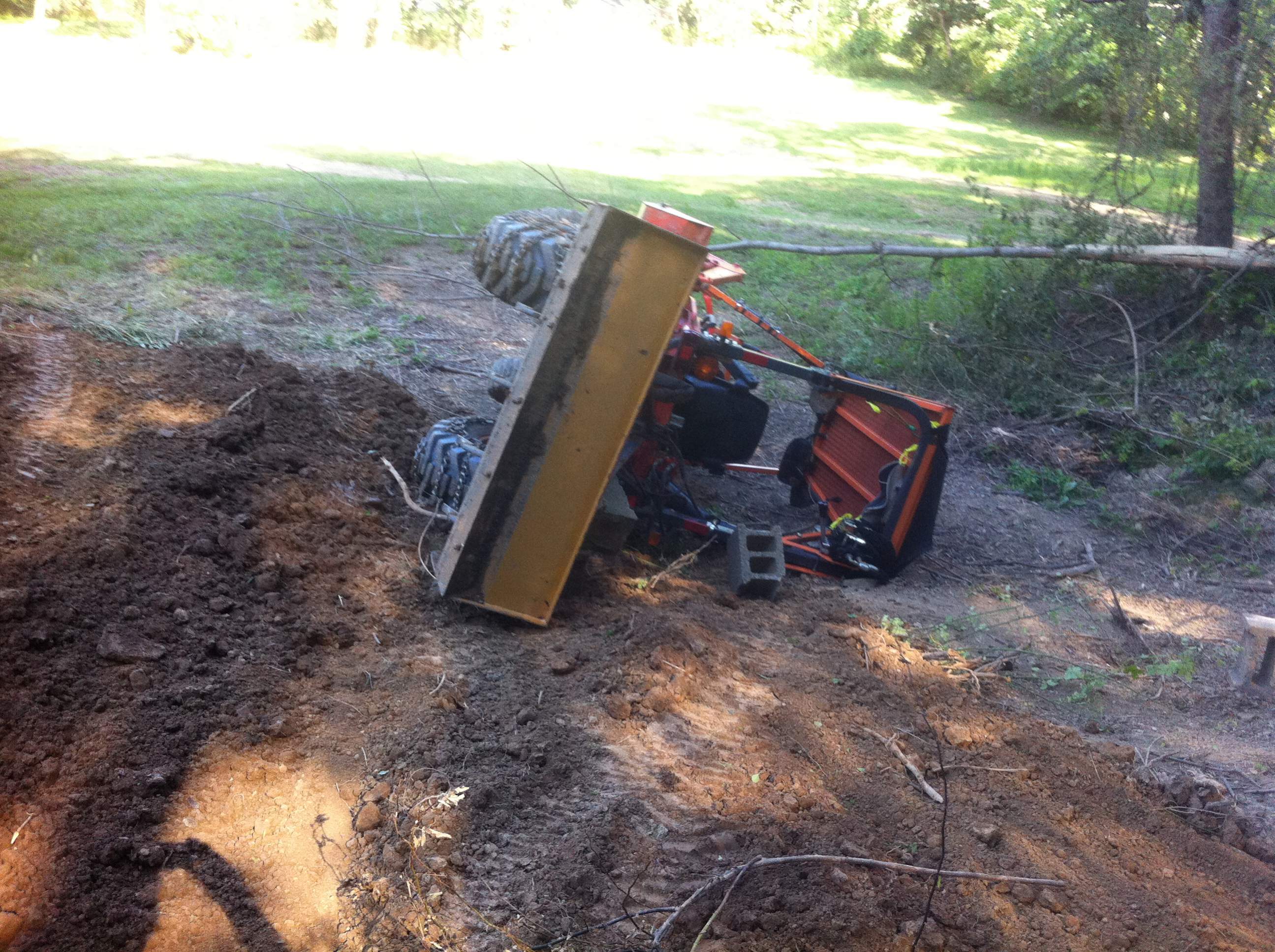

Another view:

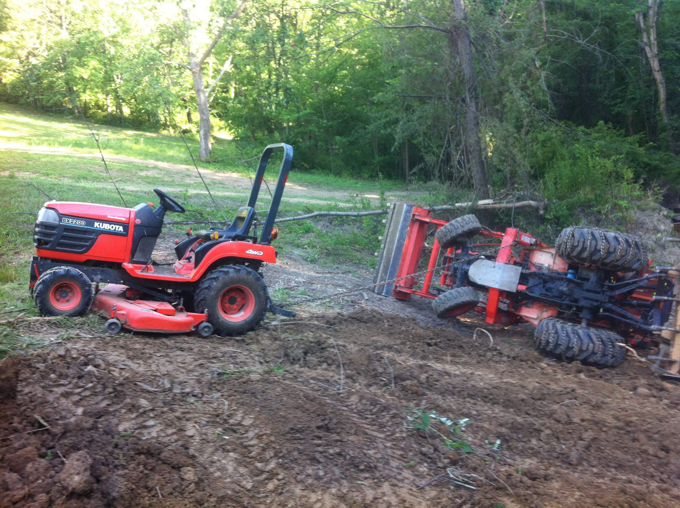

I thought the smaller tractor might pull the bigger one upright...but there was not enough traction...

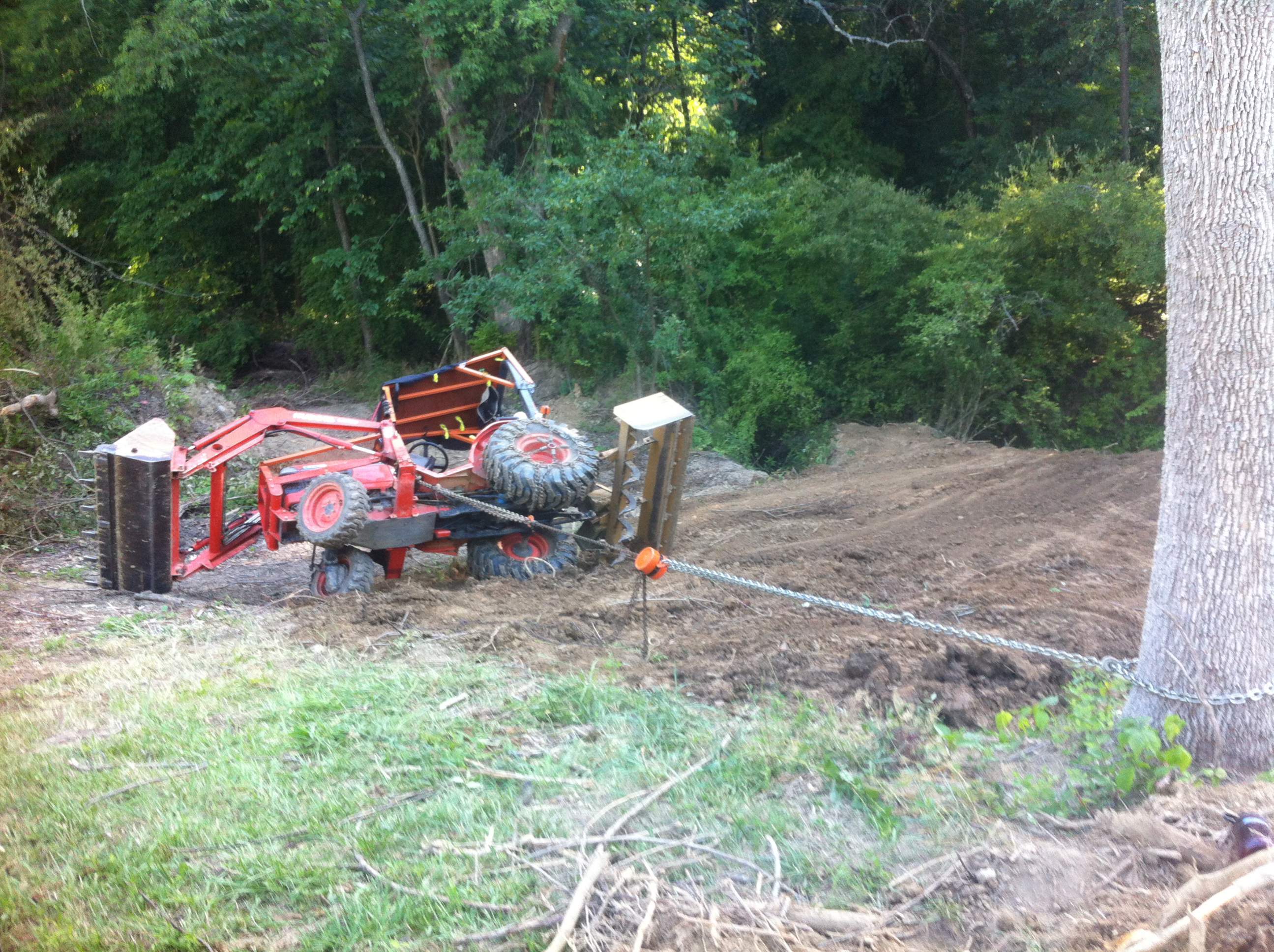

Fortunately there was a tree nearby....

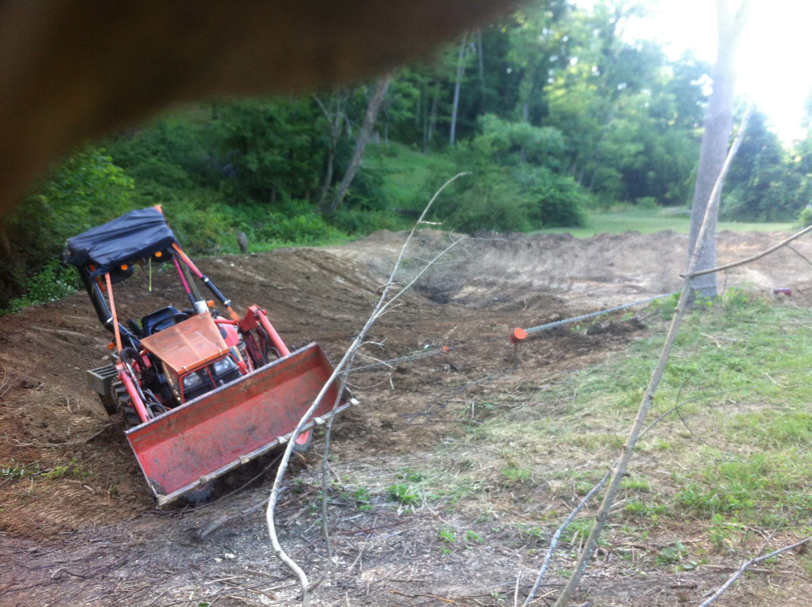

Tractor back on its wheels...

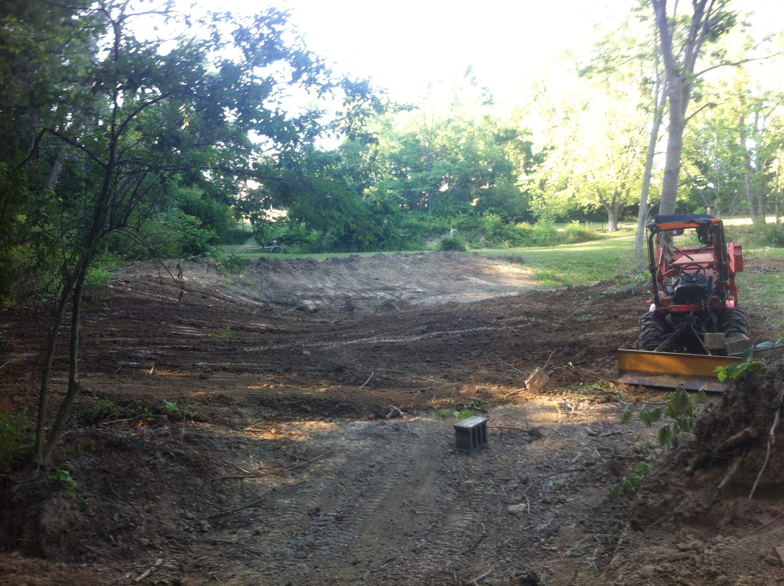

Overview of the area:

In your second picture, there is a cinder block (that was presumably being used for weight on the box blade) that is on the ROPS. A little further (a fast roll, instead of a slow roll) and it might have hit you in the head. I think I'd see about securing those things a little better, even if the tractor is supposed to stay upright!

Yes there was, I think, a couple (maybe 3) concrete blocks on the boxblade for extra weight, in addition to that small piece that is laying on the ground. The others stayed put on the boxblade, for whatever reason. In the case of this tip over, I was moving very slowly, maybe 2 or 3 MPH, so I think the chance of something being propelled forward was very small. Actually I was moving backwards...so whatever would fly would probably want to go in that direction rather than in the direction of the tractor.
But your point is well taken. Securing ballast to the boxblade is probably a very good idea. Even for hard heads like me (according to my wife, who am I do dispute that?)...:)
Edit: On second thought I don't think I was moving backwards... I was looking backwards...while moving forward...that is why I did not notice the drop off that I had made...:eek:
